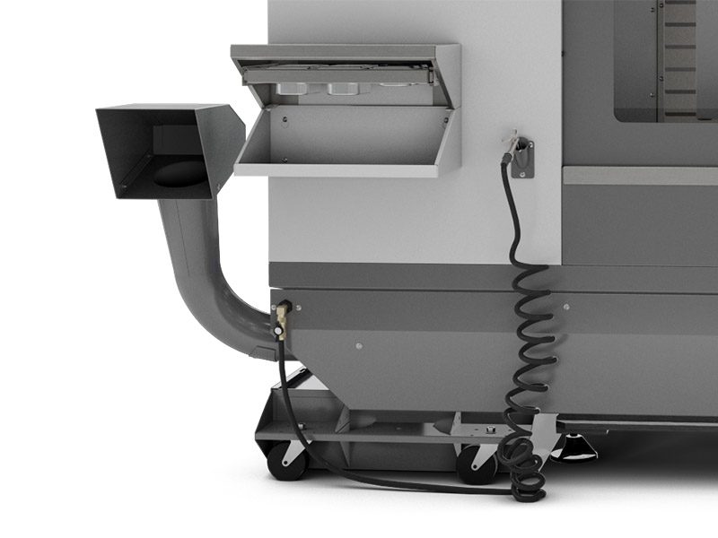

This front-facing auger-style chip conveyor automatically removes chips from the machine, while compressing them and wringing out the coolant. The front-facing chute discharges chips to the side of the machine.
The auger is ideal for both short runs and high-production environments, eliminating the downtime required for manual chip removal. It can be activated via M-code or directly from the control pendant, and there are settings to control the interval and duration of the auger cycle for automatic operation. Smart-sensing technology automatically reverses the auger if a jam occurs.
  • Discharges chips to the front of the machine
  • Compresses chips, saving space in the chip bin
  • Lift angle minimizes coolant carryout
  • Automatically reverses if a jam occurs
  • Activated via M-code, or from the control pendant
  • Energy efficient via control settings for automatic operation
