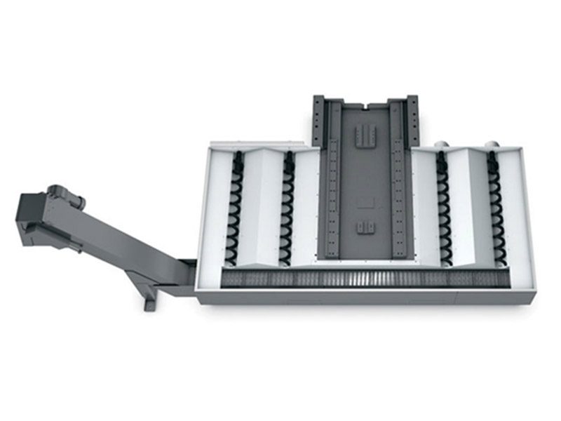

Quad-Auger System w/Conveyor
    CNY ONLY
Conveyor can discharge chips to either side
The Quad-Auger Chip Removal System with Conveyor removes chips from the machine quickly, with minimal coolant carryout. Four side augers transport the chips to the front of the pan, where they are collected by a heavy-duty steel, belt-type chip conveyor, and discharged at standard industrial barrel height.

Quad-Auger with Conveyor
Installs on the left or right side of the machine
Our quad-auger with conveyor option automatically removes chips from the machine, while discharging them at standard barrel height. Four side augers transport chips to the front of the pan, where they are collected by a belt-type chip conveyor and removed from the machine.
  • Installs on either side of the machine
  • Discharges chips at standard barrel height
  • Automatically reverses if a jam occurs
  • Activated via M-code, or from the control pendant
  • Settings control the interval and duration of operation
  • Automatic operation increases energy efficiency
