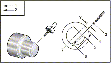

Service Home G242 Radial Spot Drill Canned Cycle (Group 09)
C - C-Axis absolute motion command
F - Feed Rate
P - The dwell time at the bottom of the hole
R - Position of the R plane (Diameter)
X - Position of bottom of hole (Diameter)
* Y - Y-axis motion command
* Z - Z-axis motion command
* indicates optional
This G code is modal. It remains active until it is canceled (G80) or another canned cycle is selected. Once activated, every motion of Y and/or Z executes this canned cycle.
NOTE
The P values are modal. This means if you are in the middle of a canned cycle and a G04 Pnn or an M97 Pnn is used the P value will be used for the dwell / subprogram as well as the canned cycle.
G242 Radial Spot Drill Canned Cycle: [1] Rapid, [2] Feed, [3] Starting point, [4] R plane, [5] Part surface, [6] Dwell at the bottom of the hole, [7] Centerline.
o62421 (G242 RADIAL SPOT DRILL) ;
(G54 X0 Y0 is at the center of rotation) ;
(Z0 is on the face of the part) ;
(T1 is a spot drill) ;
(BEGIN PREPARATION BLOCKS) ;
T101 (Select tool and offset 1) ;
G00 G18 G20 G40 G80 G99 (Safe startup) ;
G98 (Feed per min) ; G00 G54 X5. Y0.125 Z-1.3 (Rapid to 1st position) ;
P1500 M133 (Live tool CW at 1500 RPM) ;
M08 (Coolant on) ;
(BEGIN CUTTING BLOCKS) ;
G241 X2.1 Y0.125 Z-1.3 C35. R4. P0.5 F20. ;
(Drill to X2.1) ;
X1.85 Y-0.255 Z-0.865 C-75. P0.7 (next position) ;
(BEGIN COMPLETION BLOCKS) ;
G00 Z1. M09 (Rapid retract, coolant off) ;
M135 (Live tool off) ;
G53 X0 Y0 (X & Y Home) ;
G53 Z0 (Z Home) ;
M30 (End program) ;
