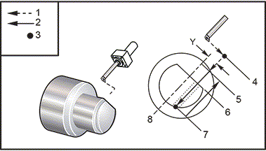

Service Home G245 Radial Boring Canned Cycle (Group 09)
C - C-Axis absolute motion command
F - Feed Rate
R - Position of the R plane (Diameter)
X - Position of bottom of hole (Diameter)
*Y - Y-axis absolute motion command
*Z - Z-axis absolute motion command
* indicates optionalG245 Radial Boring Canned Cycle: [1] Rapid, [2] Feed, [3] Start or end of stroke, [4] Starting point, [5] R plane, [6] Part surface, [Z] Bottom of the hole, [8] Centerline.
o62451 (G245 RADIAL BORING) ;
(G54 X0 Y0 is at the center of rotation) ;
(Z0 is on the face of the part) ;
(T1 is a boring tool) ;
(BEGIN PREPARATION BLOCKS) ;
T101 (Select tool and offset 1) ;
G00 G18 G20 G40 G80 G99 (Safe startup) ;
G98 (Feed per min) ;
G00 G54 X5. Y0.125 Z-1.3 (Rapid to 1st position) ;
P500 M133 (Live tool CW at 500 RPM) ;
M08 (Coolant on) ;
(BEGIN CUTTING BLOCKS) ;
G245 X2.1 Y0.125 Z-1.3 C35. R4. F20. ;
(Bore to X2.1) ;
X1.85 Y-0.255 Z-0.865 C-75. (next position) ;
(BEGIN COMPLETION BLOCKS) ;
G00 Z1. M09 (Rapid retract, coolant off) ;
M135 (live tool off) ;
G53 X0 Y0 (X & Y home) ;
G53 Z0 (Z home) ;
M30 (End program) ;
