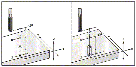

Service Home G84 Tapping Canned Cycle (Group 09)
* E - Chip-clean RPM (Spindle reverses to remove chips after each cycle)
F - Feedrate
* J - Retract Multiple (Example: J2 retracts twice as fast as the cutting speed, also refer to Setting 130)
* L - Number of holes if G91 (Incremental Mode) is used
* R - Position of the R plane (Position above the part)
* X - X-Axis location of hole
* Y - Y-Axis location of hole
Z - Position of the Z Axis at the bottom of hole
* Q - Peck Depth (always incremental)
* S - Spindle speed
* indicates optional
NOTE
You do not need to command a spindle start (M03 / M04) before G84. The canned cycle starts and stops the spindle as needed.
O60841 (G84 TAPPING CANNED CYCLE) ;
(G54 X0 Y0 is at the top-left of part) ;
(Z0 is on top of the part) ;
(T1 is a 3/8-16 tap) ;
(BEGIN PREPARATION BLOCKS) ;
T1 M06 (Select tool 1) ;
G00 G90 G40 G49 G54 (Safe startup) ;
G00 G54 X2. Y-2. (Rapid to 1st position) ;
G43 H01 Z0.1 (Activate tool offset 1) ;
M08 (Coolant on) ;
(BEGIN CUTTING BLOCKS) ;
G84 Z-0.600 R0.1 F56.25 S900 (Begin G84) ;
(900 rpm divided by 16 tpi = 56.25 ipm) ;
(Drill 1st hole at current X Y location) ;
X2. Y-4. (2nd hole) ;
X4. Y-4. (3rd hole) ;
X4. Y-2. (4th hole) ;
(BEGIN COMPLETION BLOCKS) ;
G00 Z1. M09 (Canned cycle off, rapid retract) ;
(Coolant off) ;
G53 G49 Z0 (Z home) ;
G53 Y0 (Y home) ;
M30 (End program) ;
