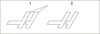

This setting changes the way a program is viewed in the Graphics mode. When it is OFF, rapid, non-cutting tool motions do not leave a path. When it is ON, rapid tool motions leave a dashed line on the screen.
Setting 4 -Graphics Rapid Path:[1] All Rapid Tool Motions Shown with a Dashed Line When ON. [2] Only Cut Lines Shown When OFF.
