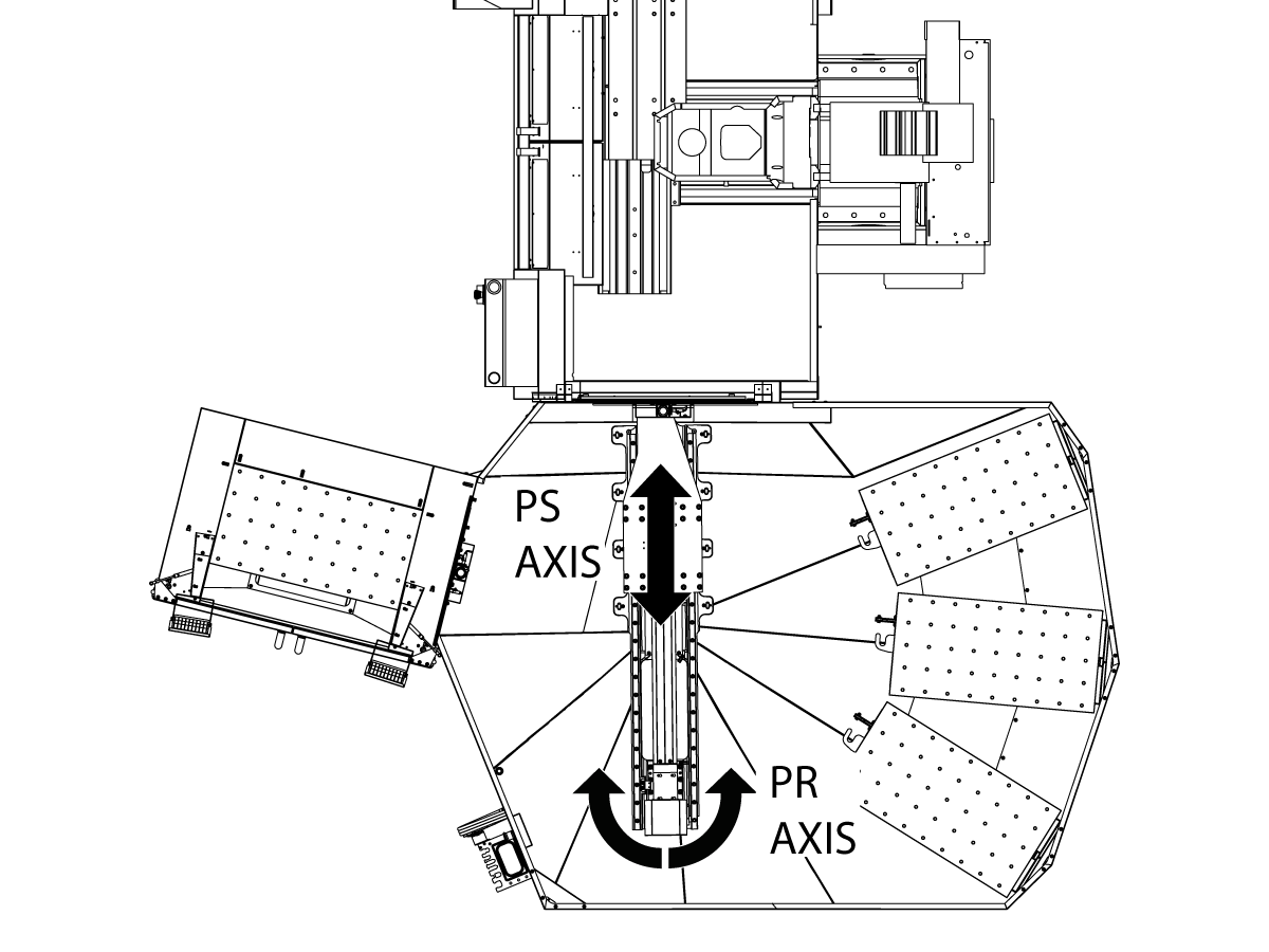

This operator’s manual supplement describes the unique features and functions of the Pallet Pool. Refer to your Mill Operator’s Manual for control operation, programming, and other general mill information.
Specific details about the Pallet Pool itself, including information that is beyond the scope of this document, can be found at www.HaasCNC.com.
The pallet pool system allows pallets to be prepared and then automatically loaded, one at a time, in the mill for machining.
As the pallets are called to be machined, a pallet arm positions each pallet in the Mill’s Pallet-Ready Position.Then mill puts the pallet in the machining area at the next pallet change.
Haas pallet-scheduling software stages pallets as the machine calls them. This means that high priority parts can be scheduled more often.
The pallet arm will return completed pallets to a protected operator loading station for the unloading and loading of parts.
Pallet Pool - Top View
  • PR - Axis is the Pallet Rotate Axis.
  • PS - Axis is the Pallet Slide Axis.
Pallet Pool - Overview
Pallet Pool
