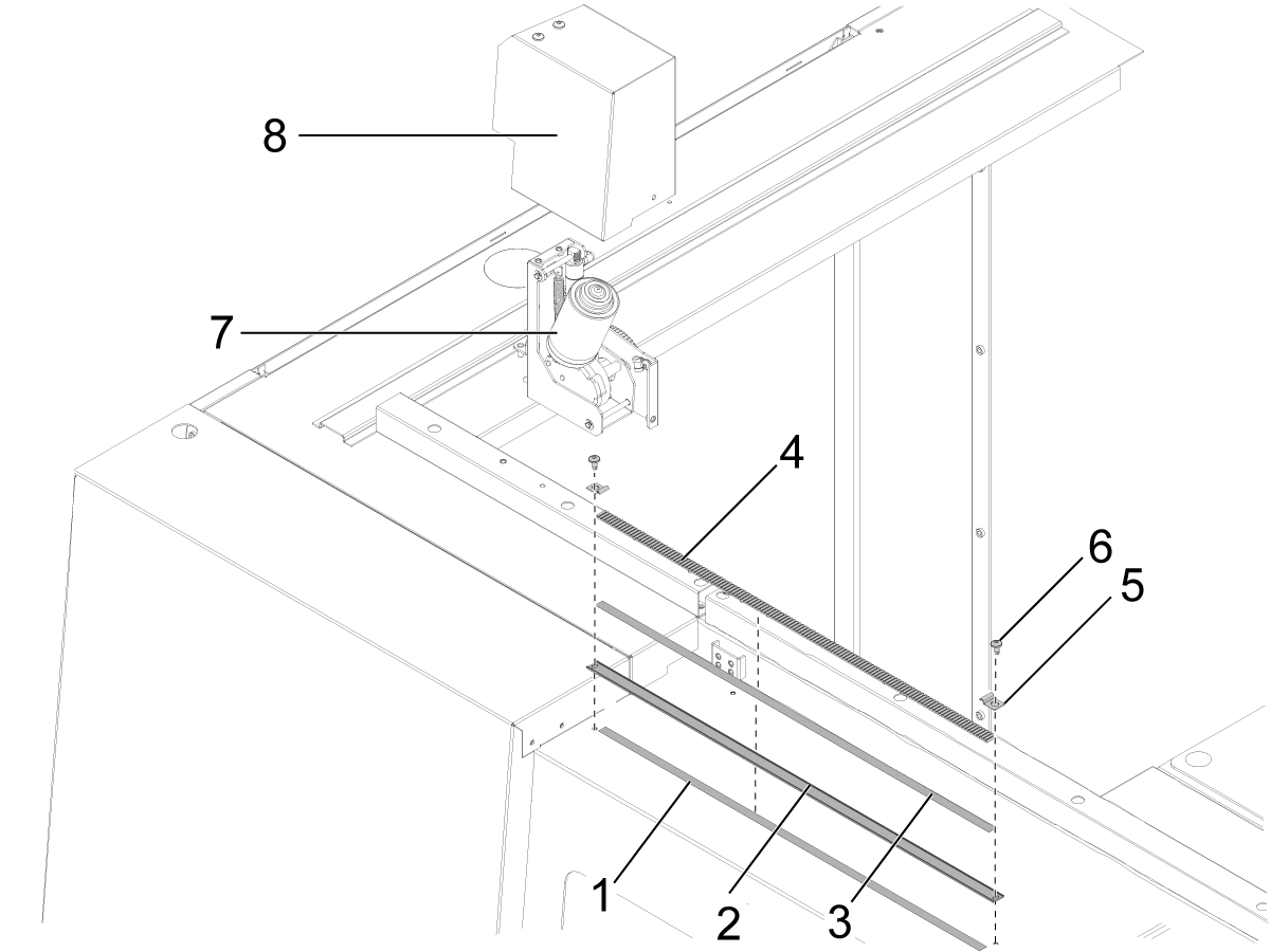

Remove the Autodoor motor cover [1].
Disconnect the airlines from motor assembly.
Remove the autodoor motor assembly [2].
Remove the adhesive track [3] from the top of the door.
VF Installation
VF Series:
Peel and stick the double sided tape [1] on top of the door.
Install the door track [2] on top of the double sided tape.
Peel and stick the double sided tape [3] and center it on the autodoor track.
Place the belt [4] on top of the double sided tape, and make sure the belt is centered on the track.
Install the retaining clip [5] and screw [6] on each side of the belt.
Note: The lip of the retaining clip goes over the first tooth of the belt.
Install the autodoor motor assembly [7].
Install the autodoor motor cover [8].

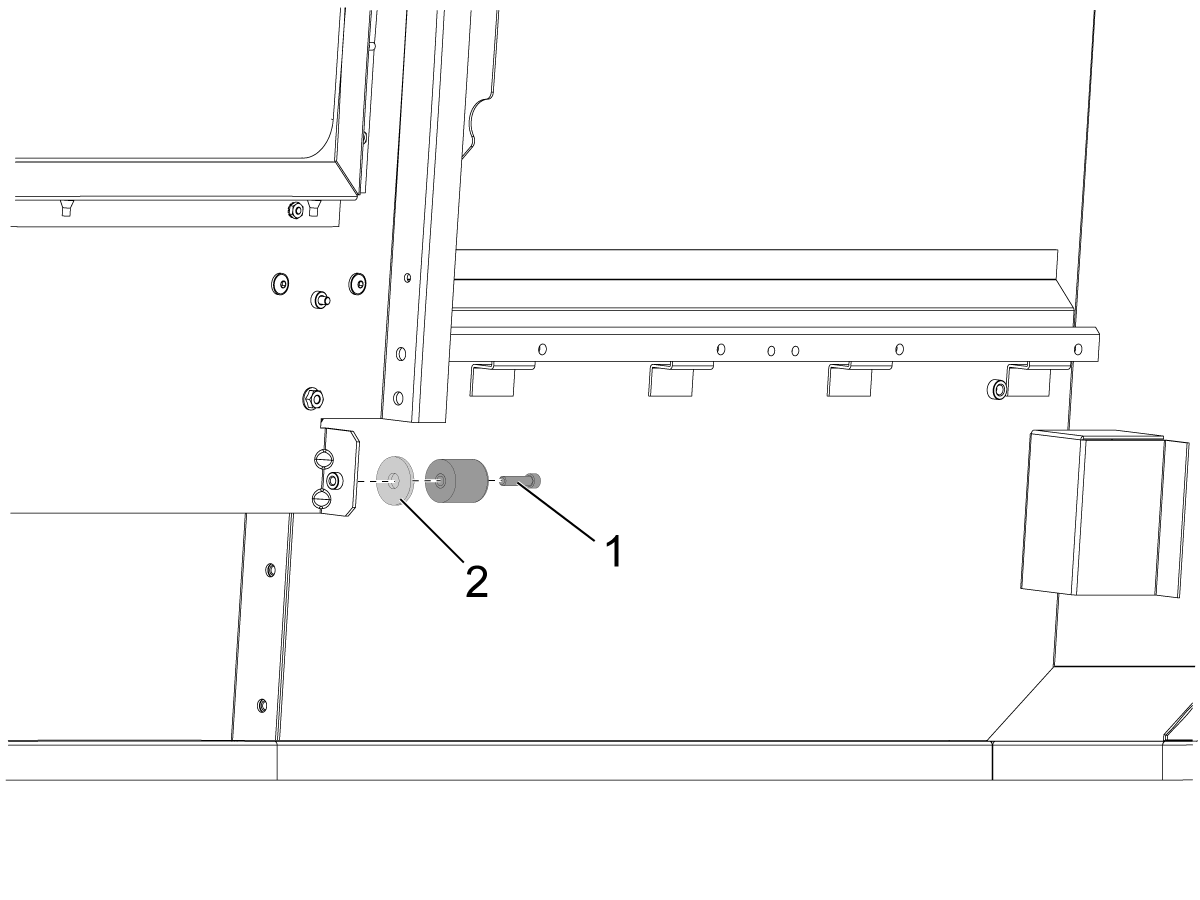

VF-Small
For VF-1 to VF-2 machines built prior to 9/16/2019 you will need to install a door bumper spacer [2]  P/N 20-5512  and a longer screw [1] P/N 40-1614 on the outer end of each door.
NOTE: The spacer [2] and the screw [1] are NOT included in the kits:

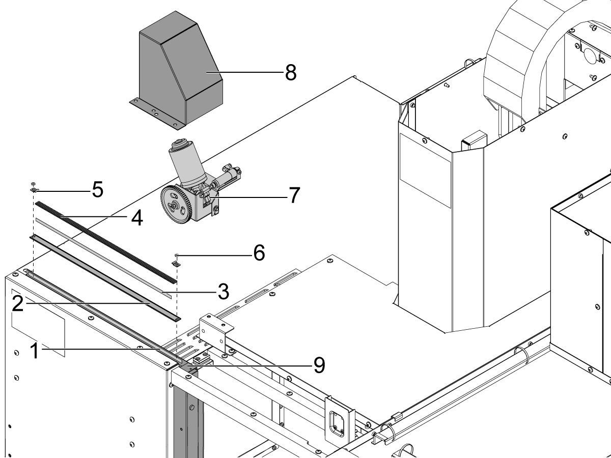

DT/DM Installation
Peel and stick the double sided tape [1] on top of the door [9].
Install the retaining clip [5] and nut [6] on each side of the belt.
