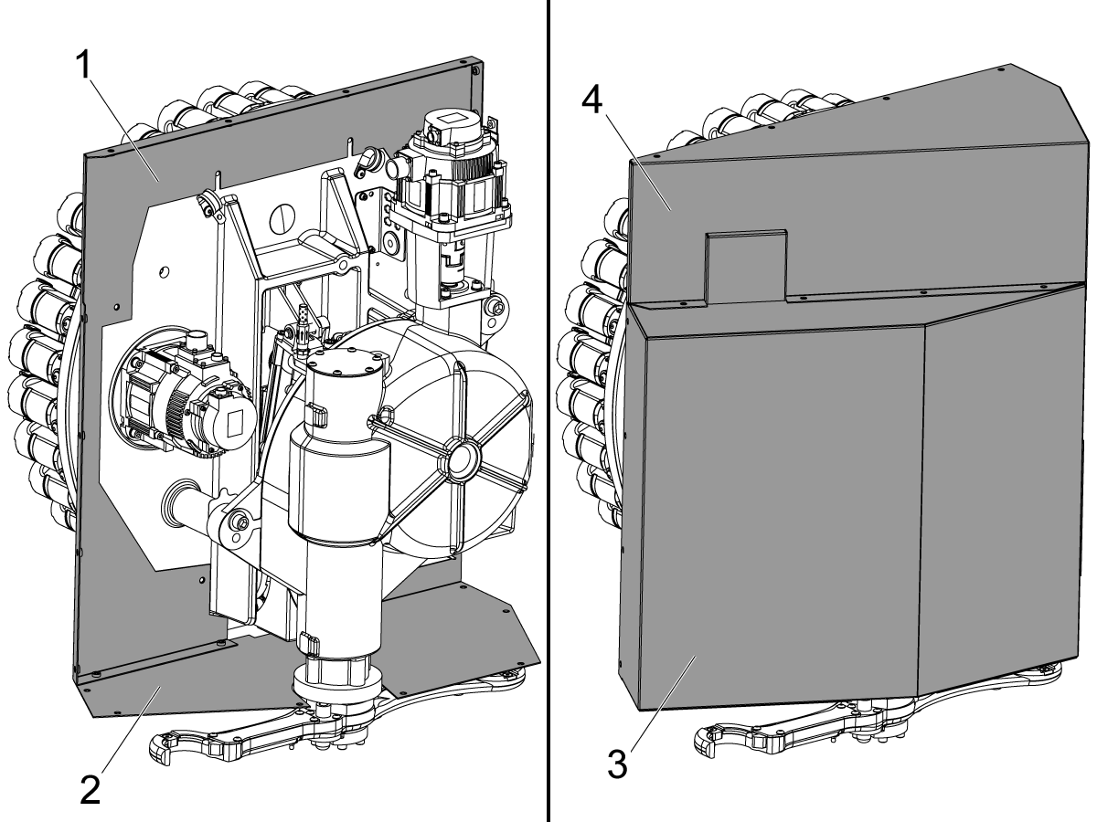

Install Tool Changer
Important: Use the proper lifting equipment as shown to support the tool changer and mount (approx. 450 lbs. / 204 kg).
Install a 1/2"-13 hoist ring with 1.25" thread length to the back of the tool changer casting.
Remove Tool Changer from shipping mount and install to the side of the bridge.
Connect the TT[1] and TA[2] servo motor power cables and encoder cables.
Connect the Pocket Up/Down air lines to the cylinder.
  • Pocket Up - Green hose - Top push-to-connect fitting.
  • Pocket Down - Red hose - Bottom push-to-connect fitting.
Route the Tool Changer axis lube line[3].
Connect the Tool Changer Pocket position proximity switches[1] to the Tool Changer bracket.
Remove the pockets [1] to access the Tool Changer lube line fitting.
Connect the Tool Changer axis lube line[2].
Reinstall the pockets[1].
Install the Tool Changer enclosure panels.

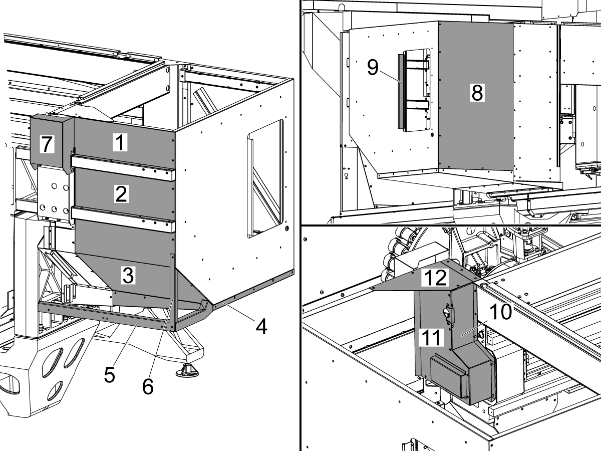

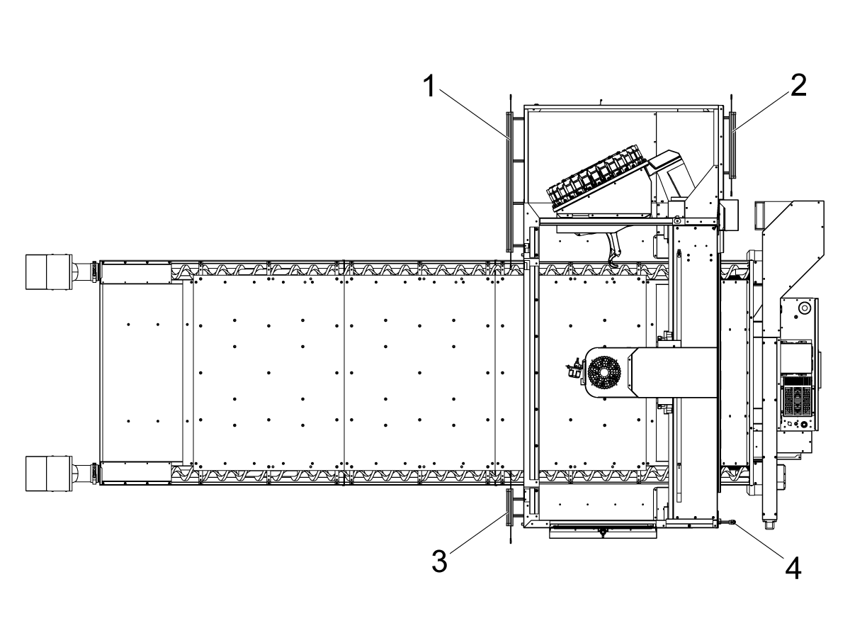

Install Enclosure Panels
Remove the hardware[1][2] securing tool changer enclosure in its shipping position.
Pull out the enclosure[3] and reinstall the hardware in the extended position.
Install TC enclosure panels.
Install chip auger chutes[1]. Refer to the Chip Auger - Installation steps 5 and 6.
Install the coolant splash guards.

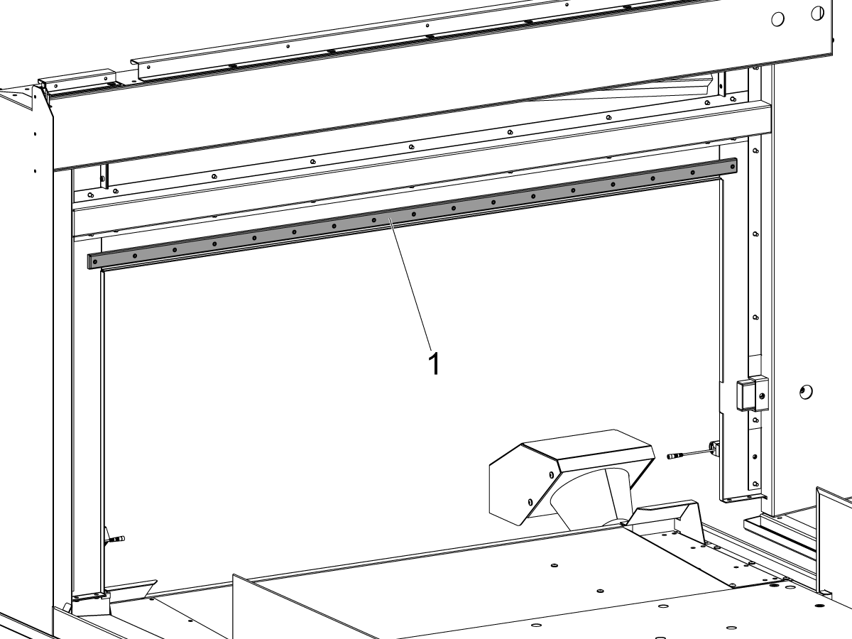

Install Safety Sensors
Install the safety sensors on the TC enclosure.
[1]  Front left safety sensor is 38" long.
[2]  Rear left safety sensor is 18" long.

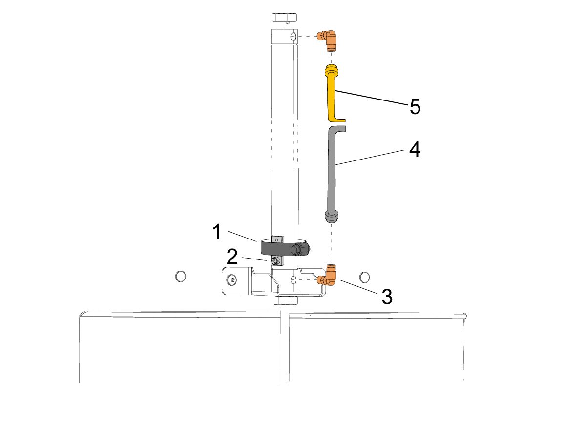

Install Operator Window
Install the window[1].
Insert the grommet[2] to the top bracket. Bolt both brackets[3] to the enclosure above the window.
Remove bottom nut[4] on the cylinder to slide it through both brackets. Install the bottom nut[4] to secure to the cylinder to the window.
Insert bottom of cylinder shaft through the window bracket's hole and secure with jam nuts[5].
Assembled Operator Window Assembly.
Loosen the sensor clamp[1] until the opening is wide enough to fit around the cylinder. Place the clamp around the bottom of the cylinder.
Insert the sensor[2] in between clamp and cylinder. Tighten the sensor clamp[1].
Attach two hose fittings[3] to the bottom and top of the cylinder.
Connect the gray airline[4] to the bottom hose fitting on the cylinder and connect the yellow airline[4] to the top hose fitting on the cylinder.
Push [EMERGENCY STOP].
Close the Operator Window.
Do these steps to adjust the sensor indicating when the Auto Window is closed. Monitor the DIAGNOSTICS > I/O tab at the same time:
  1. Loosen the sensor clamp. Move the sensor and clamp until Input 67 LEFT_DOOR_OPEN changes from 1 to 0.
  2. Slowly move the sensor and clamp up. Find the location where the value is as near as possible to 0, but the value is 1. Put a mark on the cylinder above the switch to locate the sensor's height at this position.
  3. Move the sensor and clamp down. Find the location where the value is as near as possible to 0, but the value is 1. Put a mark on the cylinder below the switch to locate the sensor's height at this position.
  4. Move the sensor and clamp to the middle point between the two marks. Input 67 LEFT_DOOR_OPEN should be a 0 at this position.
  5. Tighten the clamp.
 Important: Move any wires and hoses around to prevent any kinks or rubbing before the enclosure cover is put on.
Secure both airlines and sensor cable to the cylinder with zip ties.
Install the cover[1] to the machine's enclosure above the window.
Connect and route both sensor wires and airlines[2] through the cover.

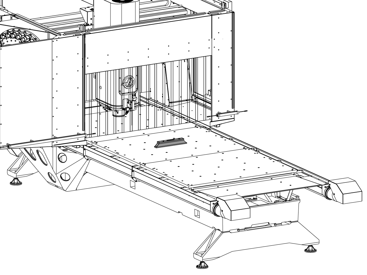

Rough Level
Before first power on, rough level the machine.
IMPORTANT : For machines with long ballscrews it is important to rough level before a first power on, as not doing so might cause the machine to alarm out during the X-axis during the zero return process.
  • Adjust the leveling screws to raise the machine 3" (H) from the floor.
Use a machinist level to rough level the machine. Place the level on the center of the table parallel to the Y-Axis. Adjust the leveling screws to level the table.
Use a machinist level to rough level the machine. Place the level on the center of the table parallel to the X-Axis. Adjust the leveling screws to level the table.
