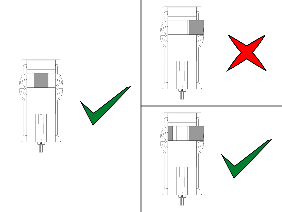

Using a wrench, rotate clockwise to clamp and counter-clockwise to unclamp the vise.
Note: Only use the supplied vise handle for clamping your part. Using a longer wrench will create too much clamp force and will cause premature wear or damage to the ways and lead screw of the vise.
Center the part in the vise jaws. Do not clamp on one side of the vise without a similar sized spacer to evenly clamp the part.

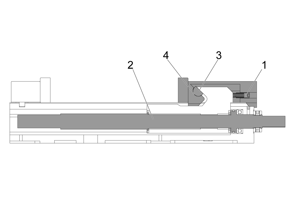

Monthly Maintenance
Remove the chip guard
Remove the movable jaw by opening the vise all the way and loosen the set screw[1] so it sticks out 0.25".
Lift up on the movable jaw and keep track of the half ball bearing[3].
Clean all chips trapped under the movable jaw and clean the screw.
Apply a thin coating of rust preventative to the screw[2] and machined surfaces.
Apply (Mobil XHP 322) grease to the spherical section[4] of the movable vise and install the half ball bearing.
Install the movable jaw and tighten the set screw all the way, then back off a 1/8-1/4 turn.
