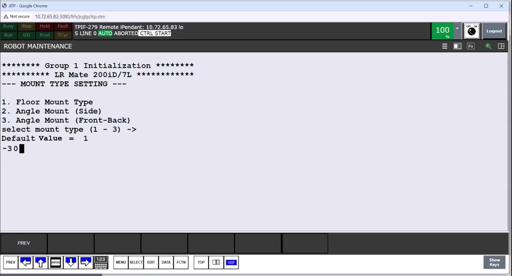

2. Select MENU and then select 9 MAINTENANCE.
3. Select MANUAL.
4. Enter 1 and press ENTER.
Important: This step is for Fanuc Robots that are new or have the newest Fanuc software only.
1. Enter the Mount Angle that the robot is mounted and press ENTER.
  • For VF/VM and ST machines the Mount Angle Setting is -30.
  • For UMC and DT/DM machines the Mount Angle Setting is 0.
Note:
If this is a new Funuc Robot or has the newest Fanuc software, Mount Angle has already been applied in the previous step.
2. Enter 7 for the Payload setting and press ENTER.
3. Enter 1 for the J1 MOTION RANGE SETTING and press ENTER.
4. Enter 1 for Built-in batteries and press ENTER.
