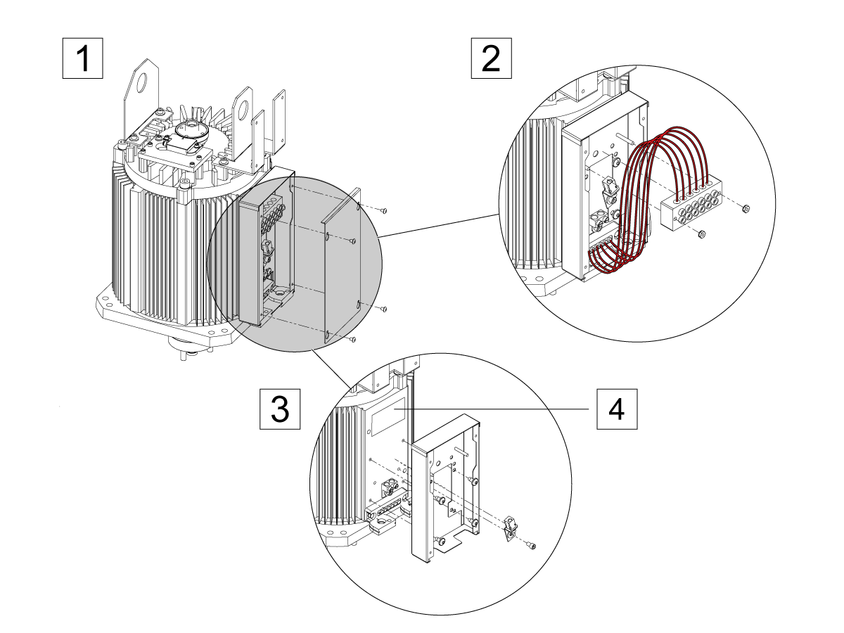

Remove JBOX - VF/VM
 NOTE: If it is necessary to remove (or partially disassemble) spindle motor assembly to access JBOX, refer to 40T Pin Drive Motor- Replacement for more information.
Unbolt cover on JBOX [1]
Remove nuts securing terminal block and lift off of threads. [2]
Remove screw on the bronze bracket holding the thermal probe wire.
Remove screws securing JBOX to spindle motor. [3]
Lift JBOX and locate spindle motor label. [4]

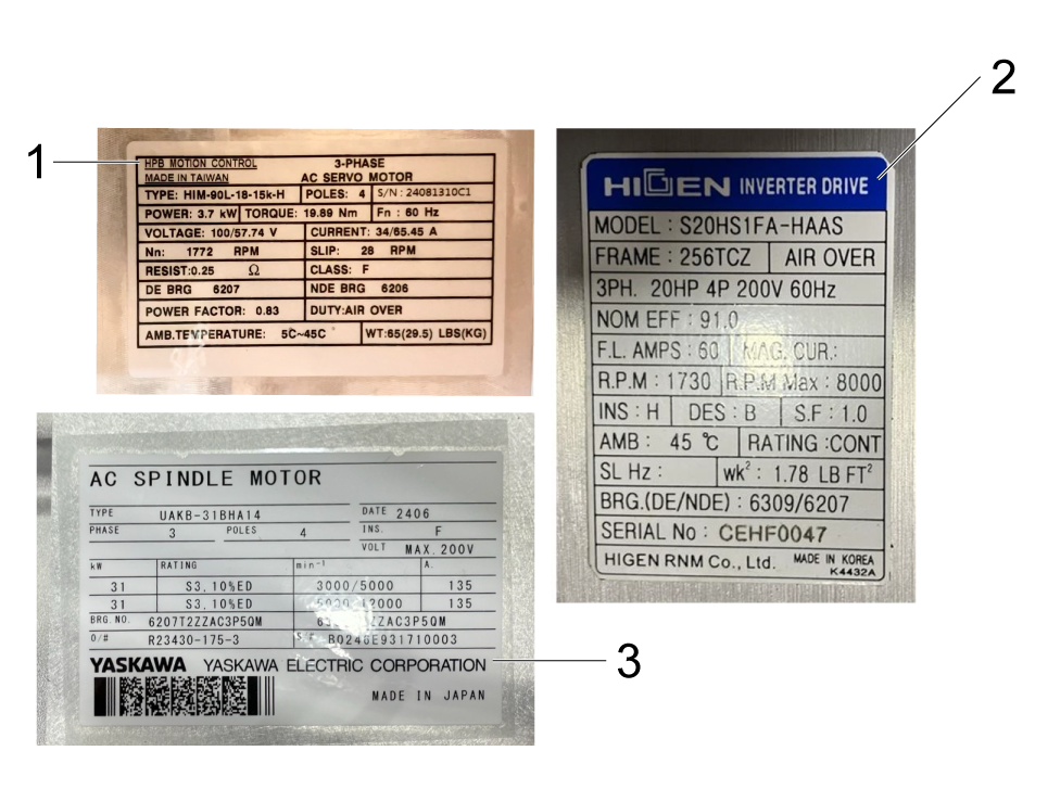

Identification
Identify motor brand name at the top or bottom of spindle motor label:
  1. HPB
  2. HiGen
  3. Yaskawa
When identification is complete, reinstall JBOX and spindle motor.
