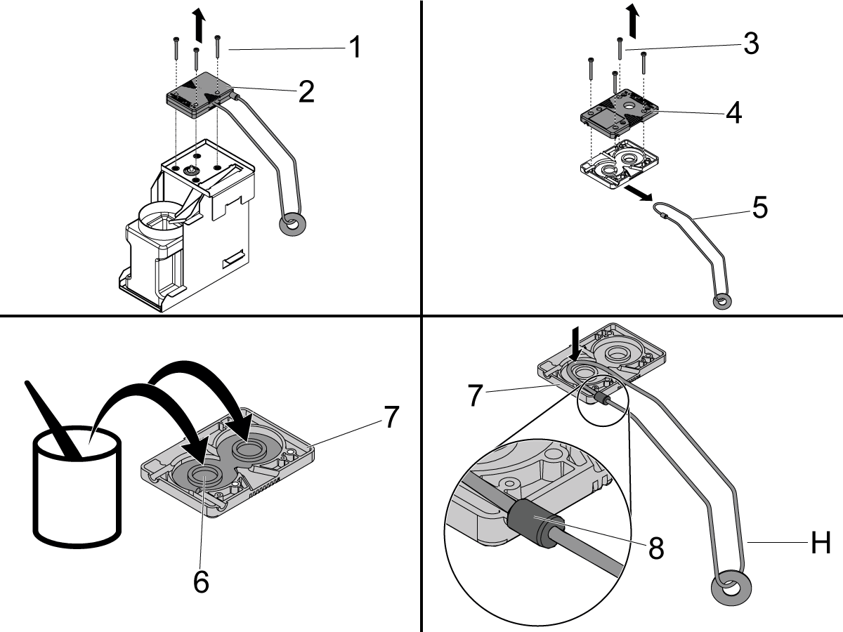

Unplug the Oil Skimmer power cable and remove the Oil Skimmer from the coolant tank.
Remove the (3) screws [1] and the cartridge [2] from the oil-skimmer assembly.
Turn the cartridge to the other side. Remove the (4) screws [3] and the bottom cover [4] of the cartridge.
Remove the tubing [5] and gears for the Oil Skimmer.
Add grease [6] to the top cover [7] of the cartridge.
Put the tubing on the top cover as shown with the replacement gears.
 Note: Make sure the ceramic scraper [8] is installed in the correct position on the top cover.
Install the bottom cover [4]. Use the (4) screws [3].
Align the motor shaft [2] to the drive-wheel hole [1]. The hole is on the bottom cover of the cartridge.
Attach the cartridge [4] to the Oil Skimmer. Use the (3) screws [3].
Install the Oil Skimmer.
Put the long tab on the Oil Skimmer into the slot on the cover for the coolant tank.
Connect the power cable for the Oil Skimmer.
Push the toggle switch to turn the Oil Skimmer on.
Make sure the tubing moves freely.
The Oil Skimmer operates correctly when the oil is scraped off of the tubing and drips into the container.
