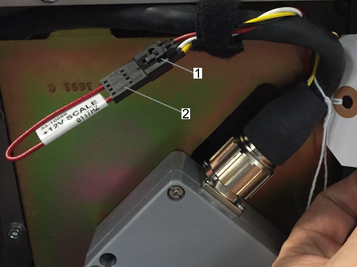

Any trunnion can be made compatible with a 12VDC machine by installing the 32-10055 rotary cable. the 32-10055 cable can be identified by the grey connector [1] on the scale cable.
Do this step if the trunnion has a 12VDC scale installed.
The 32-10055 cable has a flying connector [1] inside of the rotary enclosure. Plug the 33-10088 jumper [2] to the flying connector as shown.

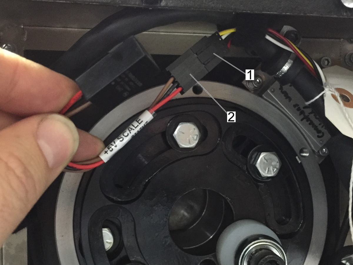

Do this step if the trunnion has a 5VDC scale installed.
The 32-10055 able has a flying connector [1] inside of the rotary enclosure. Plug in the 32-10057 voltage reducer [2] to the flying connector as shown. The trunnion can now be plugged into any 12VDC configured machine.
