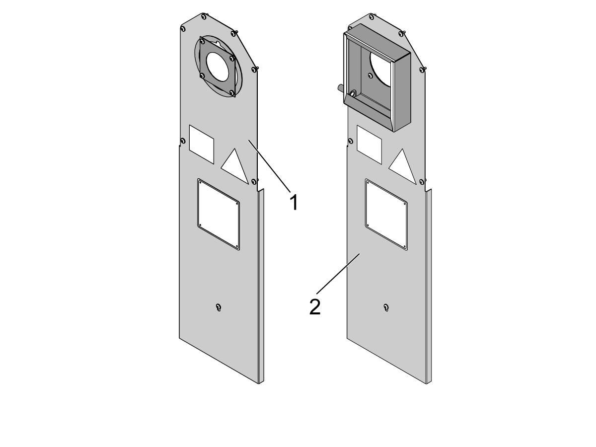

PN: 93-3948 applies to A2-5 TL machines built from 2017 and later. PN: 93-3940 applies to A2-6 TL machines built from 2019 and later.
TL - Spindle Cover Replacement - AD0730
- Jump to Section - 1. Introduction 2. Replacement (2 steps) Back to Top
This procedure shows how to replace the Spindle Cover on a TL-1/2
This procedure applies to the following service kits:
     93-3948[1]: SPINDLE COVER A2-5 SVC KIT TL-1/2
     93-3940[2]: SPINDLE COVER A2-6 SVC KIT TL-1/2
These kits will help keep chips out of the spindle area and prevent contamination of the spindle and encoder system.

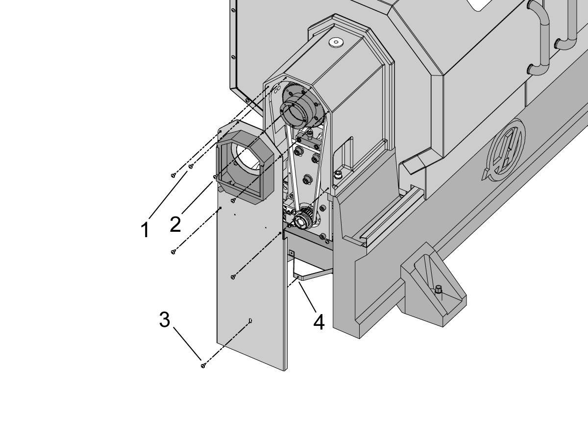

Remove the spindle cover [1] from the spindle casting and the spindle motor bracket.  Clean the spindle area before installing the new cover.
To install the new spindle cover:
  1. Fasten the spindle cover to the spindle housing starting with the top 2 screws [1] and [2]. Before fully tightening the screws, verify that the remaining screw threads are accessible and that the cover is flush to the spindle housing.
  2. Once the cover is aligned with the rest of the threads, fasten the remaining screws to the spindle housing.
  3. Make sure that the bottom screw [3] is fastened to the mounting bracket [4] located beneath the spindle assembly.
Note: The image on the left is the A2-6 kit but this step is the same for the A2-5 kit.
