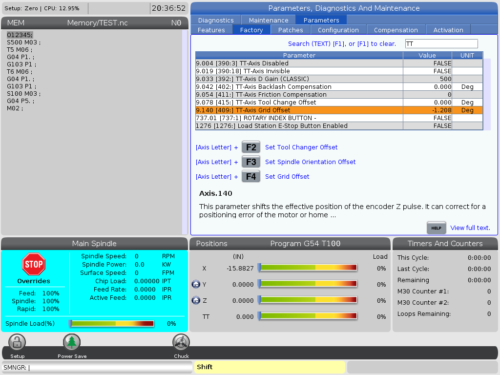

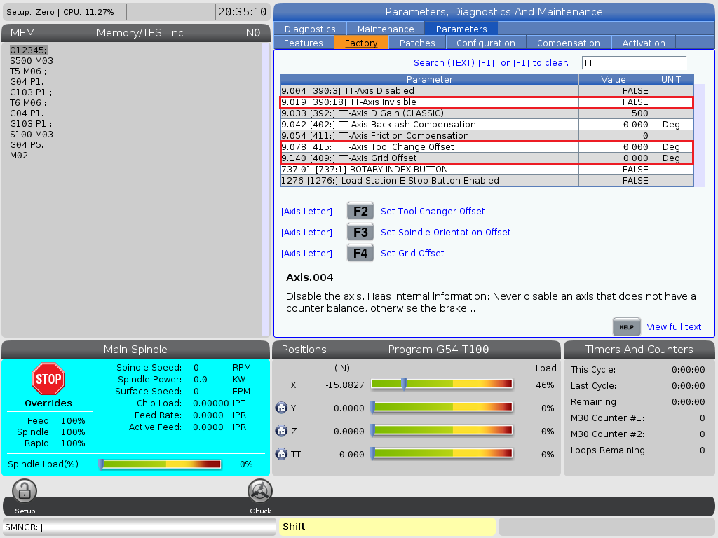

With the machine in service mode, make the TT axis visible and Zero out the Grid and Tool Change Offsets by setting the following Parameters:
P 9.019 TT-Axis Invisible to False.
P 9.140 TT-Grid Offset to 0.
P 9.078 TT-Axis Tool Change Offset to 0.
Cycle the machine power.
Power on and Zero return all the axis.

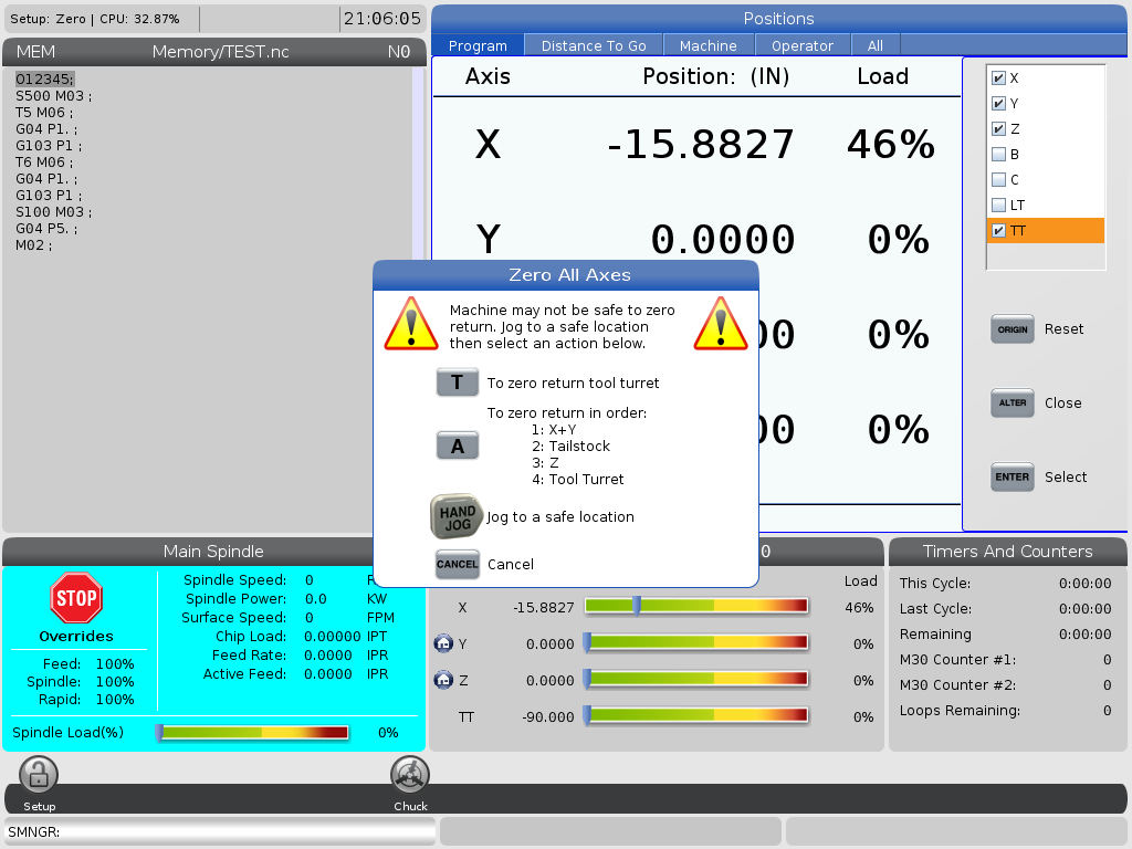

Make the TT-axis visible on the position pages by Pressing: [Position], [Alter] and selecting the TT axis.
Zero Return the TT axis. Ignore any alarms
Set the Grid Offset by Typing TT and Pressing [F4]

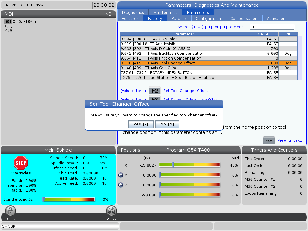

In MDI mode, Press [Turret FWD] or [Turret REV] to position the turret on Tool Pocket #1
Push the [E-STOP] Button when the turret is in the correct position (this relaxes the servo and allows the coupler to clamp completely)
Set the TT Tool Change Offset by typing TT and pressing [F2]
