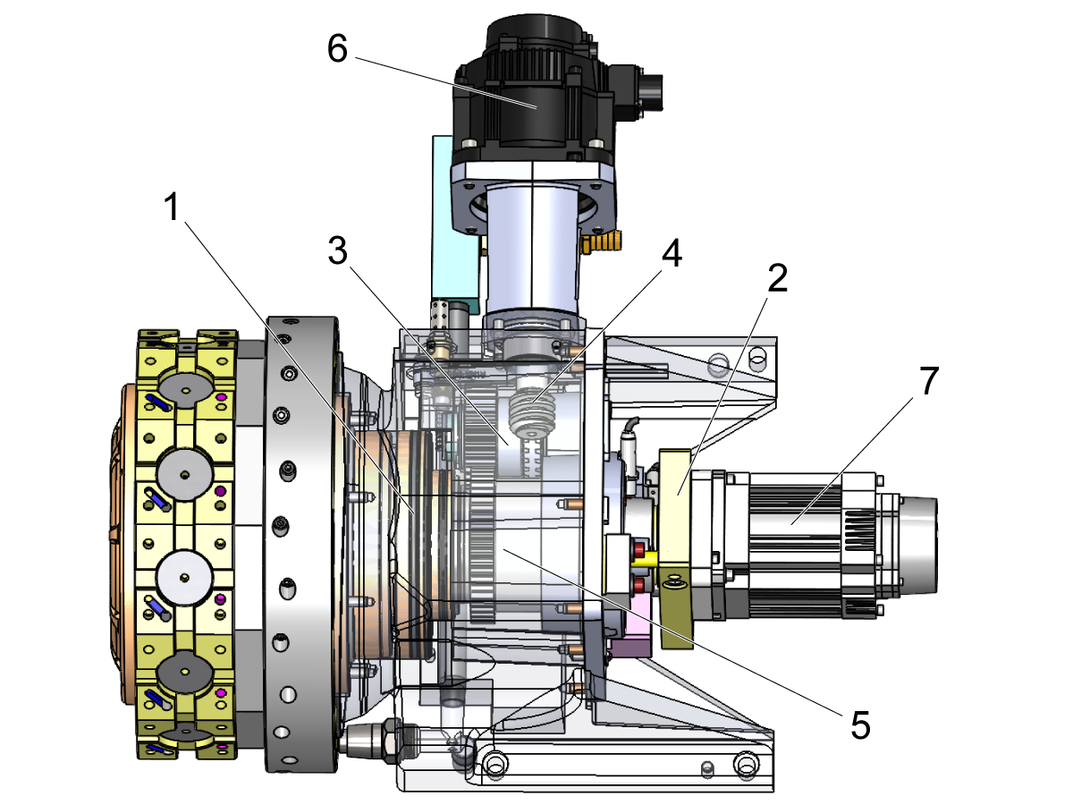

  1. Quad-Ring
  2. Torque arm
  3. Cluster Gear
  4. Worm Shaft
  5. Spur Gear
  6. Turret Motor
  7. Servo Motor

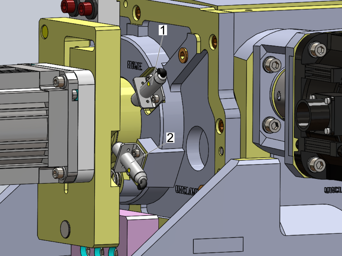

  1. Home Switch
  2. Clamp/Unclamp Switch

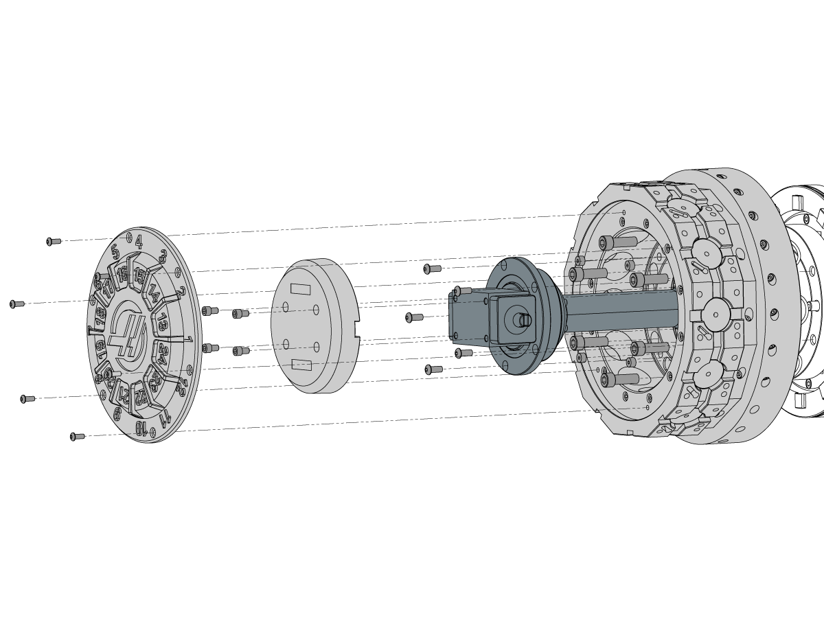

Alarm 114 TURRET FAILURE TO REACH CLAMP SWITCH
The incoming air flow is incorrect. Check the incoming air supply.
There is a problem with the voltage to the turret clamp/unclamp solenoid. Check the voltage to the turret clamp or unclamp solenoid.
The turret clamp/unclamp proximity sensor is faulty. Check the turret clamp/unclamp proximity sensor.
The turret did not pop out far enough. Check the piston, internal gears and spring assembly for damage.
Alarm 8125 TOOL TURRET NOT SEATED Obstruction between tool turret and housing.
Clear obstruction such as chips.
If the turret is not virtually clamping correctly and the backlash is () then inspect the 2 wave washers located on the tool changer side of the worm shaft.
Alarm 2022 TURRET FAILED TO LEAVE CLAMP SWITCH
Important : Do no disassemble the tool changer unless advised to do so by Haas Service
Tool turret attempted to unclamp but failed to leave the clamp switch because air is bypassing the turret piston quad-ring. Refer to 06/13/2024 Service Notification - Alarm 2022 ST-10/15 Turret Replacement Service kit
The Turret Tool Changer Alignment is not set correctly.
The turret did not unclamp enough.
High torque loads during tool change Interference between the housing and turret. See High Loads during tool change section below.

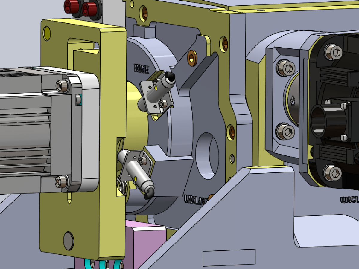

Clamp/Unclamp Proximity Sensor

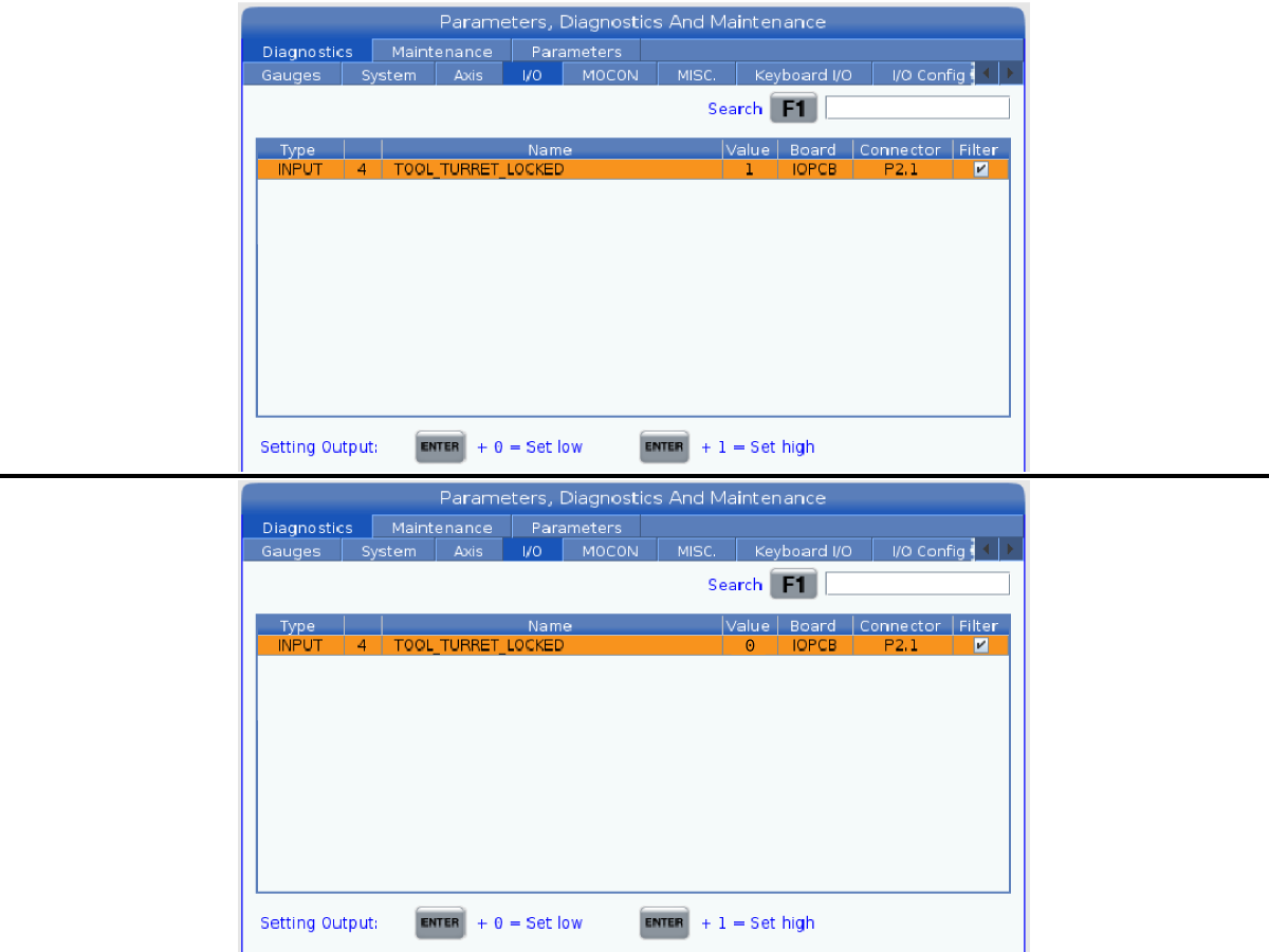

Navigate to the Diagnostic screen on the pendant. Go to the I/O tab. Use an M43 (Unclamp) M44 (Clamp) code in MDI mode to troubleshoot the clamp/unclamp switch.
Check that Input 4 Tool Turret Locked changes states when the turret is commanded to unclamp/clamp.
Test the sensor by placing a screwdriver in front of the sensor. Make sure the inputs change states.
If the input does not change, jump the cable connector on the turret connector bracket. If the input changes, replace the sensor.

If you commanded an M43 (Unclamp) and the turret moved, but did not move far enough to clear the coupler, measure the distance the turret traveled.
Set indicator to zero when turret unclamped M43. Command the turret to clamp M44. The indicator should measure 0.160" - 0.250".
Note : If the turret does not travel far enough, the piston shaft, gears, or spring assembly could be at fault. Contact Haas Service for more information.
Important : Do not remove the indexer turret (disk) to check the unclamp distance.

Index the turret to tool number 1.
Turn off the main air supply to the machine.

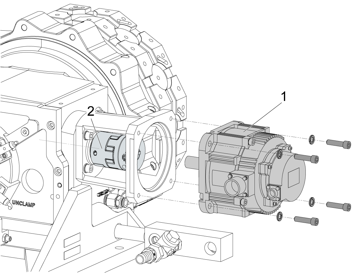

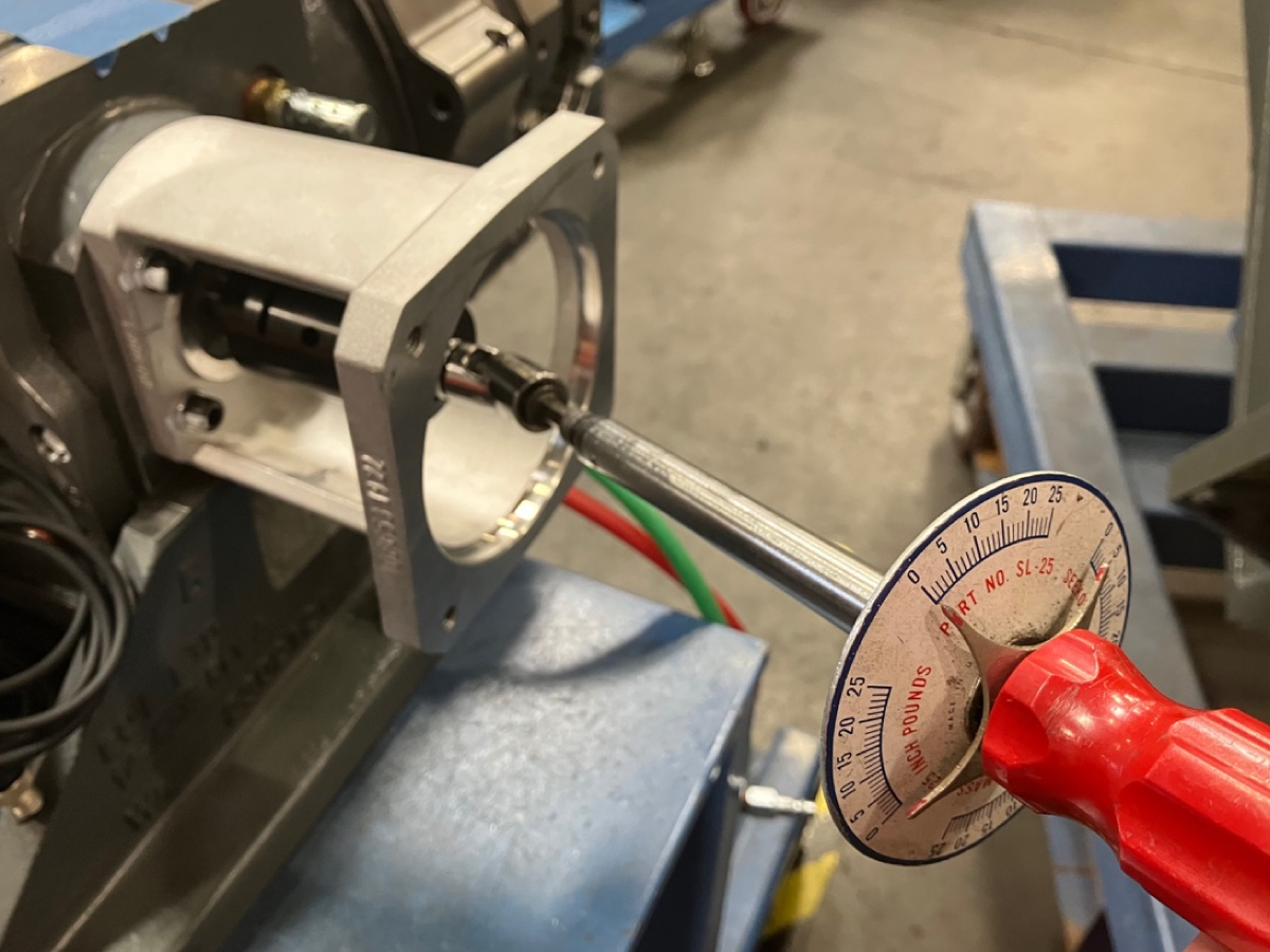

Remove the TT-Axis motor [1] to check the torque required to rotate the turret when unclamped.
Use a inch-pounds torque screwdriver attached to the coupler.
It should read between 15-20 in-lbs. If the torque is high, use the following steps to check the main turret shaft.
Remove the Turret and live drive and check the torque required to rotate the shaft.
If the torque is low with the turret removed. Reinstall the live drive and turret. Refer to the BMT45 Turret - Live Tool Drive - Alignment procedure to reset the live drive alignment.
If the torque is high with the turret removed, contact Haas Service.
