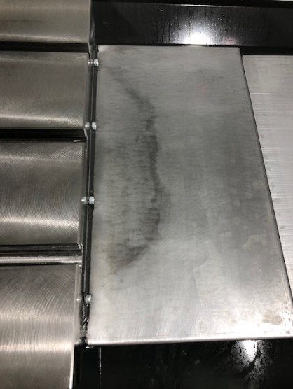

In early 2019 Haas began converting way covers from cold rolled steel to galvannealed steel. Galvannealing is a common industrial process that makes an unpainted panel far more resistant to corrosion than a bare mild steel panel. However, certain machine coolants contain additives that react with the zinc, creating zinc oxide that appears as a dark stain. These galvannealed waycovers have proven to be far more reliable in service because they don’t rust like mild steel waycovers do. The dark staining is only cosmetic and is not a failure of the way cover, nor is it a reason to replace the waycover.
