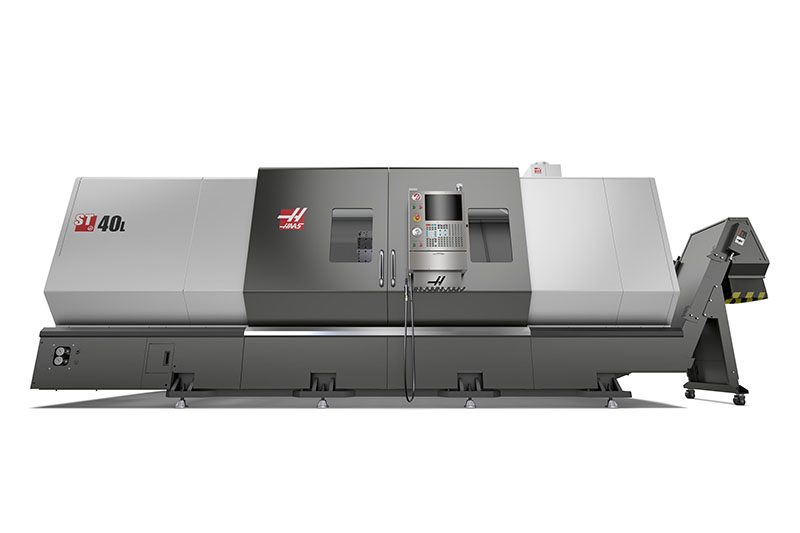

CNC Lathe with 30" x 80" max capacity and 4.0" bar capacity
The Haas ST Series high-performance turning centers were designed from the ground up to provide setup flexibility, extreme rigidity, and high thermal stability.
The ST-40L is a large-frame, long-bed lathe with a generous work envelope. This machine offers the best performance for the money – the best value – in its class.
