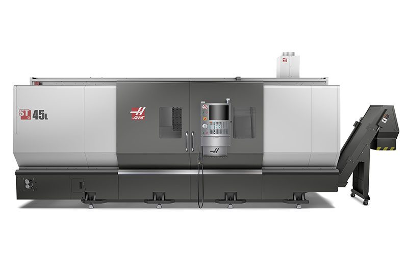

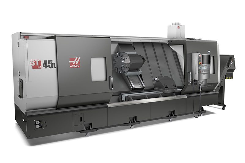

CNC Lathe with 30" x 80" max capacity and 7.0" bore
The Haas ST Series high-performance turning centers were designed from the ground up to provide setup flexibility, extreme rigidity, and high thermal stability.  The ST-45L is a long-bed, big-bore lathe with a generous work envelope. This machine offers the best performance for the money – the best value – in its class.
  • Extra-long work envelope
  • Fully programmable servo tailstock

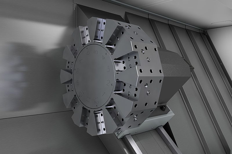

  • 12-station bolt-on turret
  • A2-11 spindle nose with 7.0" (178 mm) bore
NOTE: This machine does not include a hydraulic power unit (HPU). To get the HPU, you must order the 18" Hydraulic Chuck Kit, live tooling w/C-axis, or the Steady Rest Provision.

Capacities S.A.E METRIC
Chuck (optional) 18.0 in 457 mm
Max Part Swing 35.5 in 902 mm
Max Cutting Diameter (with BOT turret) 30.00 in 762 mm
Max Cutting Diameter (with BMT75 turret) 27.50 in 699 mm
Max Cutting Length (varies with workholding) 80.0 in 2032 mm
Bar Capacity w/ Opt. Workholding 6.50 in 165 mm
Travels S.A.E METRIC
X Axis 20.00 in 508 mm
Z Axis 80.00 in 2032 mm
Feedrates S.A.E METRIC
Rapids on X 710 ipm 18.0 m/min
Rapids on Z 320 ipm 8.1 m/min
Axis Motors S.A.E METRIC
Max Thrust X 5500 lbf 24465 N
Max Thrust Z 9000 lbf 40034 N
Spindle S.A.E METRIC
Spindle Nose A2-11 A2-11
Max Rating 40.0 hp 29.8 kW
Max Speed 1400 rpm 1400 rpm
Max Torque 1400.0 ft-lbf @ 150 rpm 1898.0 Nm @ 150 rpm
Spindle Bore ø 7.00 in 178.0 mm
XP Option S.A.E METRIC
Drive System 2-Speed Gearbox 2-Speed Gearbox
Max Rating 55.0 hp 41.0 kW
Max Torque 2100.0 ft-lbf @ 150 rpm 2847.0 Nm @ 150 rpm
Full Load Amps (3 Phase) - Low 105 A 105 A
Full Load Amps (3 Phase) - High* 53 A 53 A
PC18KIT S.A.E METRIC
Chuck Size 18.0 in 18.0 in
Draw Tube Bore ø 6.50 in 165 mm
Tailstock S.A.E METRIC
Taper MT5 MT5
Travel 84.5 in 2,146 mm
Max Thrust (Acme) 3,000 lbf 3,345 N
Min Thrust (Acme) 200 lbf 890 N
Turret S.A.E METRIC
Number of Tools 12-Station BOT 12-Station BOT
OD vs ID Tools Any Combination (will vary with turret) Any Combination (will vary with turret)
Boring Bar Rear Clearance (from back of turret ) 4.37 in 111.0 mm
General S.A.E METRIC
Coolant Capacity 95 gal 360 L
Air Requirements S.A.E METRIC
Inline Air Hose 3/8 in 3/8 in
Coupler (Air) 3/8 in 3/8 in
Spindle Speed 1400 rpm 1400 rpm
Spindle Power 40.0 hp 29.8 kW
Full Load Amps (3 Phase) - Low 70 A 70 A
Domestic Pallet 254.0 in x 95.0 in x 105.0 in 646 cm x 242 cm x 267 cm
Export Crate 254.0 in x 96.0 in x 120.5 in 645 cm x 244 cm x 306 cm
Weight 29900 lb 13563.0 kg
