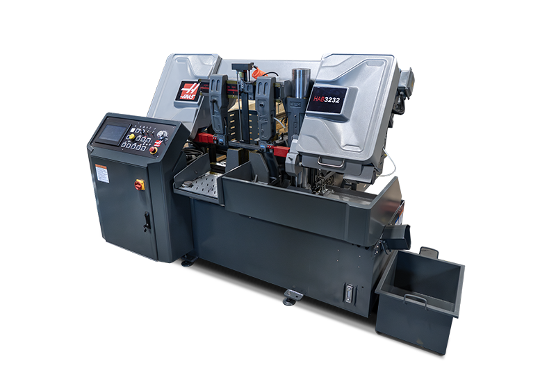

Haas Automatic Bandsaw, 12.6" x 12.6" cutting capacity
  • Max cutting height – 12.6" (320 mm)
  • Max cutting width – 12.6" (320 mm)
  • AI mode
  • Wheel adjustable feedrate
  • Hydraulic blade tension
  • Automatic chip auger
  • Bar stacking capability
  • Manual and automatic modes
  • Memory for multiple jobs
Elevate shop productivity and precision with the Haas HAB3232 Automatic Bandsaw, designed to meet the rigorous demands of automated metal cutting. Engineered for precision, our bandsaw delivers smooth, clean cuts on a variety of metals, from steel to aluminum. The HAB3232 can cut different lengths in the same cycle, and has bar-stacking capability for extra efficiency.
Featuring an intuitive control panel, the HAB3232 offers user-friendly operation. Use AI Mode to let the saw determine its own feedrate, or use the adjustment wheel to make fine adjustments and determine what feedrate works best.

    Specifications SAE Metric
    Cutting Capacity Round 0.25-12.6" 6.4-320 mm
    Cutting Capacity Square 12.6" W x 12.6" H 320 x 320 mm
    Bundle Cutting Range 12.6" W x 7.5" H" 320 x 191 mm
    Remnant Length 9.0"  229 mm
    Single Feeding Stroke 19.7" 500 mm
    Single Feeding Accuracy 0.007" 0.18 mm
    Saw Blade Size 162.0" x 1.3" x 0.04" 4115 x 33 x 1 mm
    Cutting Speed 32.8-262.5 fpm 10-80 m/min
    Saw Blade Motor 6.7 hp 5 kW
    Hydraulic Motor 1 hp 0.75 kW
    Coolant Pump Motor 0.12 hp 0.09 kW
    Hydraulic Oil Capacity 15.8 gal 60 liters
    Cutting Oil Capacity 23.7 gal 90 liters
    Floor Space 100" x 88" x 61" 2540 x 22351 x 1549 mm
    Machine Weight ≈3748 lb ≈1799 kg
    Bed Height 26.2" 665 mm
    Full Load Amps (3 Phase) - Low 19 A 19 A
    Shipping Dimensions [L x W x H] 92.9 in x 88.6 in x 82.7 in  2360 x 2250 x 2100 mm
    Shipping Weight 4560 lb 2068 kg
