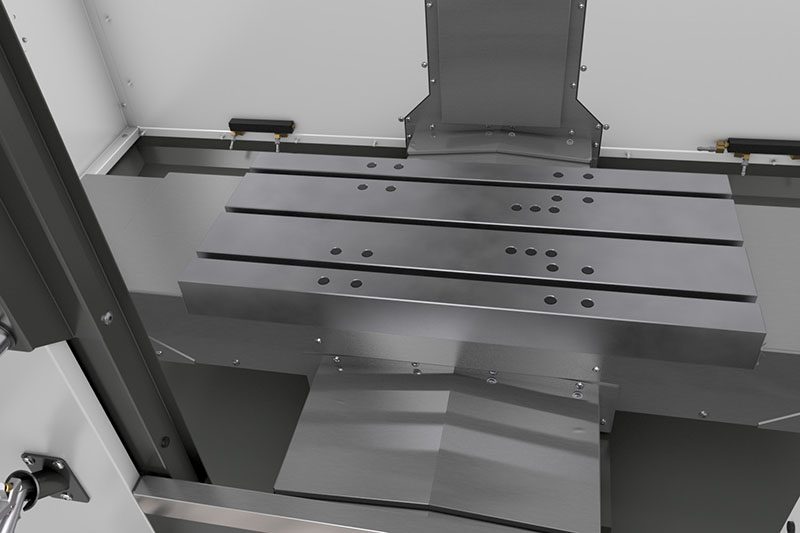

X Axis 28.00 in 711 mm
Y Axis 16.00 in 406 mm
Z Axis 15.50 in 394 mm
Spindle Nose to Table (~ max) 21.5 in 546 mm
Spindle Nose to Table (~ min) 6.0 in 152 mm
Spindle S.A.E METRIC
Max Rating 15.0 hp 11.2 kW
Max Speed 10000 rpm 10000 rpm
Max Torque 46.0 ft-lbf @ 1700 rpm 62.0 Nm @ 1700 rpm
Drive System Inline Direct-Drive Inline Direct-Drive
Taper BT30 BT30
Bearing Lubrication Air / Oil Injection Air / Oil Injection
Cooling Air Cooled Air Cooled
Table S.A.E METRIC
Length 34.0 in 864 mm
Width 15.0 in 381 mm
T-Slot Width 0.626 in to 0.630 in 15.90 mm to 16.00 mm
T-Slot Center Distance 4.92 in 125 mm
Number of Std T-Slots 3 3
Max Weight on Table-100% Rapids (evenly dist.) 250 lb 113.4 kg
Max Weight on Table-50% Rapids (evenly dist.) 500 lb 226.8 kg

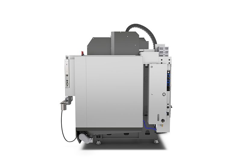

General S.A.E METRIC
Coolant Capacity 55 gal 208 L
Air Requirements S.A.E METRIC
Inline Air Hose 3/8 in 3/8 in
Coupler (Air) 3/8 in 3/8 in
Spindle Speed 10000 rpm 10000 rpm
Spindle Power 15.0 hp 11.2 kW
Full Load Amps (3 Phase) - Low 40 A 40 A
Domestic Pallet 100.0 in x 91.0 in x 99.0 in 254 cm x 231 cm x 251 cm
Export Pallet 100.0 in x 91.0 in x 99.0 in 254 cm x 231 cm x 251 cm
Weight 5350 lb 2427.0 kg
