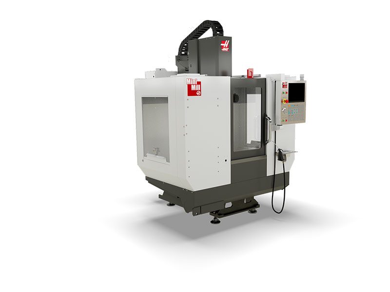

Mini CNC Vertical Mill Exclusively for Education, with 16" x 14" x 15" travels
The completely redesigned Mini Mill-EDU is a specially priced education-edition machine that is perfect for schools as a first step into CNC machining and training. The machine is enhanced with all-new FEA-optimized base and column castings, larger travels, and faster spindle speeds and rapids. An all-new 45-gallon (170-liter) external coolant tank (optional) and Y-axis washdown nozzle improve chip flow and simplify maintenance. The new Mini Mill-EDU also easily interfaces with Haas robot packages or the Compact APL for fast, easy automation.
  • Operates on single- or three-phase power
  • Available exclusively for educational institutions
  • Built with the same high-quality components as the standard Mini Mill
  • Includes an education resource package
NOTE: Single-phase operation is not available in Europe.
