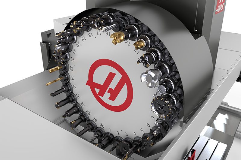

    Tool Changer S.A.E METRIC
    Type SMTC SMTC
    Capacity 30+1 30+1
    Max Tool Diameter (full)** 4.0 in 102 mm
    Max Tool Diameter, Large (adjacent empty)** 10.0 in 254 mm
    Max Tool Length (from gage line) 16.00 in 406 mm
    Max Tool Weight 30.0 lb 13.6 kg
    Tool-to-Tool (avg) 4.20 s 4.20 s
    Chip-to-Chip (avg) 6.30 s 6.30 s
