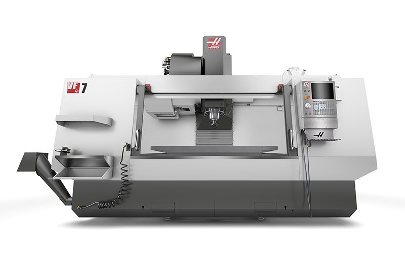

CNC Vertical Mill with 84" x 32" x 30" travels
Every VF Series vertical machining center provides outstanding features at an excellent price, and offers a wide range of available options to customize your machine to your exact needs.
  • 50-taper spindle with 2-speed gearbox
  • Customizable to your needs
  • Ideal for tougher materials and larger-diameter cutting tools
See Available Stock
Current Lead Time
  • 50 Taper
  • 3 Axis
  • 7.5k RPM
  • 30+1 Tool Capacity

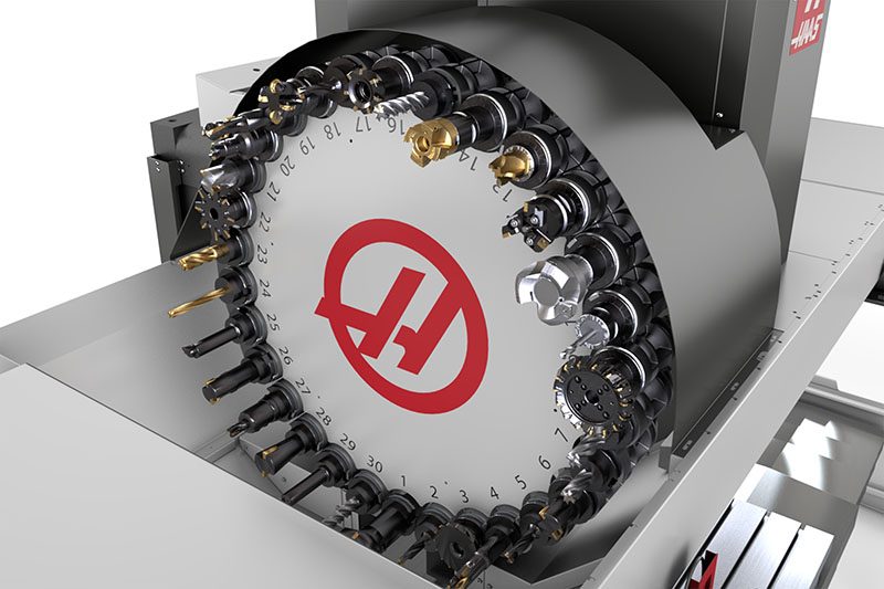

  • 30+1 Side-Mount Tool Changer, 50-Taper

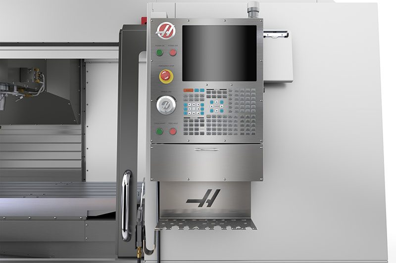

  • Control Widescreen Monitor
  • Large Remote Jog Handle with Touchscreen Display

Capacity 30+1 30+1
Max Tool Diameter (full) 4.0 in 102 mm
Max Tool Diameter (adjacent empty) 10.0 in 254 mm
Max Tool Length (from gage line) 16 in 406 mm
Max Tool Weight 30.0 lb 13.6 kg
