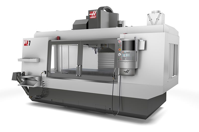

VF-7/40
    CNY ONLY
For the best pricing in your area, contact your local Haas Factory Outlet.
CNC Vertical Mill with 84" x 32" x 30" travels
All large-frame models come with an upgraded features package that includes a side-mount tool changer, chip auger, programmable coolant nozzle, and remote jog handle.

    Travels S.A.E METRIC
    X Axis 84.00 in 2134 mm
    Y Axis 32.00 in 813 mm
    Z Axis 30.00 in 762 mm
    Spindle Nose to Table (~ max) 34.0 in 864 mm
    Spindle Nose to Table (~ min) 4.0 in 102 mm
    Spindle S.A.E METRIC
    Max Rating 30.0 hp 22.4 kW
    Max Speed 8100 rpm 8100 rpm
    Max Torque 90.0 ft-lbf @ 2000 rpm 122.0 Nm @ 2000 rpm
    Max Torque w/opt Gearbox 250 ft-lbf @ 450 rpm 339 Nm @ 450 rpm
    Drive System Inline Direct-Drive Inline Direct-Drive
    Taper CT40 | BT40 | HSK-A63 CT40 | BT40 | HSK-A63
    Bearing Lubrication Air / Oil Injection Air / Oil Injection
    Cooling Liquid Cooled Liquid Cooled
    Table S.A.E METRIC
    Length 84.0 in 2134 mm
    Width 28.0 in 711 mm
    T-Slot Width 0.626 in to 0.630 in 15.90 mm to 16.00 mm
    T-Slot Center Distance 4.92 in 125 mm
    Number of Std T-Slots 5 5
    Max Weight on Table (evenly distributed) 4000 lb 1814 kg
    Feedrates S.A.E METRIC
    Max Cutting 500 ipm 12.7 m/min
    Rapids on X 600 ipm 15.2 m/min
    Rapids on Y 600 ipm 15.2 m/min
    Rapids on Z 600 ipm 15.2 m/min
    Axis Motors S.A.E METRIC
    Max Thrust X 3400 lbf 15124 N
    Max Thrust Y 3400 lbf 15124 N
    Max Thrust Z 5600 lbf 24910 N

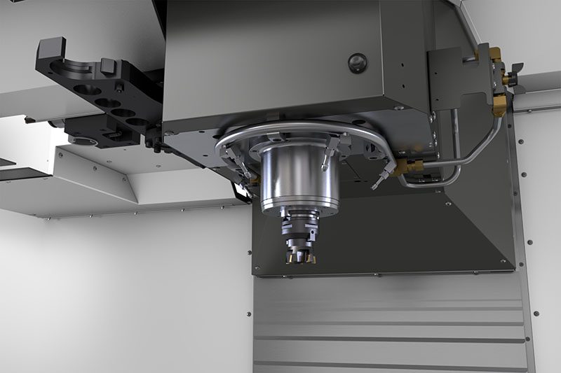

    Tool Changer S.A.E METRIC
    Type SMTC SMTC
    Capacity 30+1 30+1
    Max Tool Diameter, Extra-Large (adjacent empty)** 6.0 in 152 mm
    Max Tool Length (from gage line) 16.00 in 406 mm
    Max Tool Weight 12.0 lb 5.4 kg
    Tool-to-Tool (avg) 2.80 s 2.80 s
    Chip-to-Chip (avg) 3.60 s 3.60 s
    General S.A.E METRIC
    Coolant Capacity 95 gal 360 L
    Air Requirements S.A.E METRIC
    Inline Air Hose 3/8 in 3/8 in
    Coupler (Air) 3/8 in 3/8 in
    Spindle Speed 8100 rpm 8100 rpm
    Spindle Power 30.0 hp 22.4 kW
    Full Load Amps (3 Phase) - Low 70 A 70 A
    Domestic Pallet 214.0 in x 102.0 in x 128.5 in 544 cm x 260 cm x 326 cm
    Export Crate 214.0 in x 105.5 in x 130.0 in 544 cm x 268 cm x 330 cm
    Weight 25600 lb 11612.0 kg
    Domestic Pallet w/EC Option 214 in x 102 in x 138 in 544 cm x 260 cm x 351 cm
    Export Crate w/EC Option 214 in x 106 in x 139 in 544 cm x 270 cm x 352 cm
    Weight w/EC Option 25600 lb 11612 kg
    Domestic Pallet w/50+1 SMTC 214 in x 102 in x 134 in 544 cm x 260 cm x 339 cm
    Export Crate w/50+1 SMTC 214 in x 106 in x 136 in 544 cm x 268 cm x 344 cm
    Weight w/50+1 SMTC 25600 lb 11612 kg
    Domestic Pallet w/EC Option & 50+1 SMTC 214 in x 102 in x 143 in 544 cm x 260 cm x 364 cm
    Export Crate w/EC Option & 50+1 SMTC 214 in x 106 in x 143 in 544 cm x 270 cm x 364 cm
    Weight w/EC Option & 50+1 SMTC 25600 lb 11612 kg
    NOTE: All specifications listed are for the standard machine configuration. Optional equipment may change the machine’s specifications.
