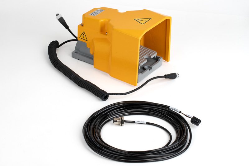

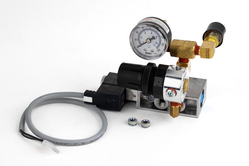

Operate a pneumatic device directly from the Haas control
Our Programmable Air option allows you to operate a single pneumatic device on your machine directly from the Haas control, via M-code or foot pedal. Includes adjustable regulator, pressure gauge, pressure switch, and foot pedal.

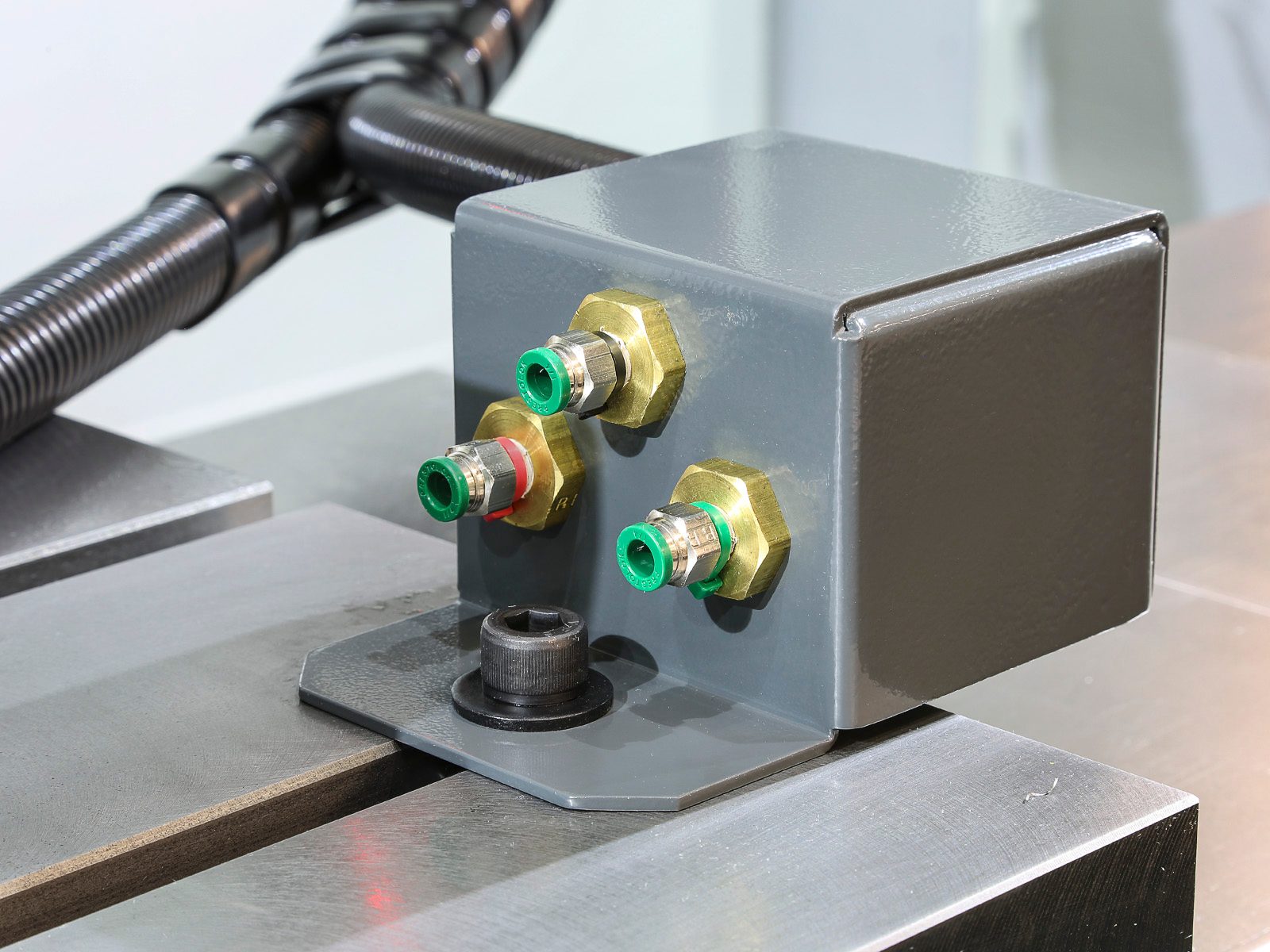

The Programmable Air option can control a single air vise. There is no need to block off the vise ports, if a vise is not installed.
NOTE: The Programmable Air option is required to operate Haas Air Vises on VF, DT, and DM series mills. Not compatible with the VF-2YT series Pallet Pool (PALLET POOL-VMC-SM). Not compatible with the Automatic Air Clamping Provision (AIR CLAMP PRO-AUTO) on Haas tilting rotary tables.
Requires a Haas mill with NGC software version 100.20.000.1200 or later.
  • M-code activated compressed air
  • Control pneumatic devices automatically
  • Programmed directly from the Haas Control
  • Mounts easily to the machine’s table
