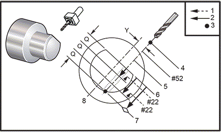

Service Home G243 Radial Normal Peck Drilling Canned Cycle (Group 09)
C - C-Axis absolute motion command
F - Feed Rate
*I - Size of first cutting depth
*J - Amount to reduce cutting depth each pass
*K - Minimum depth of cut
*P - The dwell time at the bottom of the hole
*Q - The cut-in value, always incremental
R - Position of the R plane (Diameter)
X - Position of bottom of hole (Diameter)
*Y - Y-axis absolute motion command
*Z - Z-axis absolute motion command
* indicates optional
NOTE: The P values are modal. This means if you are in the middle of a canned cycle and a G04 Pnn or an M97 Pnn is used the P value will be used for the dwell / subprogram as well as the canned cycle.
G243 Radial Normal Peck Drilling Canned Cycle: [1] Rapid, [2] Feed, [3] Start or end of stroke, [4] R plane, [#52] Setting 52, [5] R plane, [6] Part surface, [#22] Setting 22, [7] Dwell at the bottom of the hole, [8] Centerline.
Programming Notes: If I, J, and K are specified, a different operating mode is selected.The first pass will cut in the value of I, each succeeding cut will be reduced by amount J, and the minimum cutting depth is K. Do not use a Q value when programming with I,J, and K.Setting 52 changes the way G243 works when it returns to the R plane. Usually the R plane is set well outside the cut to insure that the chip clearing motion allows the chips to clear the hole. However, this is wasted motion when first drilling through this empty space. If Setting 52 is set to the distance required to clear chips, the R plane can be put much closer to the part being drilled. When the clear move to R occurs, the Z will be moved past R by this value in setting 52. Setting 22 is the amount to feed in X to get back the same point at which the retraction occurred.
