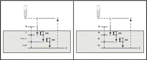

G73 High-Speed Peck Drilling Canned Cycle (Group 09)
F - Feedrate
* I - First peck depth
* J - Amount to reduce pecking depth for pass
* K - Minimum peck depth (The control calculates the number of pecks)
* L - Number of loops (Number of holes to drill) if G91 (Incremental Mode) is used
* P - Pause at the bottom of the hole (in seconds)
* Q - Peck Depth (always incremental)
* R - Position of the R plane (Distance above part surface)
* X - X-Axis location of hole
* Y - Y-Axis location of hole
Z - Position of the Z-Axis at the bottom of hole
* indicates optional
NOTE
The P values are modal. This means if you are in the middle of a canned cycle and a G04 Pnn or an M97 Pnn is used the P value will be used for the dwell / subprogram as well as the canned cycle.
G73 Peck Drilling. Left: Using I, J, and K Addresses. Right: Using Only the Q Address. [#22] Setting 22.
I, J, K, and Q are always positive numbers.
There are three methods to program a G73: using the I, J, K addresses, using the K and Q addresses, and using only a Q address.
If I, J, and K are specified, The first pass will cut in by the value I, each succeeding cut will be reduced by the value of J, and the minimum cutting depth is K. If P is specified, the tool will pause at the bottom of the hole for that amount of time.
If K and Q are both specified, a different operating mode is selected for this canned cycle. In this mode, the tool is returned to the R plane after the number of passes totals up to the K amount.
If only Q is specified, a different operating mode is selected for this canned cycle. In this mode, the tool is returned to the R plane after all pecks are completed, and all pecks will be equal to the Q value.
