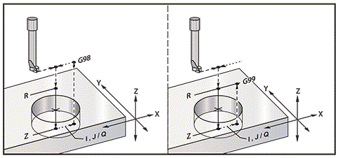

F - Feedrate
* I - Shift value along the X-Axis before retracting, if Q is not specified
* J - Shift value along the Y-Axis before retracting, if Q is not specified
* L - Number of holes to bore if G91 (Incremental Mode) is used
* P - The dwell time at the bottom of the hole
* Q - The shift value, always incremental
* R - Position of the R plane (position above the part)
* X - X-Axis location of hole
* Y - Y-Axis location of hole
Z - Position of the Z-Axis at the bottom of hole
* indicates optional
NOTE
The P values are modal. This means if you are in the middle of a canned cycle and a G04 Pnn or an M97 Pnn is used the P value will be used for the dwell / subprogram as well as the canned cycle.
CAUTION
Unless you specify otherwise, this canned cycle uses the most recently commanded spindle direction ( M03 , M04 , or M05 ). If the program did not specify a spindle direction before it commands this canned cycle, the default is M03 (clockwise). If you command M05 , the canned cycle will run as a  no-spin cycle. This lets you run applications with self-driven tools, but it can also cause a crash. Be sure of the spindle direction command when you use this canned cycle.
G76 Fine Boring Canned Cycles
In addition to boring the hole, this cycle will shift the X and/or Y Axis prior to retracting in order to clear the tool while exiting the part. If Q is used Setting 27 determines the shift direction. If Q is not specified, the optional I and J values are used to determine the shift direction and distance.
