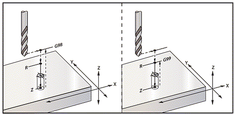

G-code, M-code, and Setting
Service Home G81 Drill Canned Cycle (Group 09)
* E - Chip-clean RPM (Spindle reverses to remove chips after each cycle)
F - Feedrate
* L - Number of holes to drill if G91 (Incremental Mode) is used
* R - Position of the R plane (position above the part)
* X - X-Axis motion command
* Y - Y-Axis motion command
Z - Position of the Z Axis at the bottom of hole
* indicates optional
CAUTION
Unless you specify otherwise, this canned cycle uses the most recently commanded spindle direction ( M03 , M04 , or M05 ). If the program did not specify a spindle direction before it commands this canned cycle, the default is M03 (clockwise). If you command M05 , the canned cycle will run as a  no-spin cycle. This lets you run applications with self-driven tools, but it can also cause a crash. Be sure of the spindle direction command when you use this canned cycle.
This is a program to drill through an aluminum plate:
O60811 (G81 DRILLING CANNED CYCLE) ;
(G54 X0 Y0 is at the top-left of part) ;
(Z0 is on top of the part) ;
(T1 is a .5 in drill) ;
(BEGIN PREPARATION BLOCKS) ;
T1 M06 (Select tool 1) ;
G00 G90 G40 G49 G54 (Safe startup) ;
G00 G54 X2. Y-2. (Rapid to 1st position) ;
S1000 M03 (Spindle on CW) ;
G43 H01 Z0.1 (Activate tool offset 1) ;
M08 (Coolant on) ;
(BEGIN CUTTING BLOCKS) ;
G81 Z-0.720 R0.1 F15.(Begin G81) ;
(Drill 1st hole at current X Y location) ;
X2. Y-4. (2nd hole) ;
X4. Y-4. (3rd hole) ;
X4. Y-2. (4th hole) ;
(BEGIN COMPLETION BLOCKS) ;
G00 G90 Z1. M09 (Rapid retract,coolant off) ;
G53 G49 Z0 M05 (Z home, spindle off) ;
G53 Y0 (Y home) ;
M30 (End program) ;
