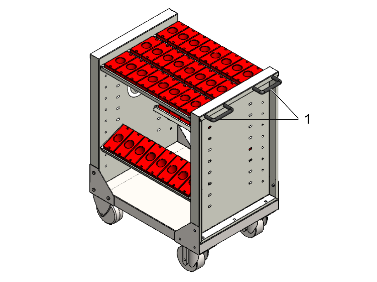

40T - Haas Tool Cart - Installation
AD0537
This procedure will show you how to assemble the Haas 40T - Tool Cart.
Installation
  • Left side panel[1]
  • Base with wheels assembly [2]
  • Gusset Plate [3]
  • Hex Bolts (M08x20) [4]
  • Fixed Castor wheel [5]
Use the gusset plate [3] and hex bolts (M08x20) [4] to fasten the left side panel [1] to the base plate [2].
The left side panel goes on the fixed castors [5] side.   Make sure the Haas Logo faces the inside of the tool cart.
  • Right Side panel
  • Gusset Plate
  • Castors with swivel
Use the gusset plate and hex bolts (M08x20) to fasten the right side panel to the base plate.
The right panel goes on the side of the castors with swivel.  Make sure the Haas Logo faces the inside of the tool cart.
  • Tool Frames
  • Hex Bolt (M08 x 20)
Use the hex bolts (M08 x 20) to install the frame with the side panel.  Similiarly install all the frames to the side panels.
Install the handle with the hex bolts (M08 x 15).
