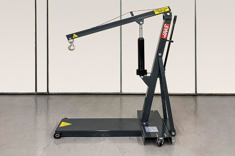

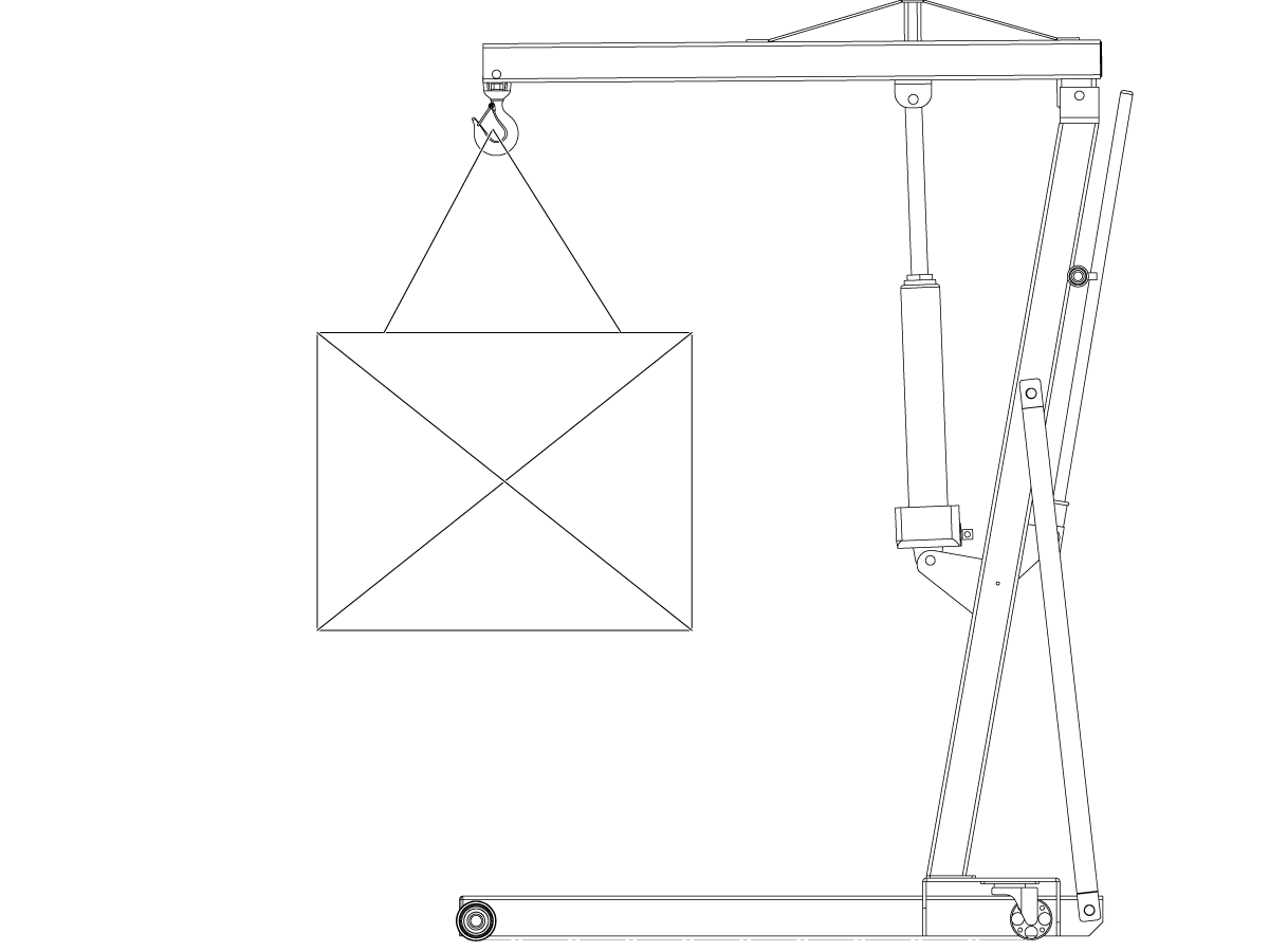

This procedure outlines how to put the Haas Shop Lift together.
Warning: The max lifting capacity is 1000lbs.
This procedure applies to the following kit:
  • 93-1000577 - HAAS SHOP LIFT
Installation

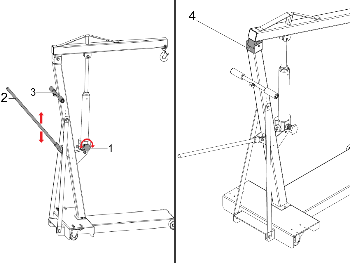

Attach the casters to the base using the bolts, hex nuts, and washers as shown, make sure to place the washer on top of the base.
Note: If the caster wheels are already attached, then move the washers from the bottom to the top of the base as shown.
Attach the mast to the base as shown in [1], use the bolts and washers that do not have hex nuts attached to them.
Note: When attaching the mast hardware make sure to attach the hardware loosely, these will be tightened in a later step.
Attach the pump arm if it is not already to the mast as shown in [2]; use a bolt, washer, and hex nut provided.
Attach the pump arm holder if it is not already to the mast as shown in [3]; use the bolts provided.
Attach the rear supports as shown. Use a bolt, washer, and hex nut at the top and (2) at the bottom.
Do not comepletely tighten the hardware until all hardware is attached, once the harware is attached go back and tighten the bolts for the mast and rear supports.
Note: The shop lift may need to turned on its side to attach the bottom hardware.
Attach the boom arm [1] as shown using a bolt, washer, and hex nut [2].
Attach the hook [3] at the front of the boom arm using a bolt, washer, and hex nut [4].
Attaching Pump and Pump Arm
Follow the steps below if the pump and pump arm did not come attached.
Take the component that links the pump arm to the pump [1] and attach it to the pump arm [2] as shown with the retaining clip [3].
Pull the pump arm down so that the linking component [1] is outside of the mast and attach it to the cylinder key [2] as shown with the retaining clip [3].
Note: If the cylinder key [2] falls out of the pump during this step or any other, make sure to purge the cylinder of air by following the Purge Air Instructions below before operation.
Operation
To lift:
Note: Before lifting the object, make sure that the release knob [1] is tightened to ensure optimal lifting.
Remove the pump arm [2] from its holder [3] and move it up and down to lift the load to the desired height.
To lower:
Turn the release knob [3] slowly to lower the load.
Troubleshooting
Symptom Possible Cause Corrective Action

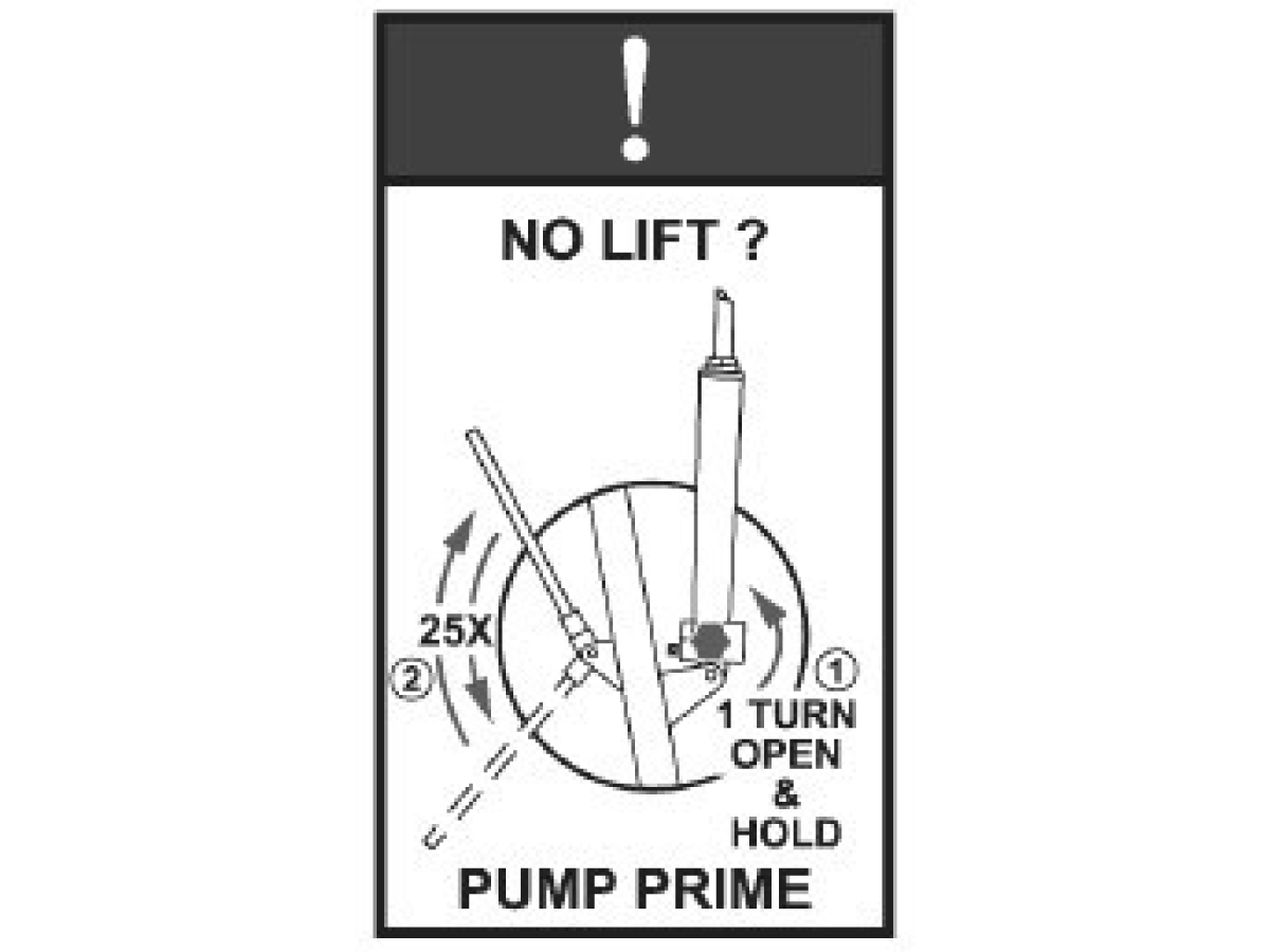

There is no pumping pressure. The cylinder may not be full of oil. Check to make sure the cylinder is full of oil. If the cylinder is not full, fill it with Jack oil.
The boom is not pumping up. The cylinder may have air inside. Follow the Purge Air Instructions below.
Important: After the Shop Lift has been assembled, make sure to turn the knob [1] to the left so that the jack is lowered with the valve open and pump the arm [2] about 20-25 times to purge any air that may have been introduced during shipping.
