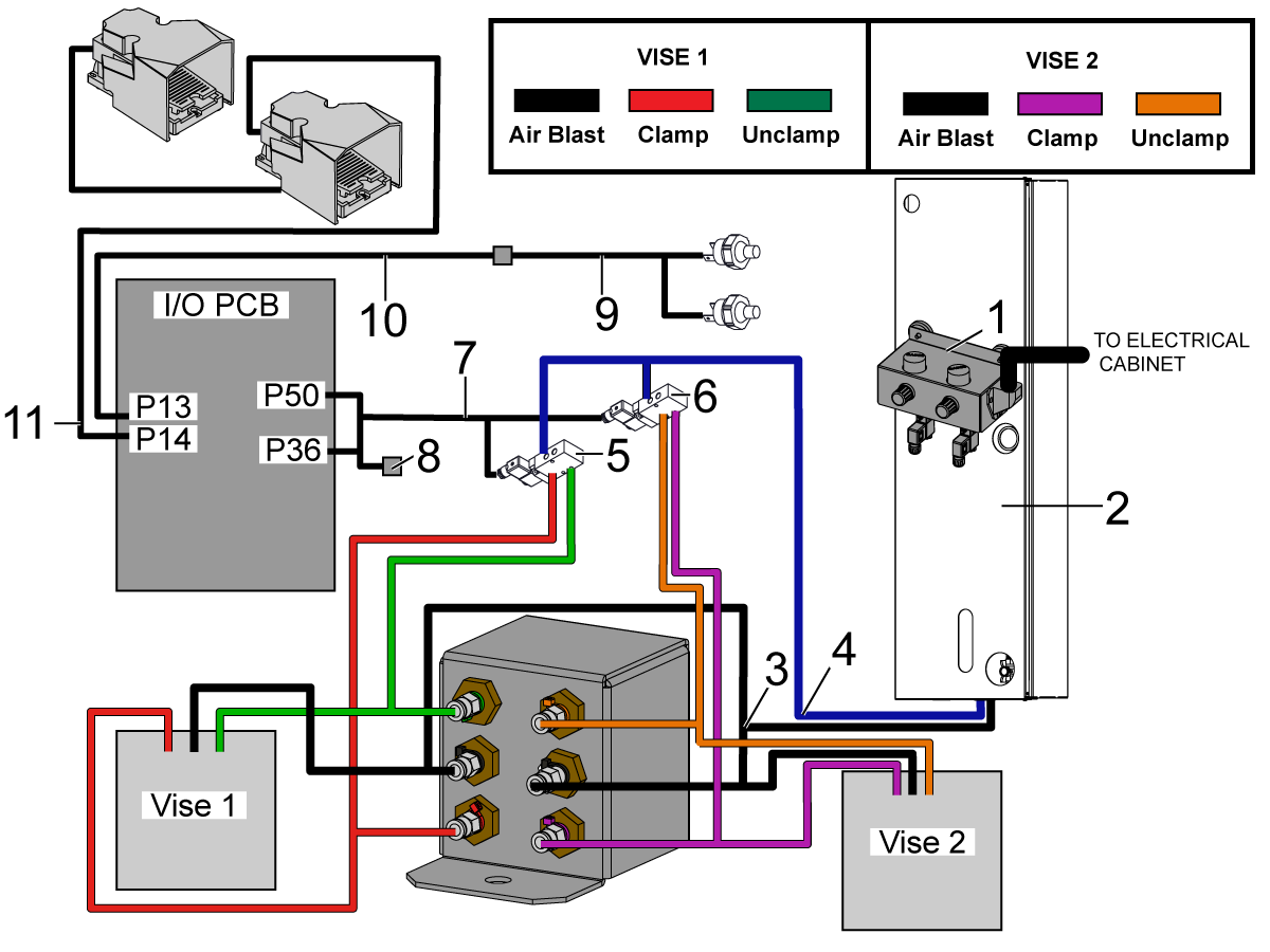

Machine Install Solenoid Installation
Solenoid 30-13112 UNCLAMP/CLAMP:
Warning: E-Stop and turn off the machine before any electrical installation

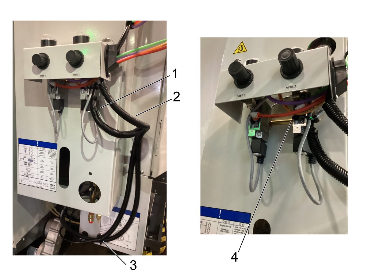

Remove a NPT plug from the air manifold inside the lubrication cabinet and install the solenoid[4] to the air manifold into the location APC DOOR INTERLOCK/PROGRAMMABLE AIR shown on the AIR - LUBRICATION SYSTEM - PICTORIAL.
Connect the red hose at the location with the red zip tie and connect the green hose at the location with the green zip tie.
Note: The ports that these hoses are installed to will determine if the vise remains clamped when power is cut to the machine. Test at end of installation.
Plug cable 33-0631[9] in at P50 on the I/O board. Plug the other end of the cable into the APC Door Interlock/Programmable Air location[1] on the solenoid bracket.
Plug the solenoid into 33-0631 at the APC Door Interlock/Programmable Air Molex connector[1].
Connect cable 33-0732[7] onto the pressure switch on solenoid 30-13112[4]. Plug cable 33-0738[8] into P13 on the I/O PCB and connect the other end to cable 33-0732[7].
 Note: If the machine is equipped with other options that utilize P13, connect it to the pigtail cable coming out of P13.

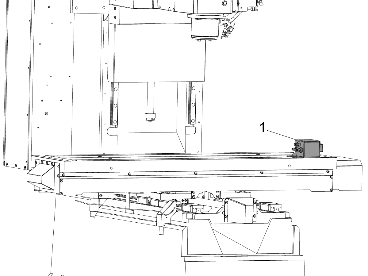

Air Manifold Installation
Table Locations
DT-1/2 - DM-1/2 - VF-1/2 - MM's
The programmable air manifold can be installed almost anywhere on the table. Verify that the conduit has enough slack and does not catch on the waycovers when at its travel limits.
VF-3/4/5
The programmable air manifold can be mounted to most locations on the table. Verify that the conduit has enough slack and does not catch on the waycovers when at its travel limits.
VF-5/40XT/50XT & VF-6/7/8/9
Install the programmable air manifold to the right side and middle of the table[1]. Verify that the conduit has enough slack and does not catch on the waycovers when at its travel limits.
VM-2/3
CM-1/2

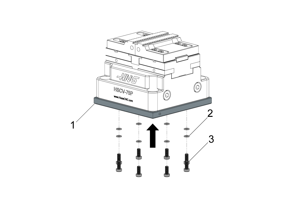

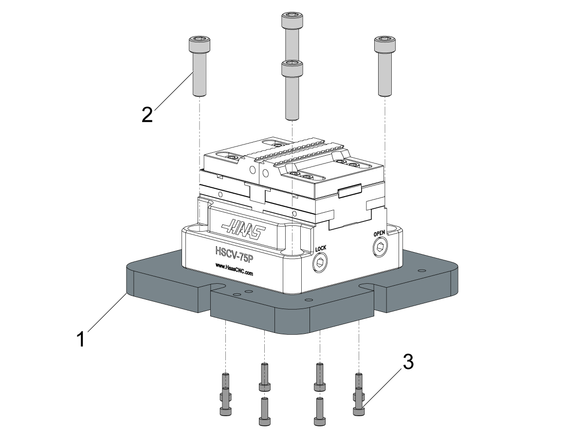

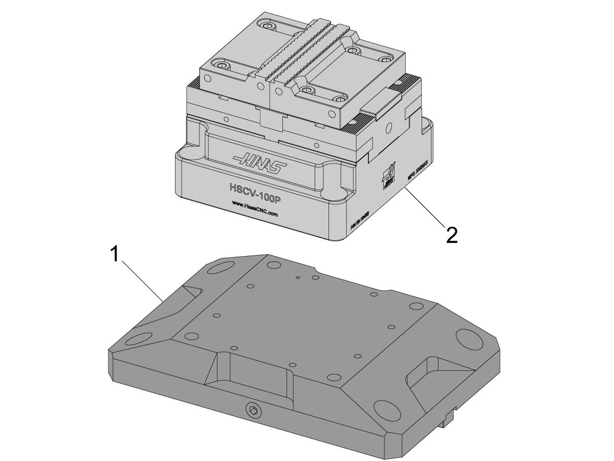

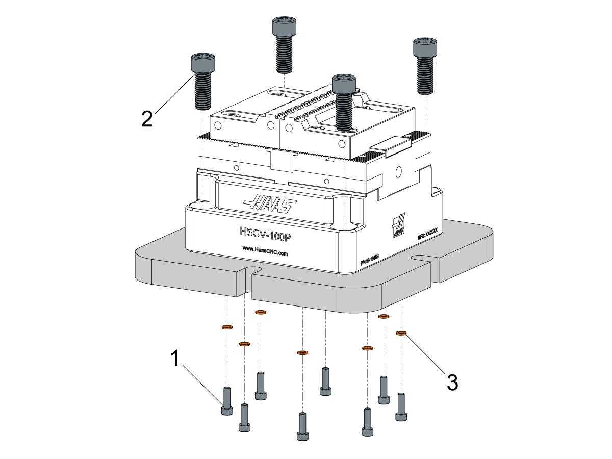

Note: These machines come standard with Table Auxiliary Air Supply. To install the programmable air manifold, a new location on the CALM air manifold will need to be used. Depending on the machine configuration an adapter will need to be made to add the programmable air solenoid.

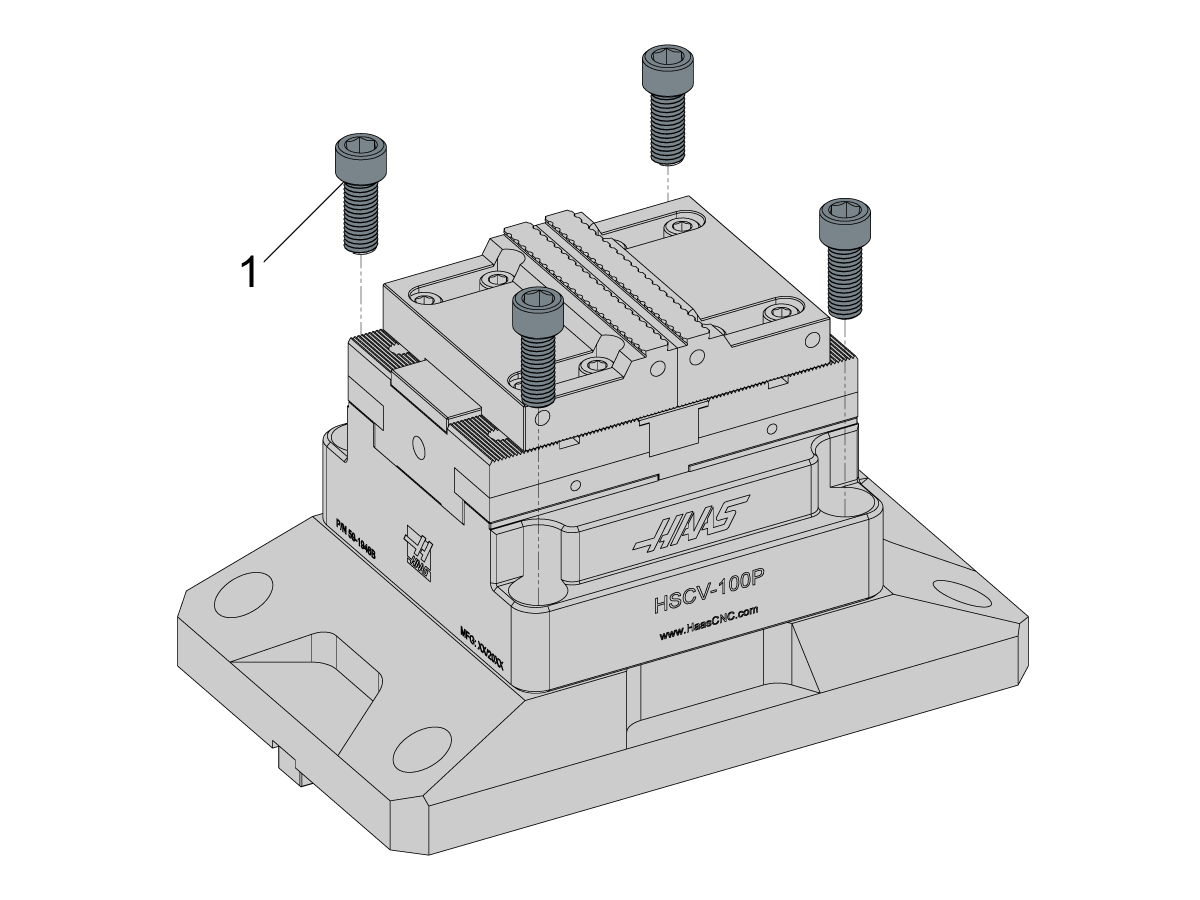

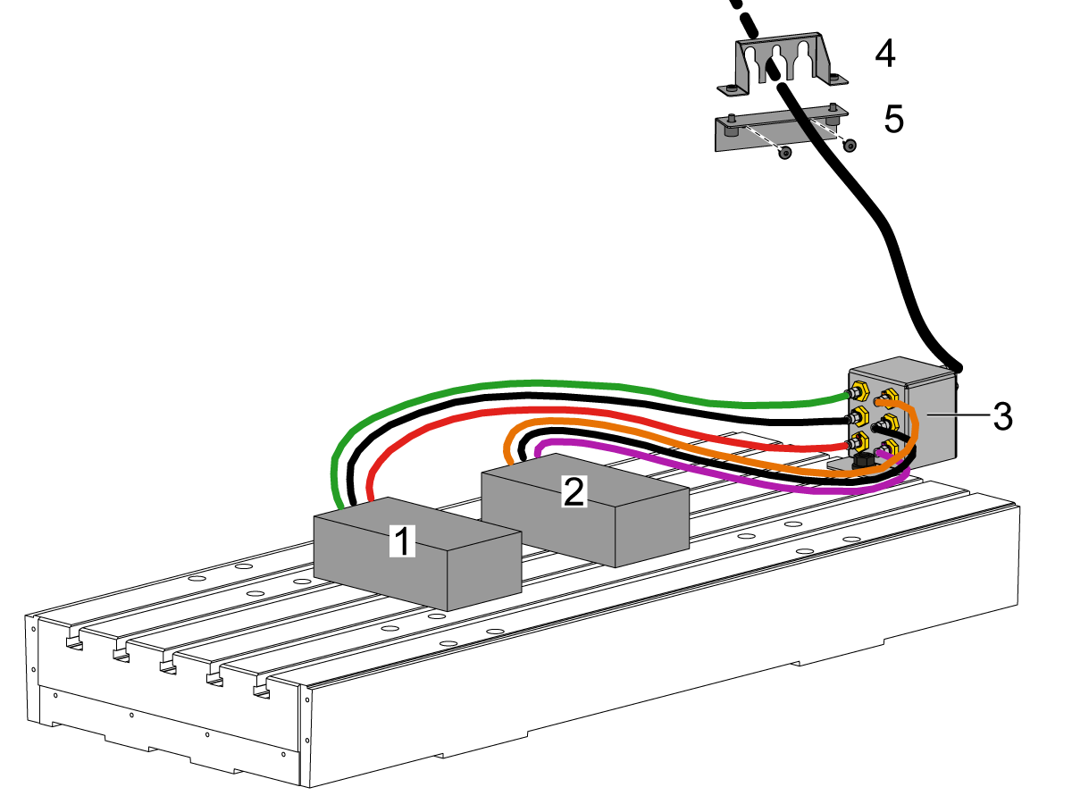

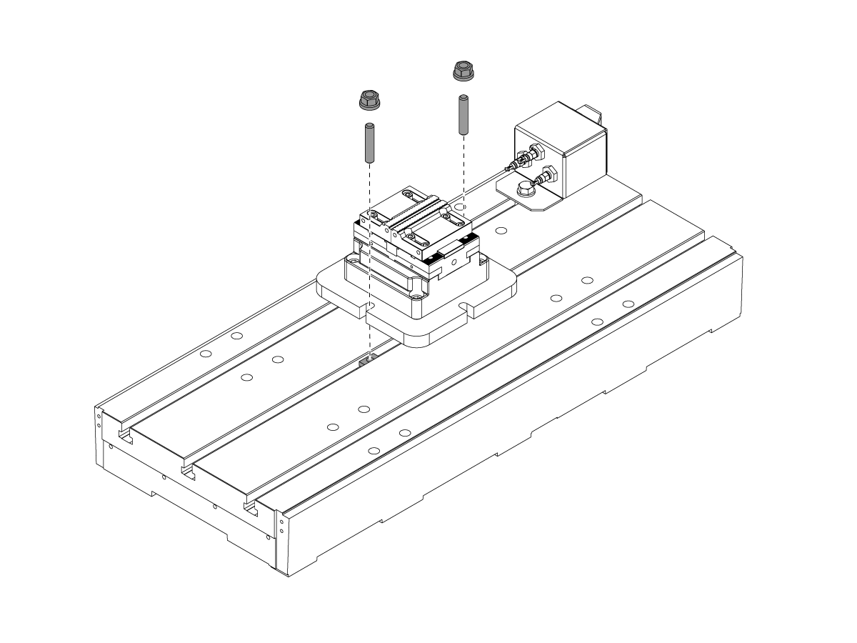

The user supplied programmable vise should be installed to the desired table location[1].

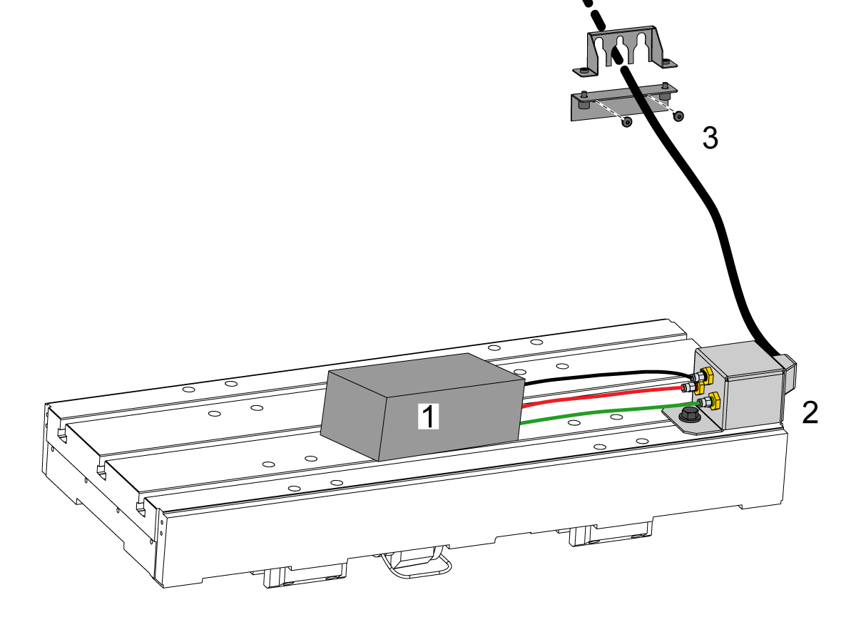

Use the included T-nut to attach manifold bracket to the table[2].

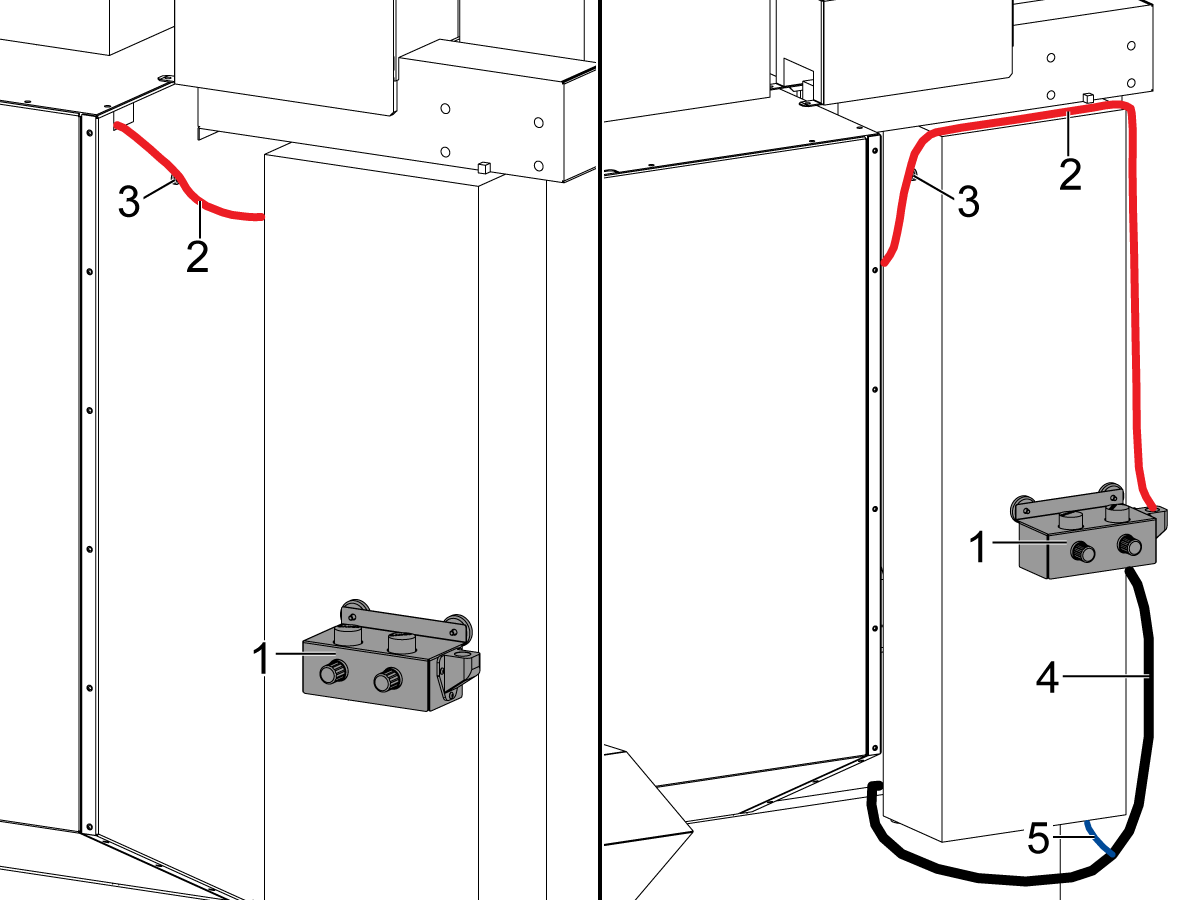

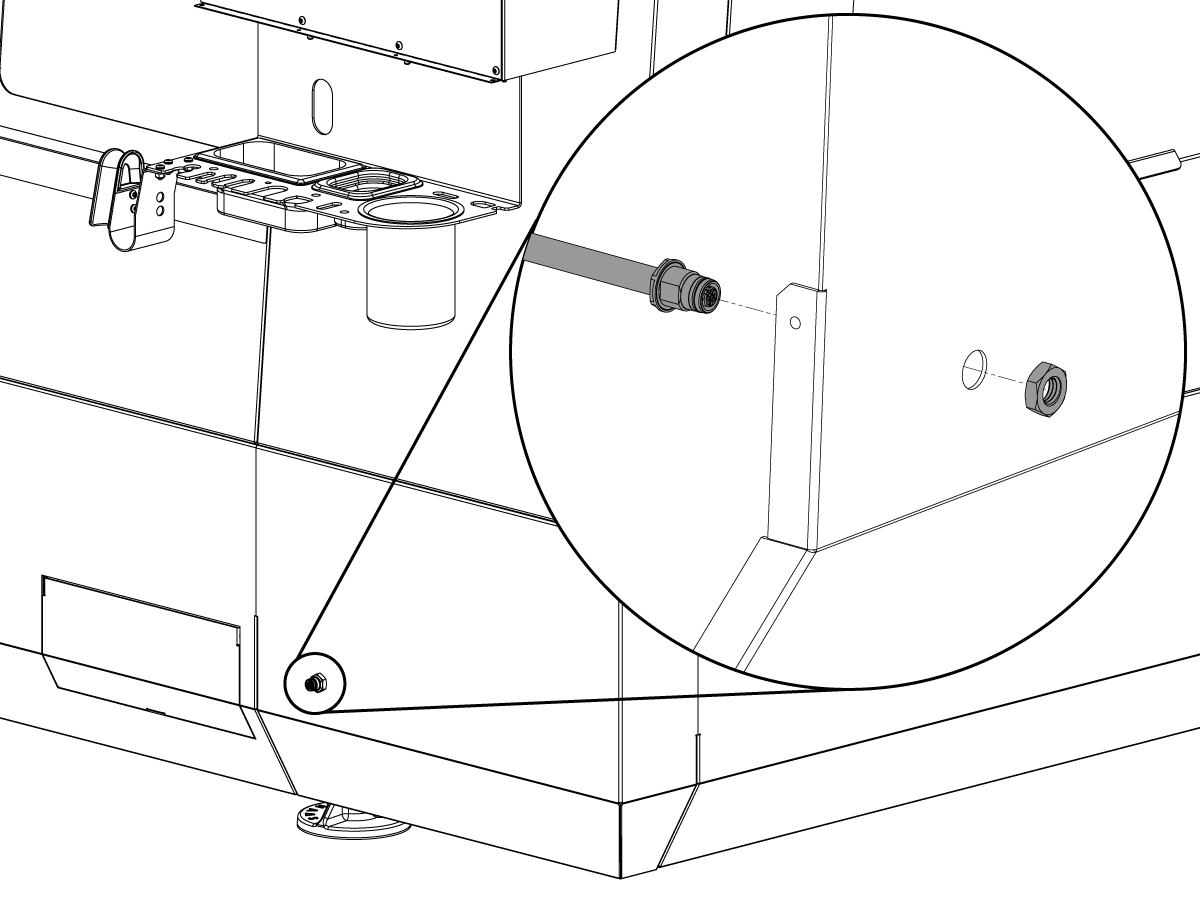

Install the cable clamp conduit into the right rear sheet metal panel of the machine as shown[3].
Jog the table into the furthest corner from the cable clamp conduit to set the travel length of the cable.
Jog the table into the closest corner of the conduit cable clamp and verify that the conduit doesn't interfere with the Z-Axis waycover, OMI sensor, or WIFI camera if these options are installed.
Plug the user supplied vise and airblast into the air manifold on the table.
Red zip tie location for clamp.
Green zip tie location for unclamp.
Black zip tie location for air blast.

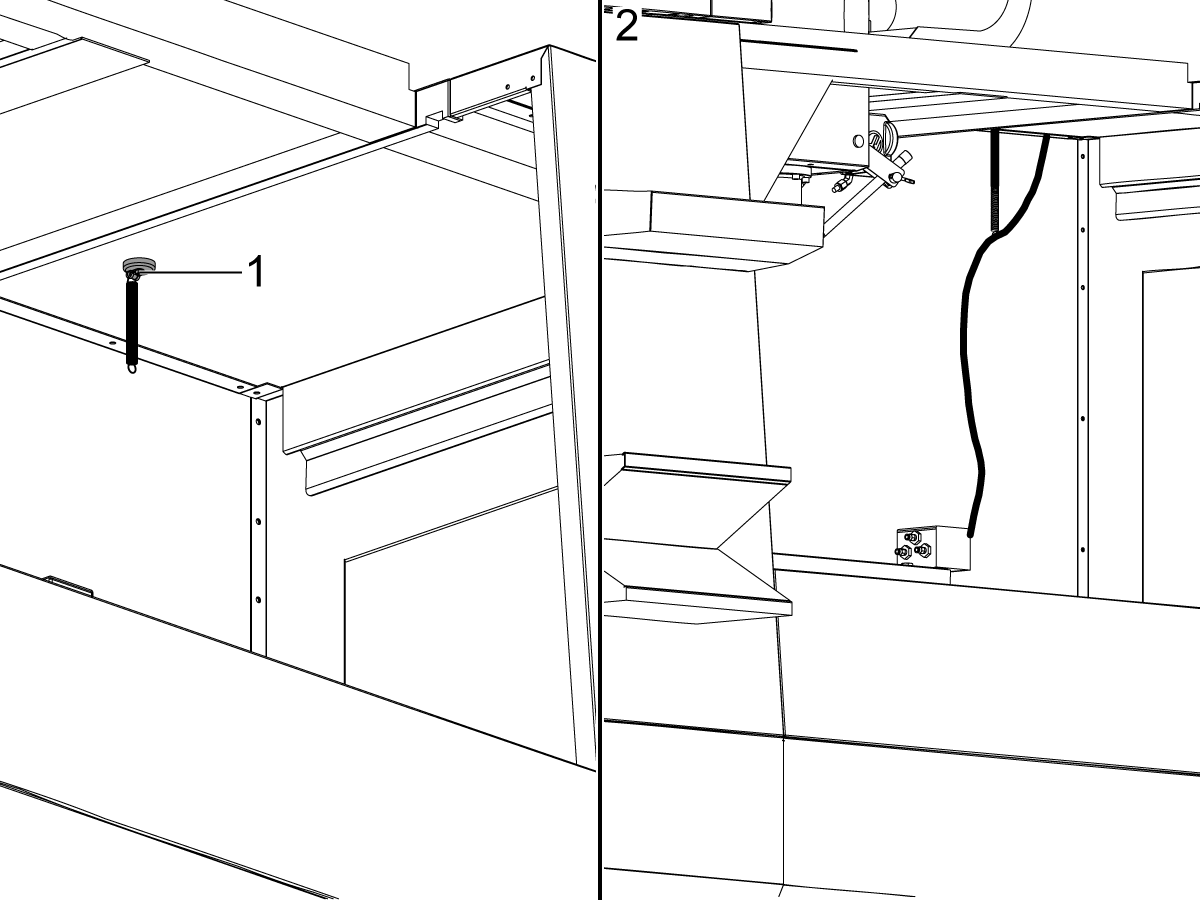

Attach the spring/magnet [1] assembly to the top panel of the machine as shown. Use it to help the drop of the cable conduit as shown in [2].

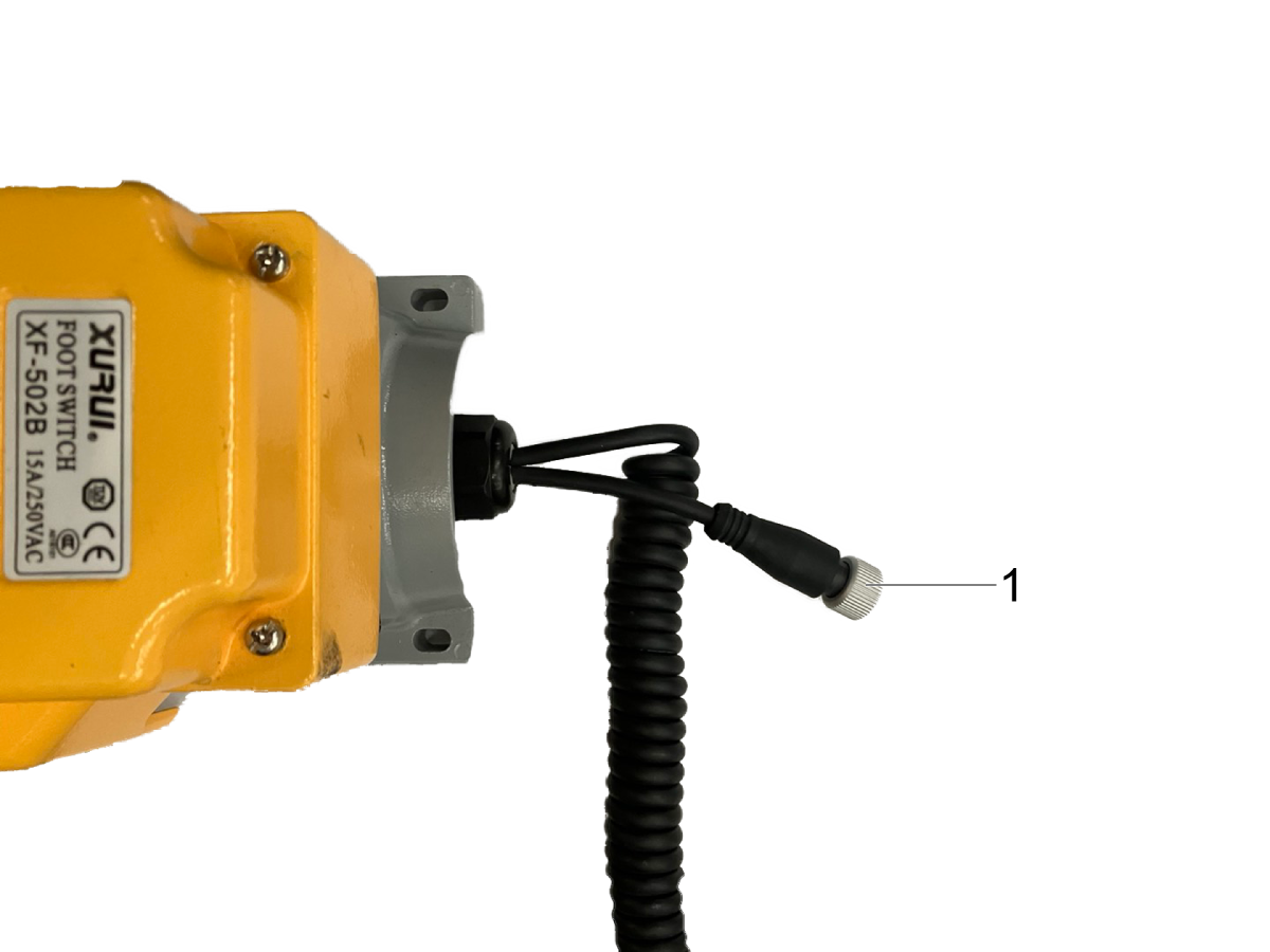

Foot Pedal Cable - Installation
Drill a 5/8" hole in the front skirt to install the foot pedal cable.
Route cable 32-1390 from P14 on the I/O PCB along the side skirt using the magnetic mounts to the front skirt of the machine to connect to the foot pedal.

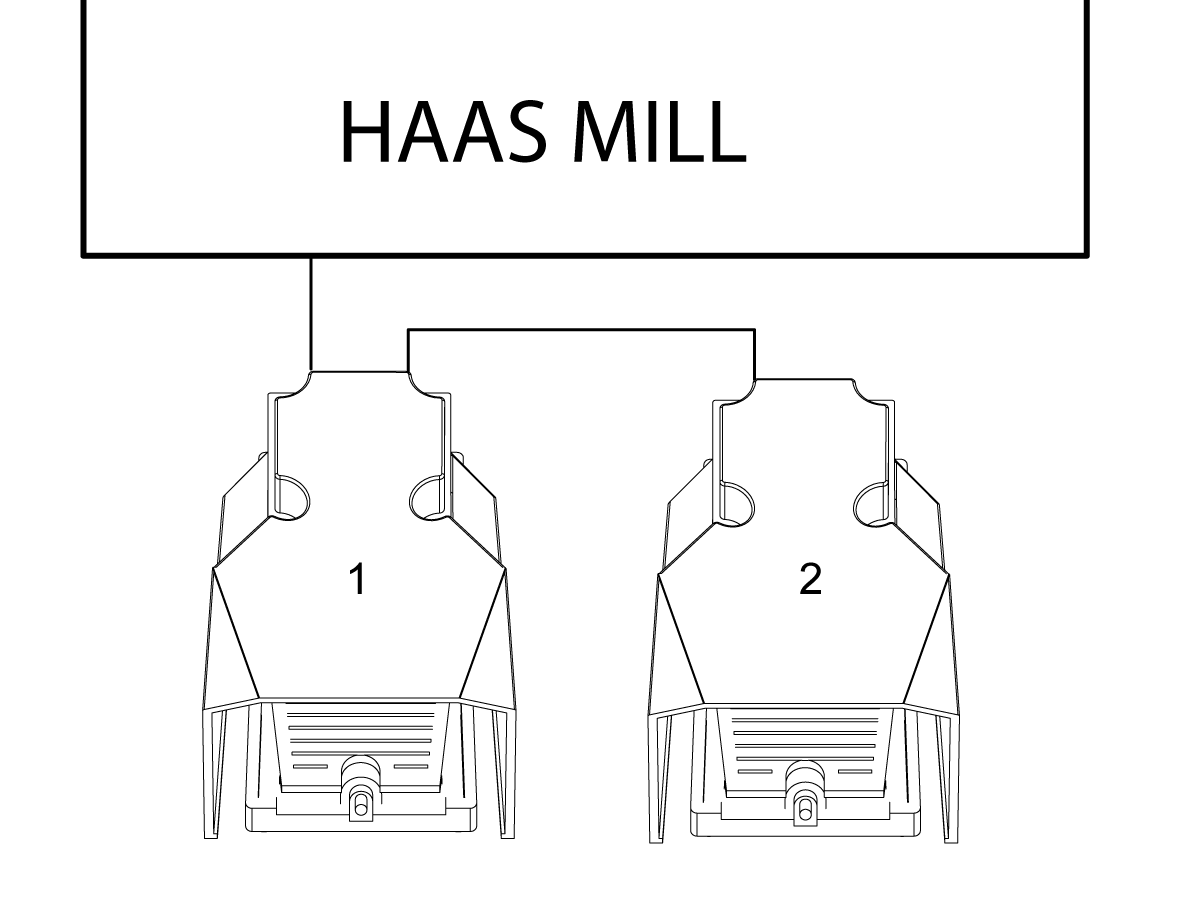

Mini Mill Install
On Mini Mills a sheet metal bracket [2] will need to be installed on the front of the machine for the foot pedal as shown with the magnet [1] given in the kit.
Route cable 32-1390 from P14 on the I/O PCB and install the cable to the bracket [2].
 Note: The short connector [1] does not need to be connected. This is for daisy chaining multiple foot pedals together when using dual programable air.

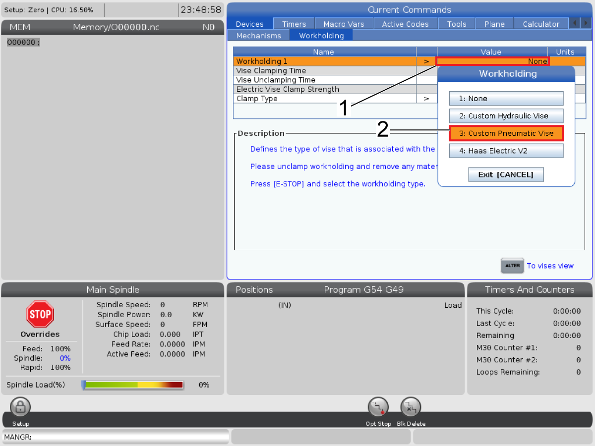

Setup

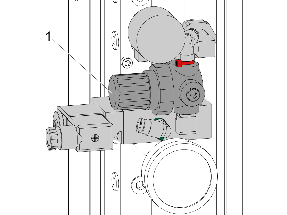

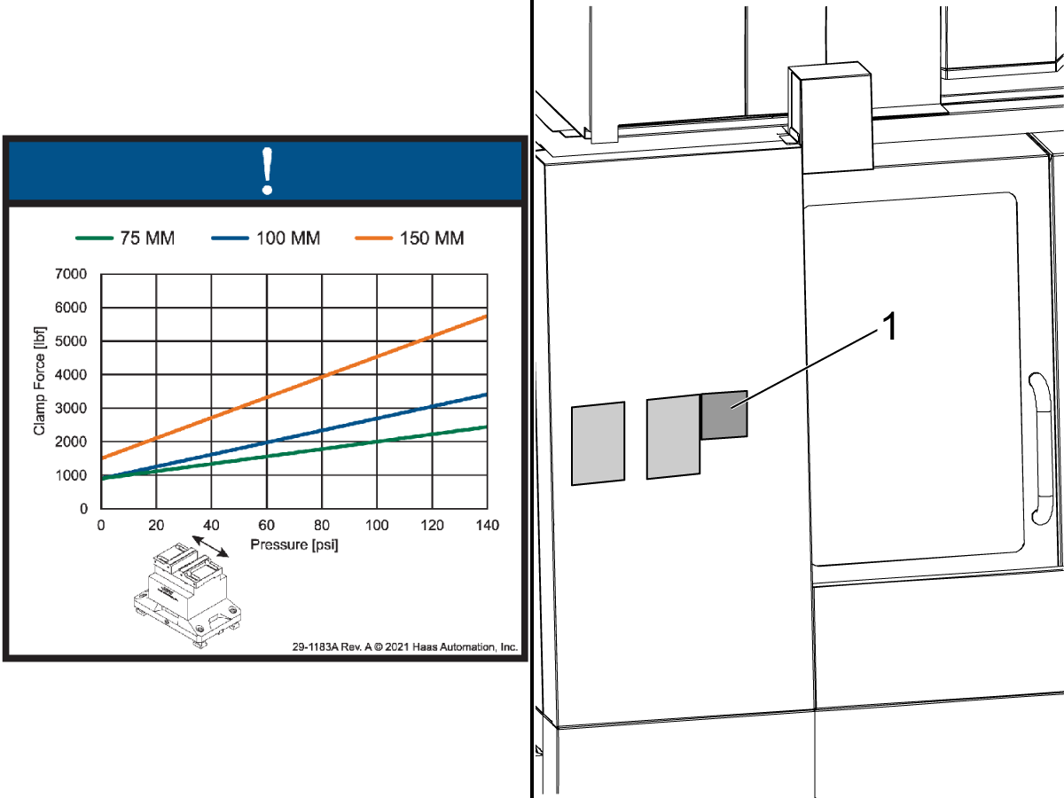

Press SETTING and set Setting 276 Workholding Input Number to 15.

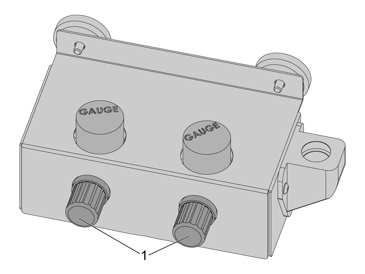

The clamp force of the Pneumatic Vise can be adjusted by adjusting the Air Regulator[1] on the Clamp/Unclamp solenoid. The higher the pressure, the greater the clamp force.
Verify the pressure switch functions by running the spindle in MDI: M03 S100;
Lower the air pressure all the way by turning down the regulator until the machine alarms with Alarm 180 Fixture Not Clamped. Adjust the pressure back to the desired pressure.

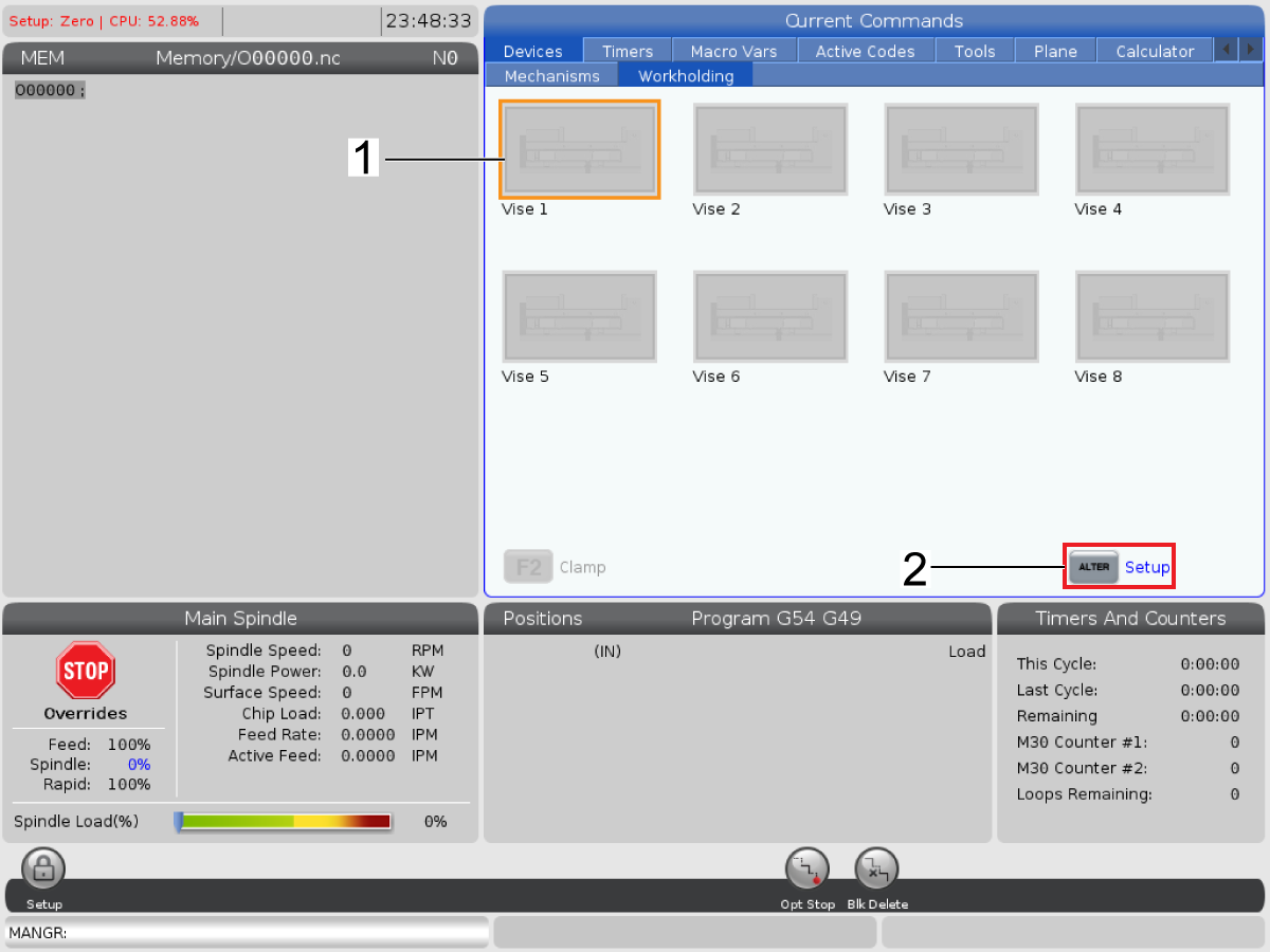

Press [CURRENT COMMANDS] and navigate to Devices > Workholding > Vise 1.
Press [ALTER] to setup the vise.

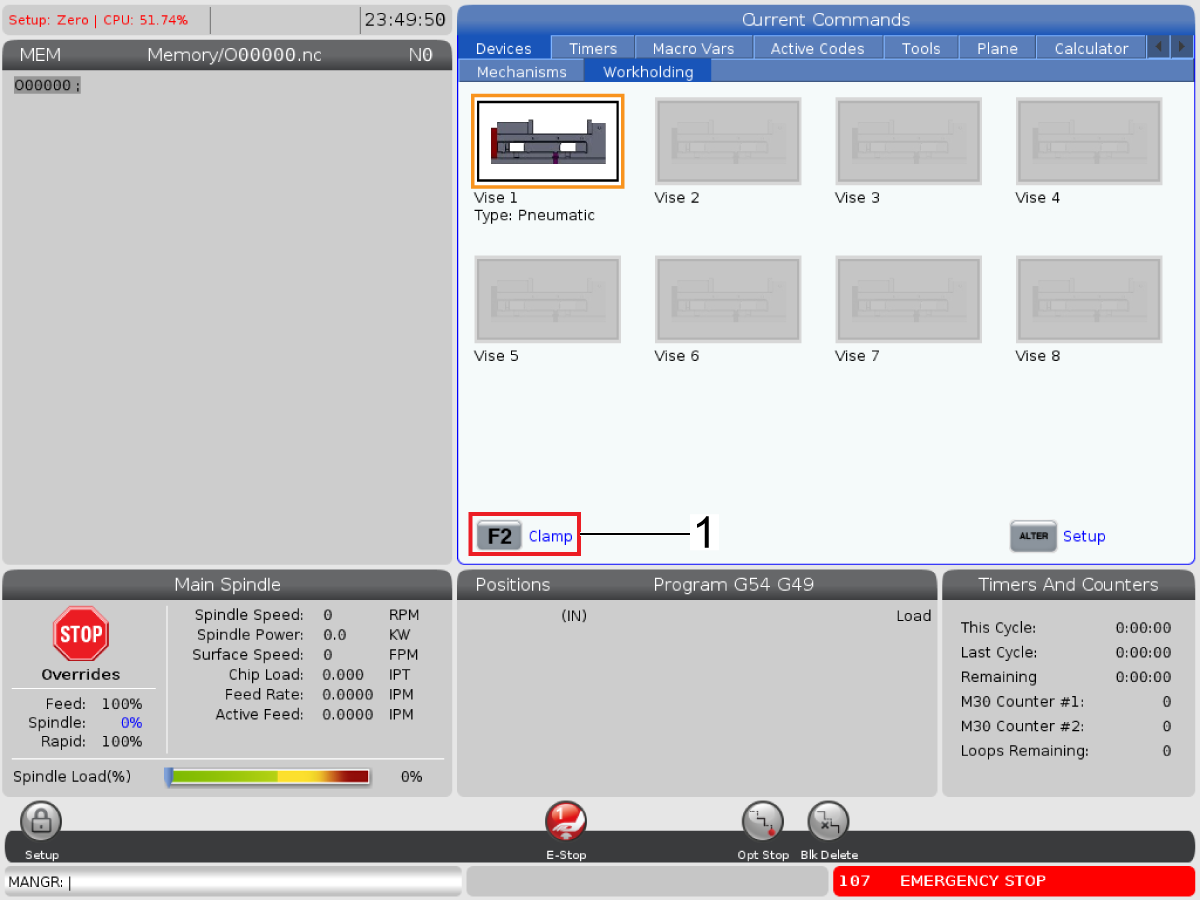

Press [E-Stop] and select 3. Custom Pneumatic Vise.
M70/71 CLAMP/UNCLAMP
M116/M117 AIR BLAST ON/OFF
Note: Use M70 Pn / M71 Pn to clamp or unclamp the vises setup on the workholding page. The P code defines the vise number. The range is P1 - 8. For example, M70 P1 clamps Vise 1 and M71 P1 unclamps it. The system will default to Vise 1, if no P-Code is specified with M70 or M71.
Note: If alarm 391: Feature Disabled is generated when commanding the workholding, the workholding has not been setup correctly on the Workholding tab. Perform the previous steps again.
Clamp/Unclamp can be operated from the Workholding tab or by commanding the Foot Pedal.
Air Blast can be operated from the Devices tab.

Lower the air pressure to zero by turning down the regulator[1] until the machine alarms with Alarm 180 Fixture Not Clamped. Adjust the pressure back to the desired pressure.

Attach the solenoid assembly [1] to the middle of the CALM cabinet door using the magnets in the kit.
Route the cable conduit [2] from the Dual Programmable Air manifold to the solenoid assembly using the magnets from the kit as shown [3].
The air lines [4] from the solenoid assembly [1] should be routed and connected in the CALM cabinet and install the push to connect fitting.
Refer to the Dual Programmable Air decal for push to connect fitting location.
The electrical cables for the solenoid assembly are wrapped under the electrical cabinet, remove the panel from under the electrical cabinet and route the cable [4] to the solenoid assembly [1] as shown.
The solenoid assembly [1] gets attached to the middle of the CALM cabinet door with magnets.
Air from the main manifold in the CALM cabinet will connect to the small air manifold located in the solenoid assembly [1].
The air supply for the vise's solenoids [4] and the air blast [3] is connected in the CALM cabinet [2] as shown.
The air blast black air hose coming from the Dual Programmable Air manifold [3] should be connected to the solenoid in the solenoid assembly [1].
Connect the Red (clamp) and Green (unclamp) hoses from vise 1 to the solenoid [5] with red and green zipties.
Connect the Purple (clamp) and Orange (unclamp) hoses from vise 2 to the solenoid [6] with purple and orange zipties.
Cable 33-1206 [7] connects to P36 and P50 on the IOPCB and to the vise's solenoids [5],[6]. If the machine is equipped with the coolant refill option, remove the cable from P36 and connect it to the pigtail [8] on cable 33-1206.
Cable 33-1207 [9] connects to the adapter from cable 33-0738 [10] at P13.
Cable 32-1390 [11] connects to the foot pedal at the front of the machine.
Make sure cable conduit covers the air lines from the solenoid assembly to the CALM cabinet [1] and the electrical cables to the electrical cabinet [2].
NOTE: Place magnets along the cable route [3].
Zip tie the solenoid and pressure switch cable to the side of Vise 2 solenoid [4].

The user supplied programmable vise's should be installed to the desired table locations [1],[2].
Use the included T-nut to attach manifold bracket to the table [3].
Install the cable clamp conduit [4] into the sheet metal panel [5] of the machine.
NOTE: The image shows for a VF-Small, on VF-Med and VF-Large machines the sheet metal panel opening for the conduit may be on the back of the right panel or the back right of the top panel.
Red ziptie location for clamp on Vise 1.
Green ziptie location for unclamp on Vise 1.
Purple ziptie location for clamp on Vise 2.
Orange ziptie location for unclamp on Vise 2.
Black ziptie location for air blast on both Vise's
 Note: On VF-Small's and DT/DM machines, it is best to place the vises so that the air connections are to the front of the machine. If the air connections are to the back of the machine, the hoses will hit the way covers.
 Note: The hoses may be too short to reach the second vise on the table, there are extension hoses in the kit to use if this happens.

Attach the spring/magnet [1] assembly to the top panel of the machine as shown. Use it to help the droop of the cable conduit as shown in [2].
For CM-1/2 Machines
 NOTE: Only applies to machines built BEFORE 1/1/2023.
Run the cable conduit up the machine. Secure the cable conduit inside the opening on top of the enclosure [1].
From outside the machine, route the cable conduit down the column and into the CALM cabinet.

Connect the second foot pedal [2] to the first pedal [1] as shown.
The clamp force of the Pneumatic Vise's can be adjusted by adjusting the Air Regulator's[1] on the Clamp/Unclamp solenoid. The higher the pressure, the greater the clamp force.
Verify the pressure switch's function by clamping the workholding and running the spindle in MDI: M03 S100;

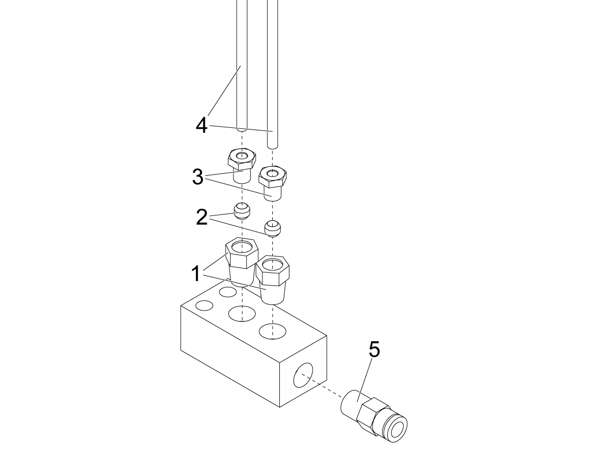

If the air blast feature is going to be installed, start by assembling the air blast manifold.
The components are:
  1. 58-1560
  2. 58-2100
  3. 58-2110
  4. 58-2170
  5. 58-0562
Note: The copper tubes will be straight and 15" long. You will need to bend and cut them to length.
Note: 58-0562 is not included in the air blast manifold kit. It will be included in the programmable air kit.
Attach the manifold to the vise using the two included bolts [1].
Bend and trim the copper tube to the desired shape.

Place the the Force-Pressure decal for the vise on the front of the machine as shown [1].

Press [CURRENT COMMAND] and navigate to the Work holding tab under the Devices tab.
Highlight the vise you want to setup [1] and press [ALTER] to setup the vise [2].
Press [E-Stop]
Press the right arrow on the keyboard to change the value from NONE [1] to 3:Custom Pneumatic Vise [2].
Make sure the vise clamps/unclamps correctly by pressing F2 [1].
Note: If the vise is not clamping/unclamping correctly, check the hoses routed to the programmable air manifold and reverse them if necessary.

Electrical Diagram
Air Blast Solenoid 30-11050[2]
Unclamp/Clamp Solenoid 30-13112[4]
PALLET AIR BLAST/PROGRAMMABLE AIR Molex connector[6]
Cable 33-0732[7]
Cable 33-0738[8]
Cable 33-0631[9]

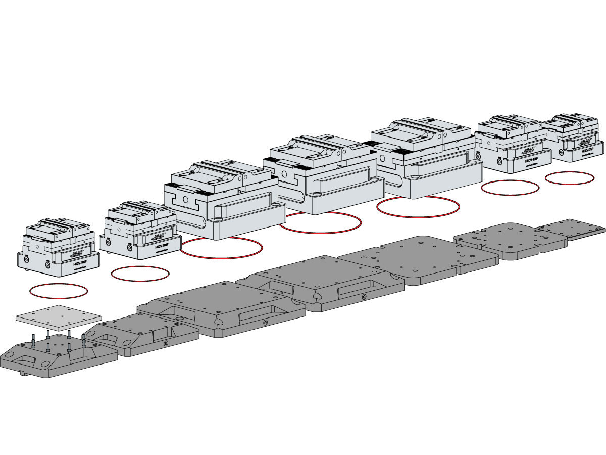

This procedure will demonstrate how to change seals on HAAS Pneumatic vises for UMC and VMC machines.
Note : UMC machines have a removable and non-removable puck varients.
This document applies to the following part numbers :
  • 06-0213 100mm SEAL KIT, UMC B-VERSION
  • 06-0214 100mm SEAL KIT, UMC A-VERSION W/ PLATE
  • 06-0215 150mm SEAL KIT, UMC W/ REMOVEABLE SPUD
  • 06-0216 150mm SEAL KIT, VMC & UMC W/O REM. SPUD
  • 06-0217 100mm SEAL KIT, VMC
  • 06-0219 75mm SEAL KIT, ROTARY
  • 06-0220 75mm SEAL KIT, VMC

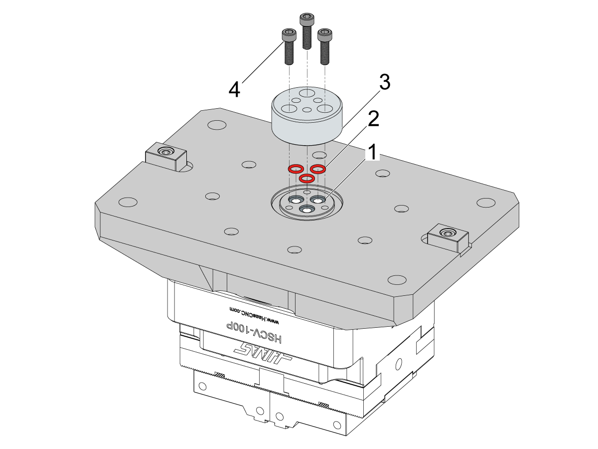

Remove the bottom puck [3] by removing the hardware [4] to replace the o-rings [2].
Note : Use multipurpose grease on o-rings [2] and grooves [1]. Ensure o-rings are properly seated.
7

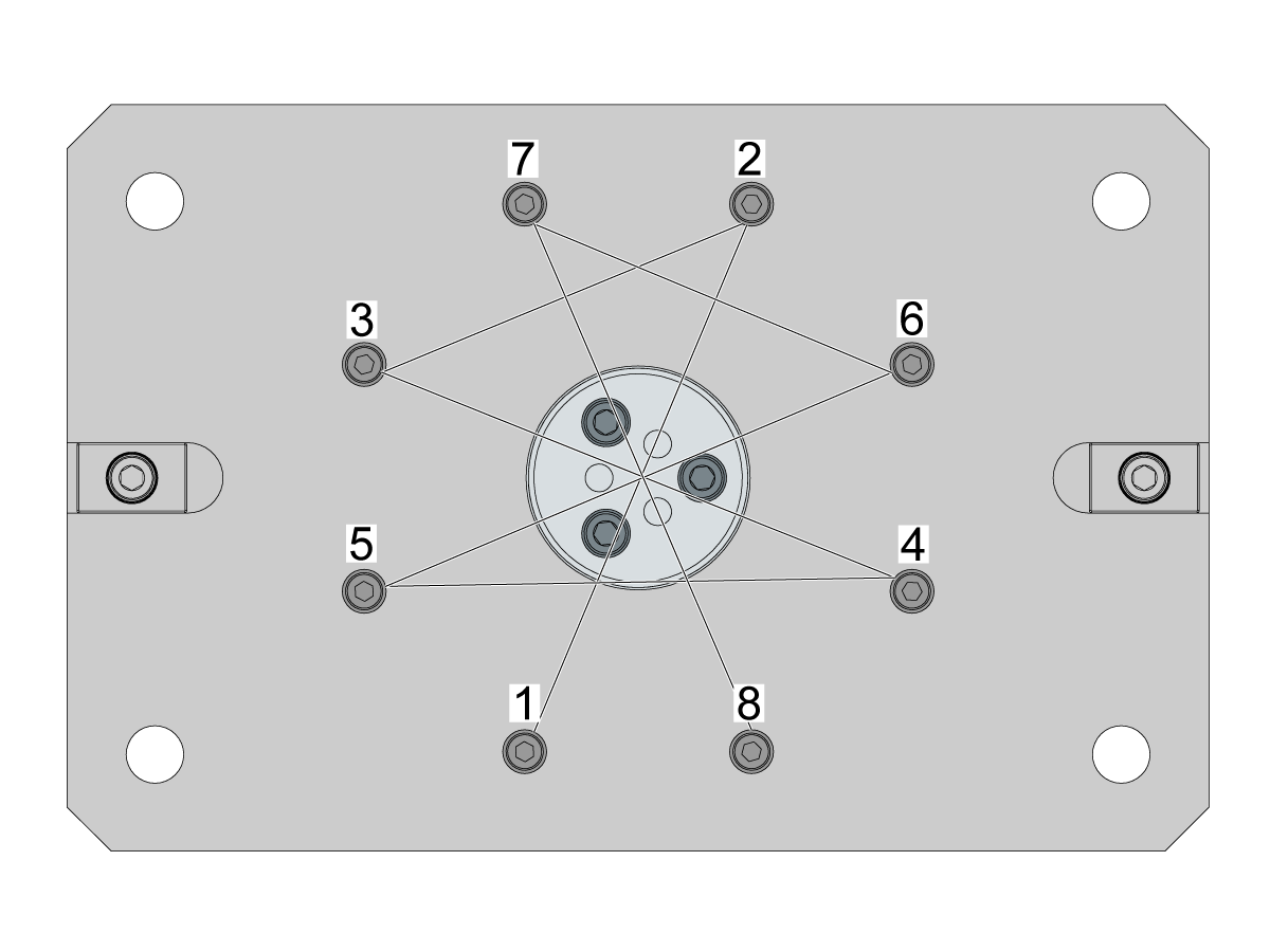

Torque  the top vise bolts in a star pattern ensuring propper clamping.
Note : Re-torque the bottom 8 and top 4 bolts to ensure that the vise is fully seated.
Important : Test vise to ensure that there are no air leaks present.

Remove the top bolts [1] and seperate the vise from the body [2].
Note : The 150mm vises need to have the bottom 8 bolts removed aswell to be seperated from the body

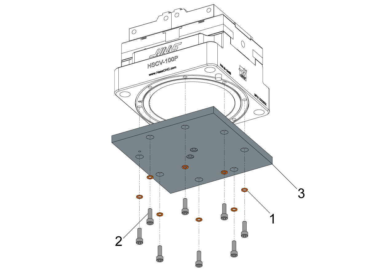

Remove the spacer plate [3] from the vise by removing the bottom bolts [2].
Note : Only the 100mm UMC vises have a spacer plate.

VMC (100-150) mm

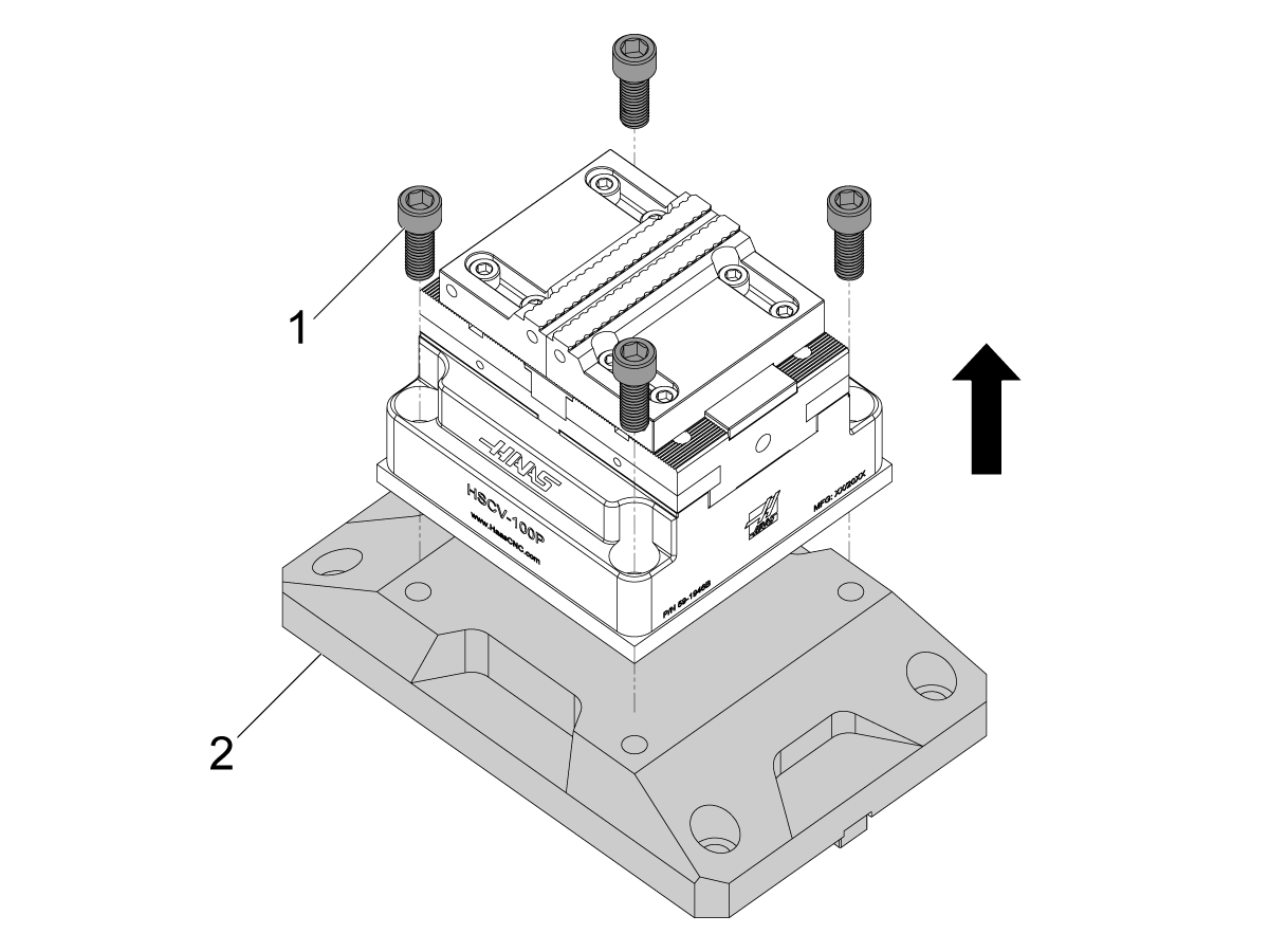

Remove the top [2] and bottom bolts [1].
Note : Only 100mm VMC vises have the bottom washers [3].
Seperate the vise [1] from the base plate [2].

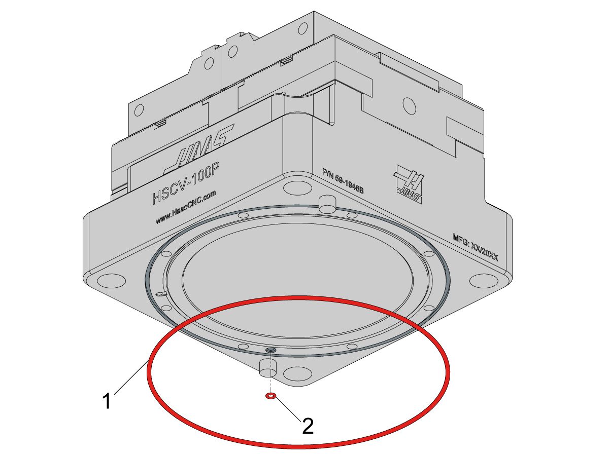

Remove and replace the o-rings [1] and [2] from the bottom of the vise.
Note : Use multipurpose grease on o-rings and grooves. Ensure o-rings are properly seated.
Attach the vise with the base plate ensuring correct orientation.
Note : Ensure that the air ports are aligned and orientated properly during re-assembly.

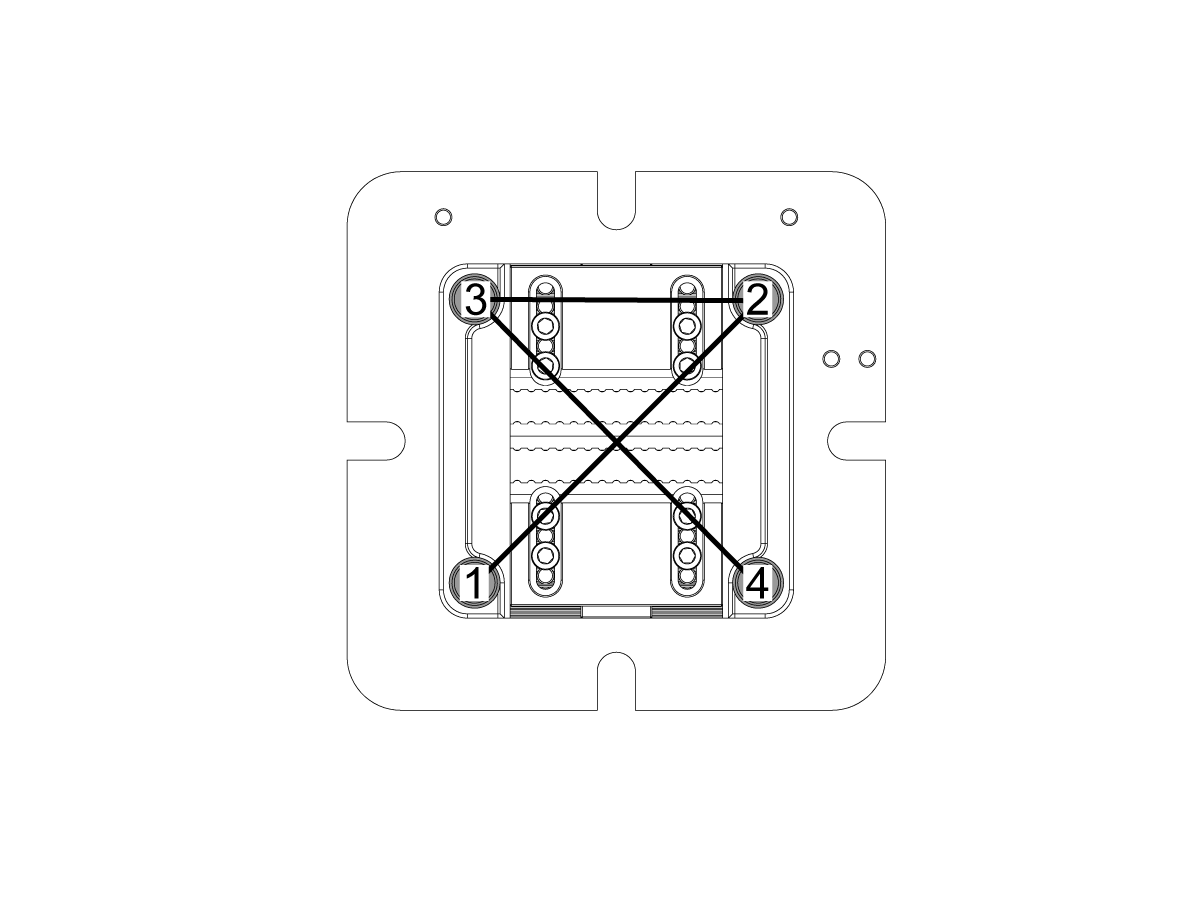

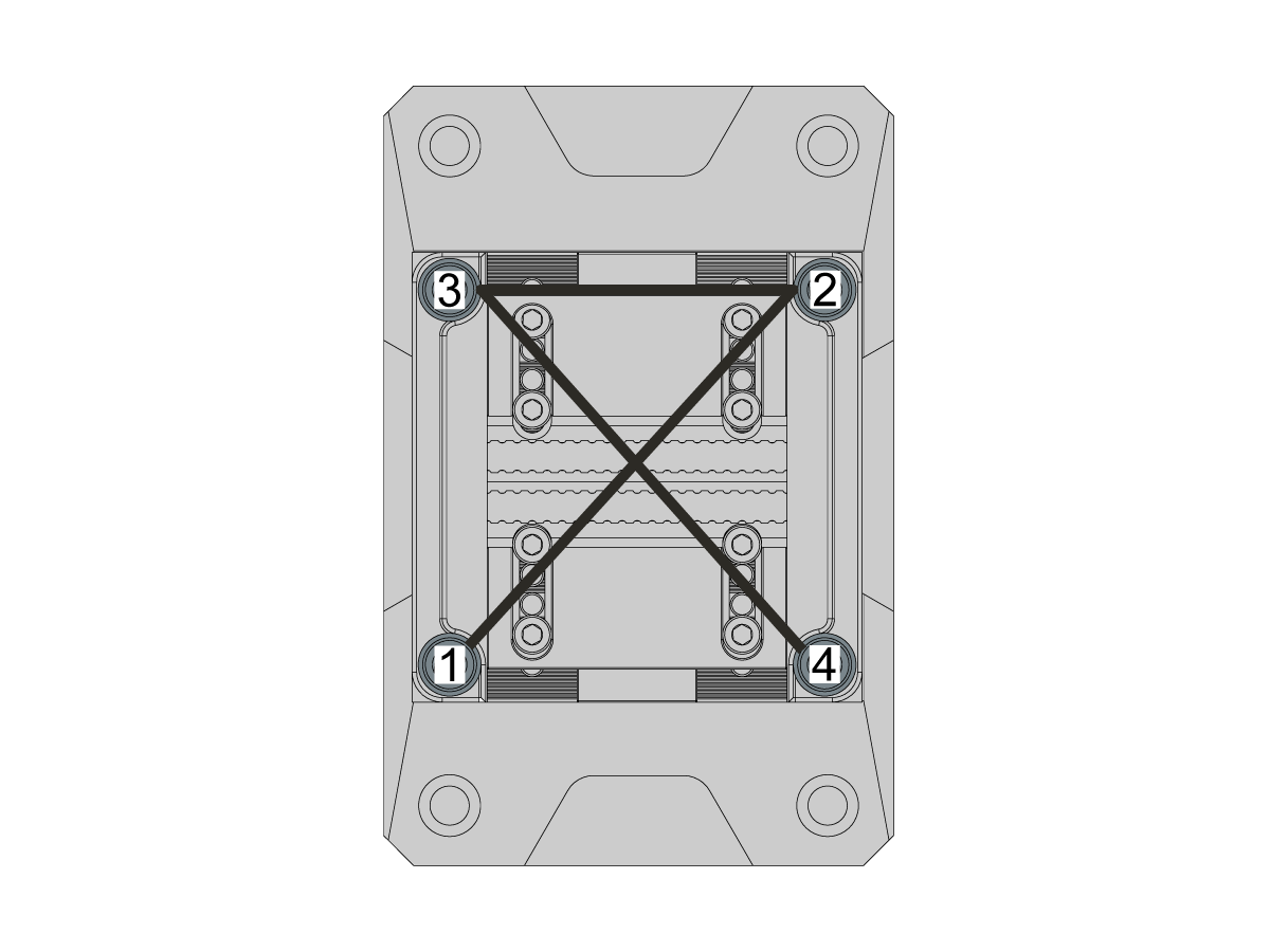

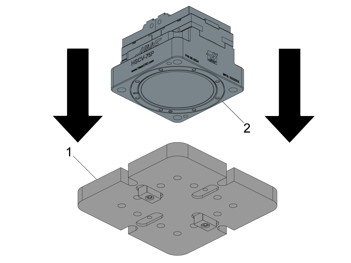

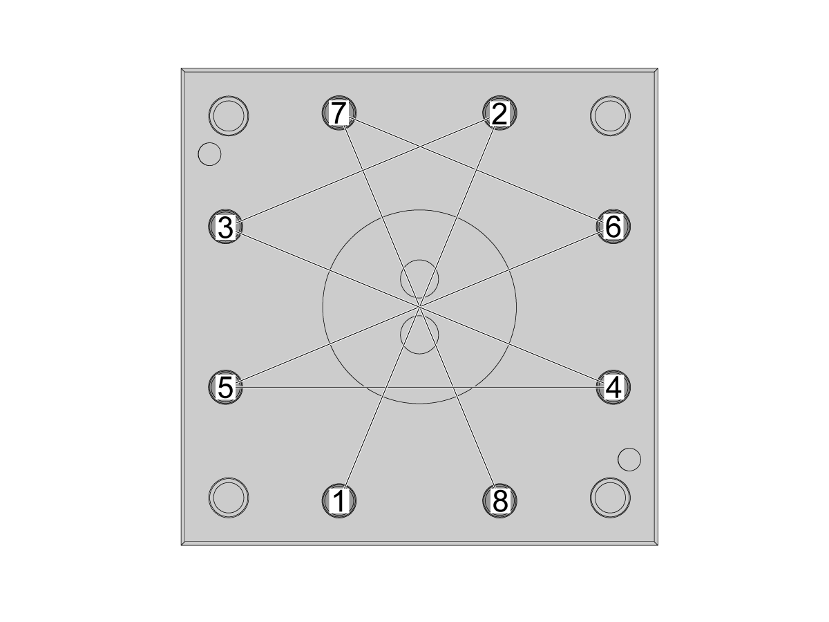

Torque the bottom bolts [1] through [8] in a star pattern to ensure even clamping on the o-rings.
6
Torque the top bolts [1] through [4] in a star pattern.
VMC (75) mm

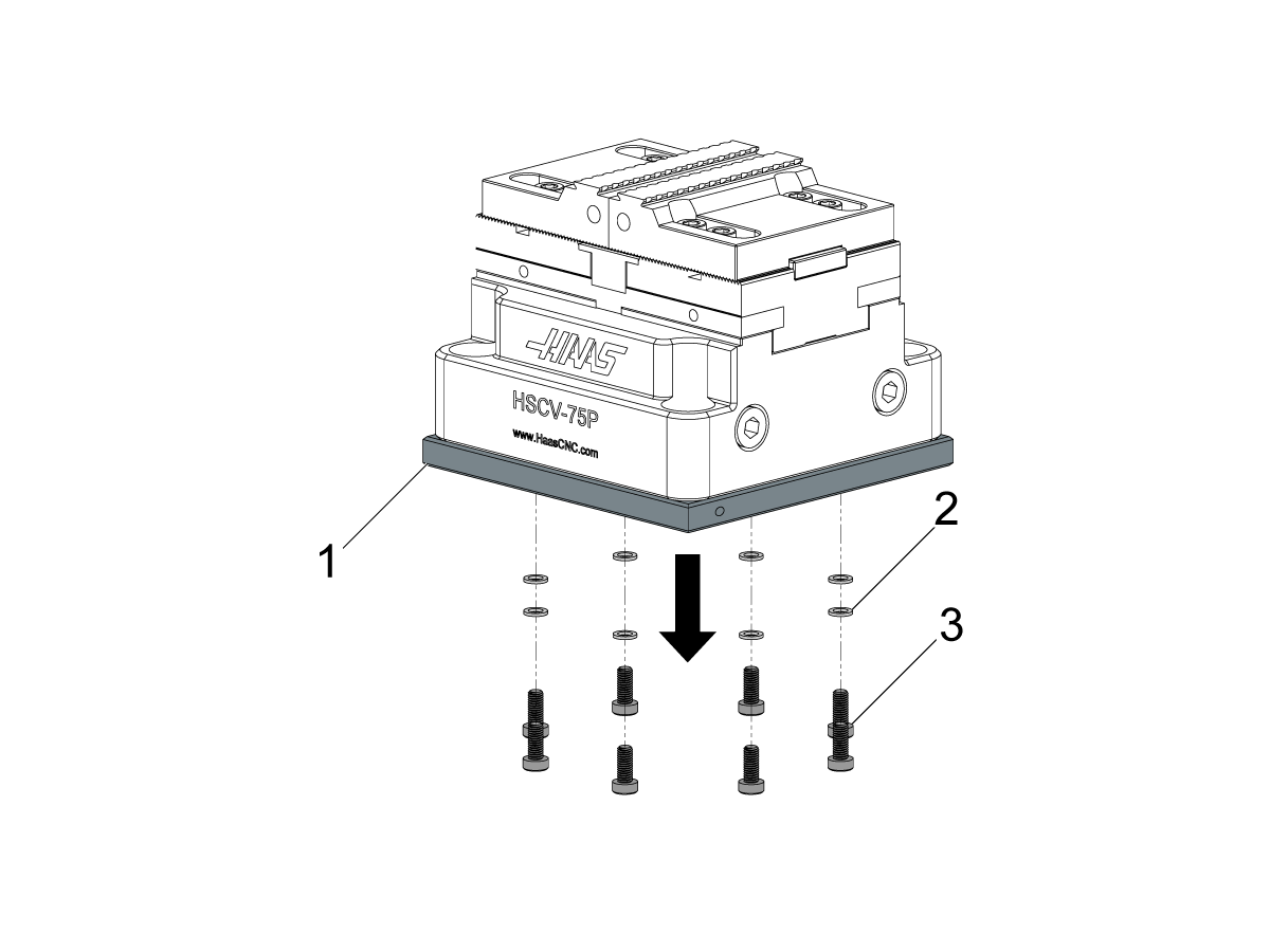

Remove the bottom bolts [3] then the top bolts [2] to seperate the top the vise from the base plate [1].
Remove and replace the o-ring [1] and ensure that the vise plug [2] is properly seated into the vise body.
Attach the vise [2] with the base plate [1].
Rotary (75) mm
Remove the bottom bolts [3] and washers [2] to seperate the top the vise from the spacer plate [1].
Note : Replace washers.
Assembly the vise to the spacer plate by installing the bottom bolts [3] and washers [2].

Using the fittings provided from the installation kit install the two 1/4 NPT Female  x 1/4 NPT Male to the 3 - Jaw Air Chuck [1].
Install the two 90-degree 1/4 NPT Male x 1/4 NPT Male to the two female fittings [2].
Remove the current 1/4 inch fittings on the programmable air manifold.
Note: When removing the original fittings, make sure to note which port is for clamping and which is for unclamping, as this information will be needed in the next step.
Using the two 1/4 NPT Male x 1/4 NPT male fittings install them to the programmable air manifold [1].
6
Using the one of the hoses provided in the kit, route the 1/4" female-ended hose from the air manifold to the unclamp fitting on the air chuck [1].
Use the remaining hose provided in the kit, and route the 1/4" female-ended hose from the air manifold to the clamp fitting on the air chuck [2].
Note: Use the Rotary Cable Management Kit to secure excess hoses and prevent them from hanging loosely inside the machine. Refer to the Rotary Cable Management Installation Guide for more information.

Before enabling the vise press [SETTING], find Setting 276 and make sure the value is 15.
Press [E-Stop]
