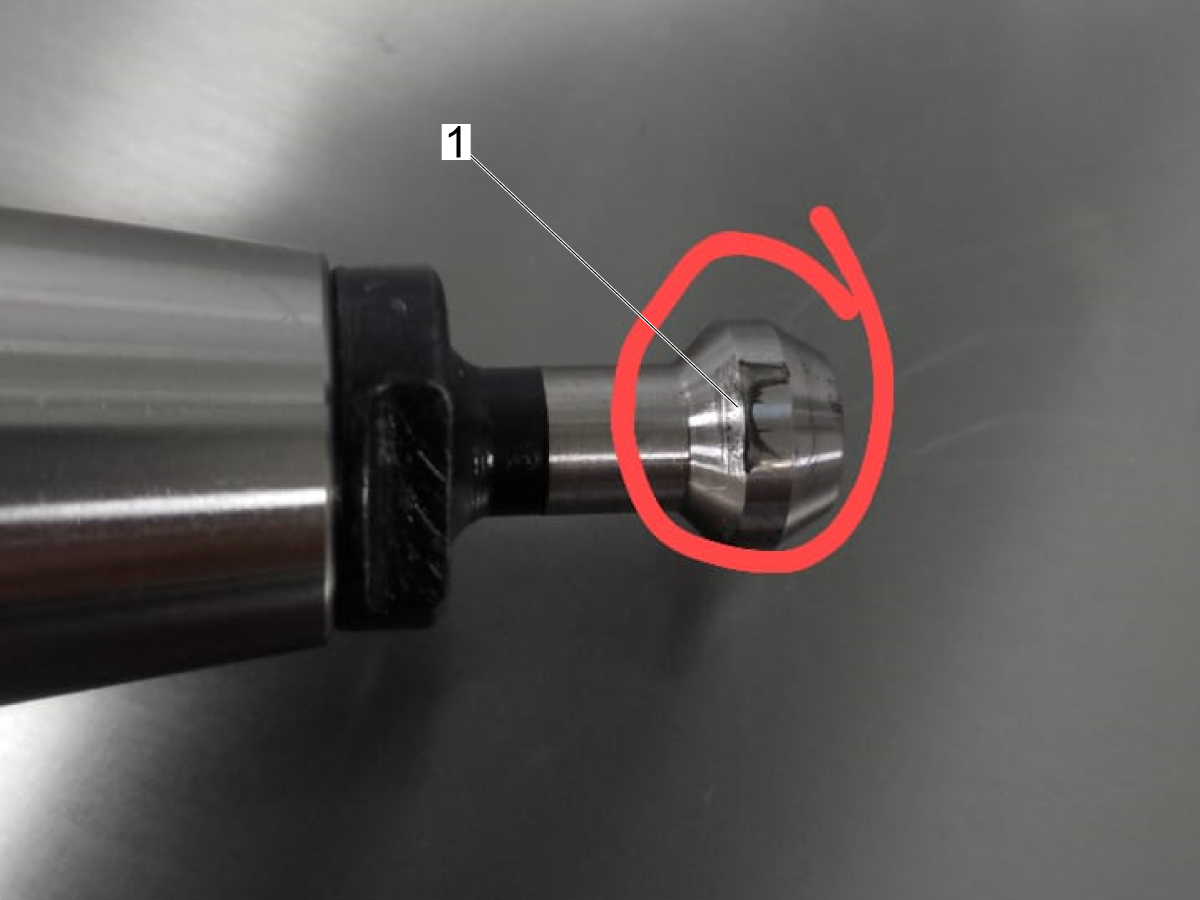

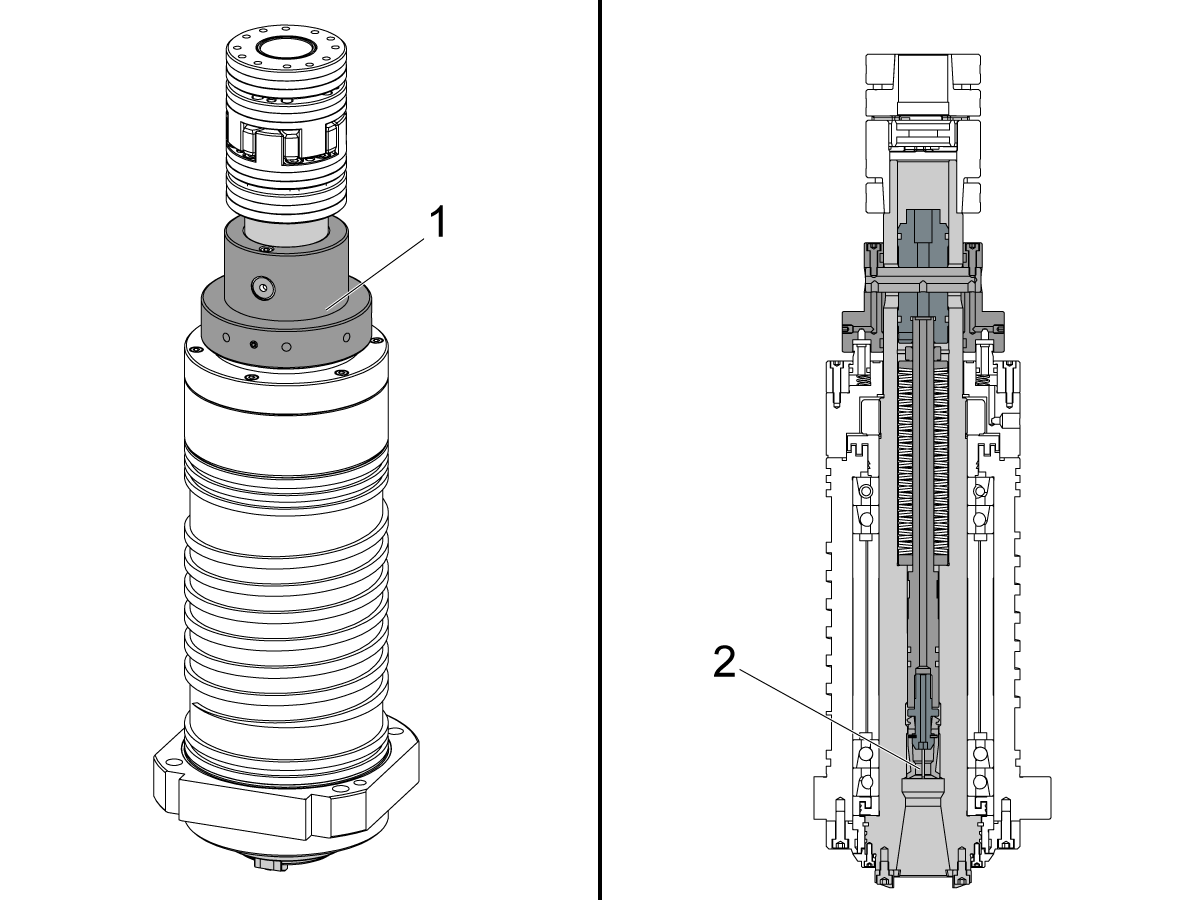

DC-Series machines have an inline spindle for both 30-Taper and 40-Taper machines.
The spindles have an integrated drawbar that is released mechanically by a rocker arm that presses on a guide release [1].
When the guide release is pressed down, the drawbar is depressed so that collet fingers [2] can move down which allows them to spread apart as the tool enters the spindle.
The drawbar springs then pull the collet fingers back up forcing them to grab on the retention knob on the pullstud.
Note: The drawbar is integrated into the spindle and is not serviceable. If there is an issue with the drawbar then the spindle will need to be replaced.

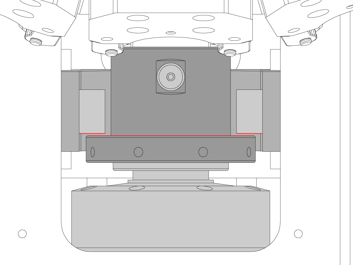

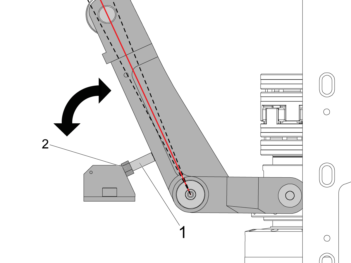

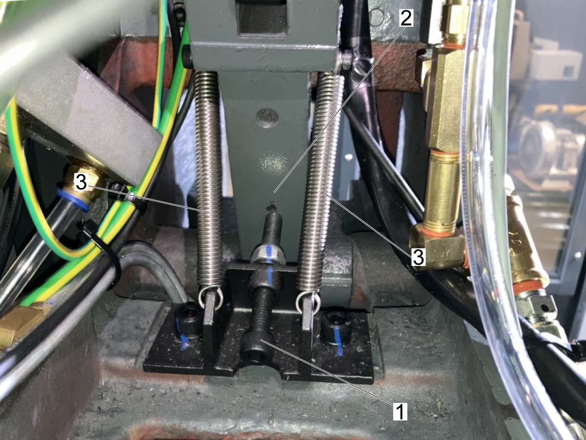

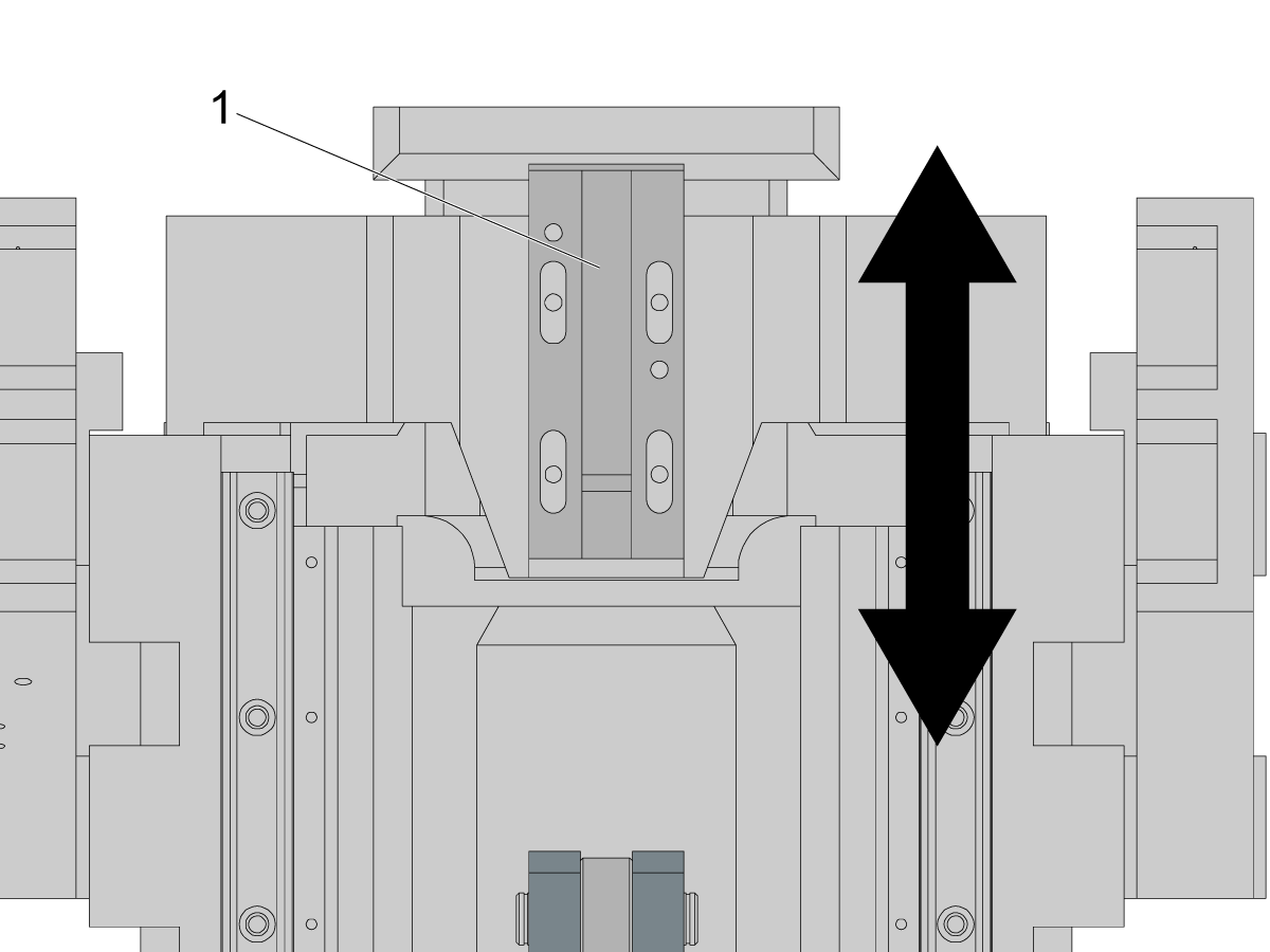

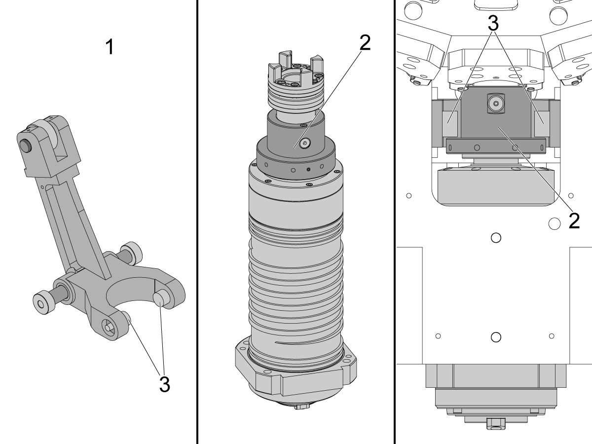

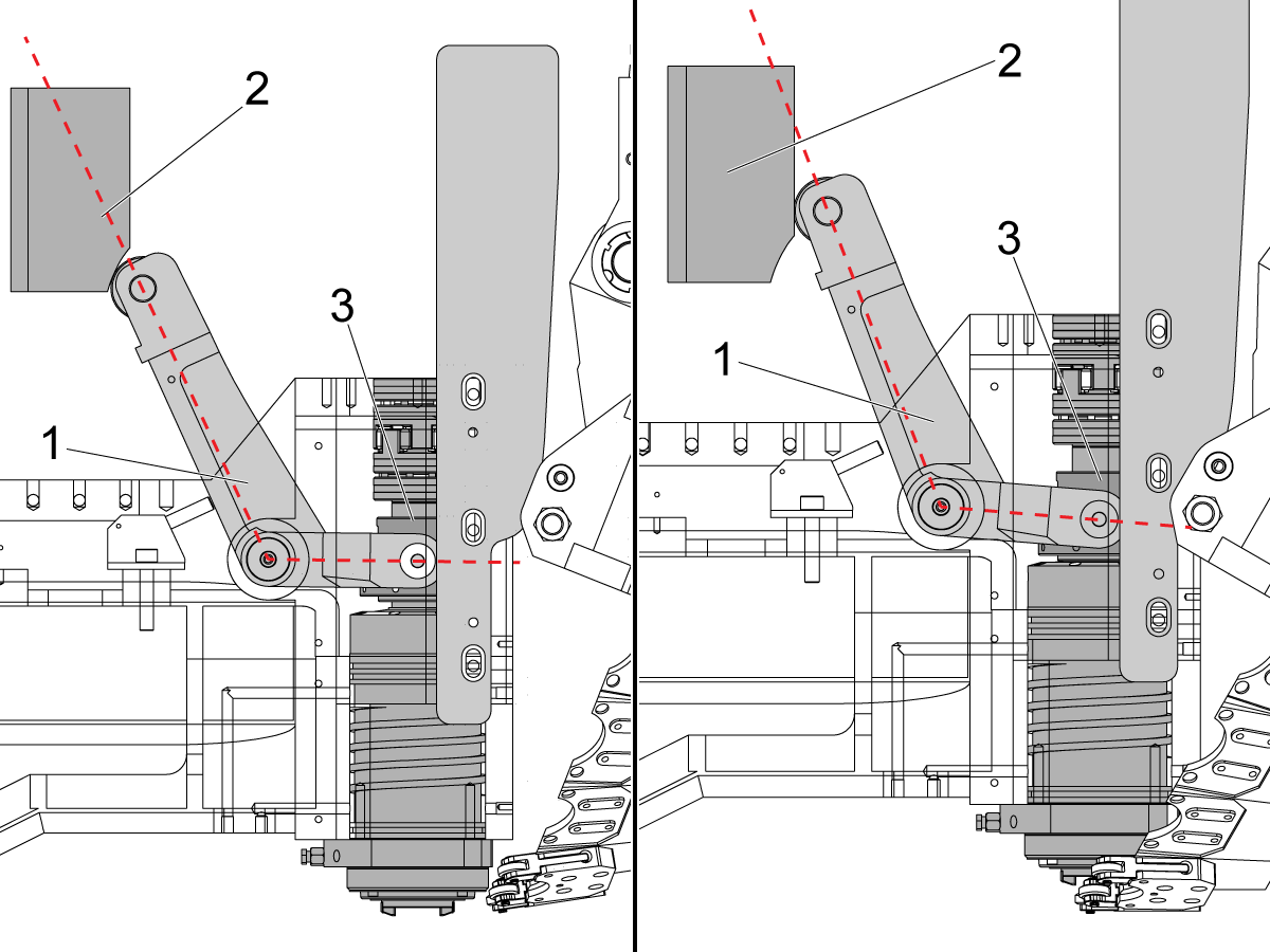

Rocker Arm to Spindle Alignment
The drawbar on DC-series machines is mechanically actuated by a rocker arm [1] that pushes on the spindle guide release [2].
The rocker arm needs to be aligned to the guide release in order for the drawbar to be fully actuated during tool changes.
When the spindle head is at the bottom of travel near the table, there should be a gap between the roller bearings [3] of the rocker arm and the guide release [2].
Note: The image on the right shows the front view of what the spindle / rocker arm look like when installed in the spindle head casting.
The gap between the roller bearings and the spindle guide release should be between 0.008"-0.012" (0.2mm-0.3mm).
Note: The gap should only be measured when there is no tool in the spindle. When there is a tool in the spindle, the gap will be much larger.
Measure the gap by using different size shims or feeler gauges and slide them in between the rocker arm bearings and the guide release. If an 0.008" shim slides easily, and a 0.012" shim is difficult to slide back and forth, then the gap is correct.
The gap can be adjusted by using the jacking screw [1] that controls the angle of the rocker arm [2]. The angle where the rocker arm is contacting the screw is the starting angle.
The springs [3] pull the rocker arm down so that the rocker arm returns to this starting angle quickly.
Note: The spindle head cover sheet metal will need to be removed to access this
Tightening the jacking screw [1] will decrease the gap between the rocker arm rollers and the spindle guide release.
Loosening the jacking screw [1] will increase the gap.
After making adjustments to the screw, check the gap using the feeler gauges / shims. Once the gap is correct, tighten the jam nut [2] while keeping the screw in the same position.
Once the jam nut is tight, verify that the gap is still in the 0.008" - 0.012" (0.2mm -0.3mm) range.
Note: The spindle head casting is not shown in this image so that the rocker arm and jacking screw can clearly be seen.
Drawbar Unclamp Positioning
If the drawbar does not fully release as the tool holder is being transferred between the carousel and the spindle, there could be damage shown on the pullstuds [1] of the tools.
Damage on the pullstud similar to the image could be a result of the drawbar unclamp position being set in the wrong spot in relation to the spindle / tool carousel.
This section shows how the drawbar is unclamped, and how to adjust the Z-axis position where the drawbar unclamps.
The drawbar releasing is caused by the rocker arm shown in the section above. The rocker arm [1] is actuated mechanically by contacting the striker plate [2] that is fixed to the column.
As the spindle head travels up (Z-axis positive direction) the rocker arm roller bearing begins to contact the striker plate, which causes the other end of the rocker arm to push down on the spindle guide release [3].
Once the rocker arm engages the striker plate the angle of the rocker arm is changed as shown in the images.
Note: The column is not shown in the image so that the striker plate can clearly be seen in relation to the rocker arm.
The unclamping position is set relative to where the carousel tool pocket [1] begins to engage the tool holder [2] that is in the spindle.
The drawbar should begin to pushout slightly before the carousel pocket is in line with the spindle.
Below are some potential effects for having the drawbar unclamp position set to the incorrect spot.
  1. If the drawbar pushes out too much before the carousel pocket is grabbing the tool holder, tools will likely be dropped from the spindle during tool changes.
  2. If the drawbar does not push out before the carousel is grabbing the tool holder, the tool will be forced out of the spindle which can result in pullstuds or damaged tool pockets on the carousel.
If you notice any of these symptoms on the machine, the position of the stroker plate may need to be adjusted.
If Drawbar pushes out too much before pocket grabs tool:
  • Make small adjustment to move the striker plate up
If Drawbar doesn't push out enough before the pocket grabs tool:
  • Make small adjustments to move the striker plate down
Once any adjustments have been made, make sure to torque down the bolts to hold the striker plate in position.
