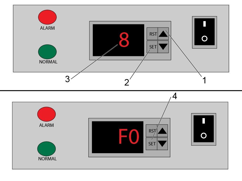

The spindle chiller uses a parameter based system to determine how much cooling needs to be done. These parameters are set in the factory and should not be altered. If the Haas control is showing alarm 9003 - Low Spindle Coolant Chiller Oil Flow then refer to the troubleshooting section of this chapter before altering parameter values.
To view the parameter values on the spindle chiller, follow these steps:
  1. Press and hold the [UP] arrow [1] on the chiller control.
  2. Press and hold the [SET] button [2] while still holding the up arrow. There needs to be about a half second delay between pressing the [UP] arrow and the [SET] button in order to access the parameters.
  3. Hold these buttons until the display on the chiller shows a "0". Press the arrow keys untill the display shows "8" [3] as shown in the top image and then press the [SET] button to navigate into the parameters page.
  4. Once in the parameters page, you can press the arrow keys to navigate to diferent paramters. Each parameter has a value that can be accessed by pressing the [SET] button.

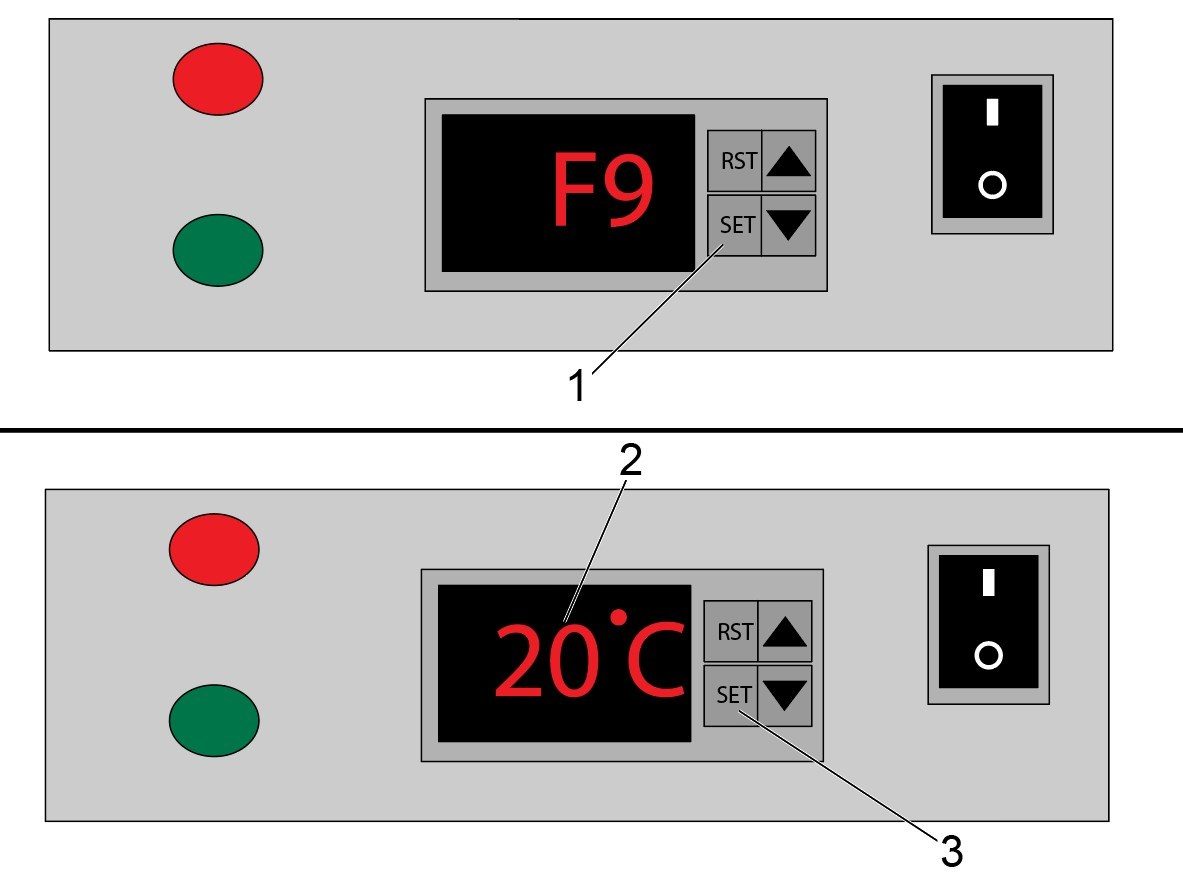

This image shows and example of accessing parameters and setting the values.
After entering the parameters page and navigating to F9 using the arrow keys, press the [SET] button [1] to view the current parameter value. The value will appear on the display [2] and the value can be changed using the arrows. To set the new value press the [SET] button [3] again.
Note: Parameter values should not be changed from their factory set values. The parameter F9 should be set to 20 degrees celsius.

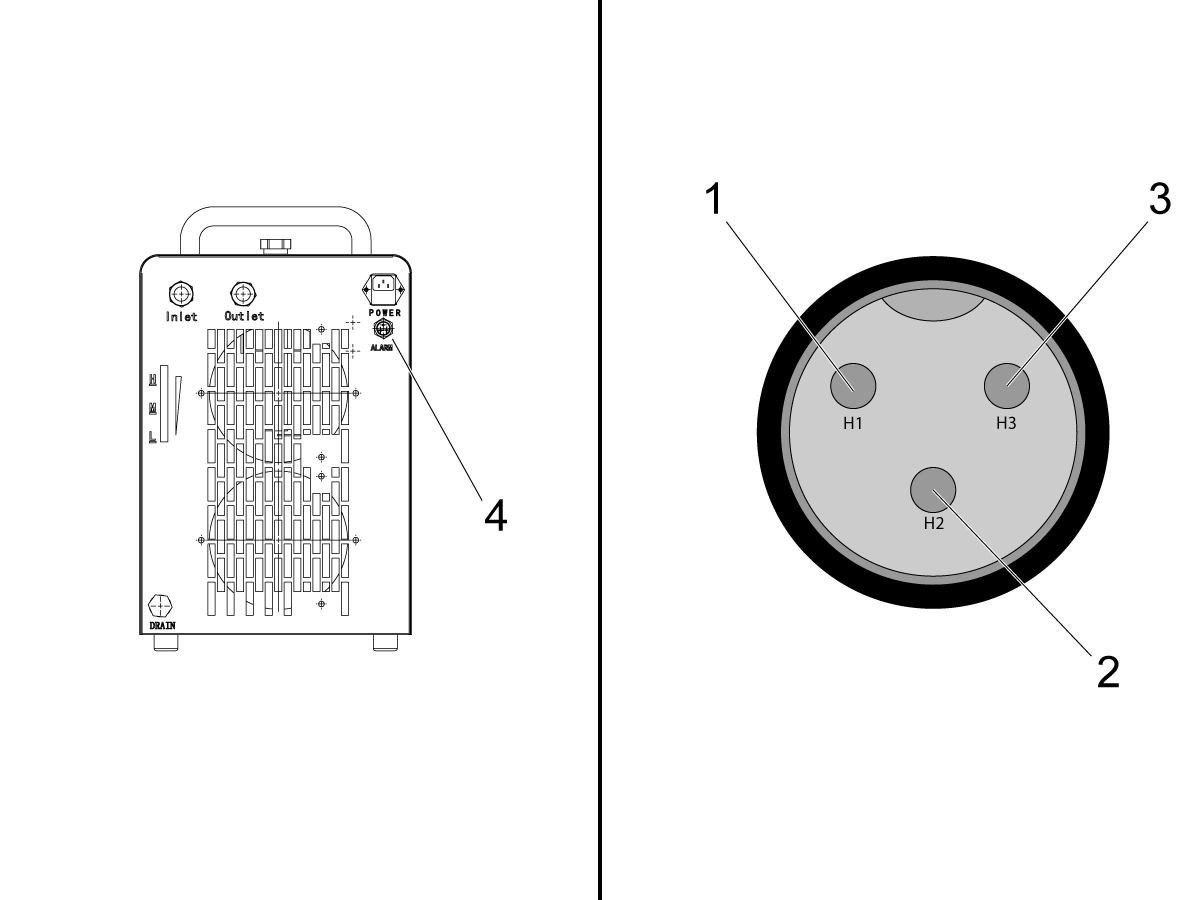

DC Spindle Chiller Flow Alarm Output
To check for continuity between 2 pins on the alarm connector, remove the spindle chiller connector to the alarm cable [4]. The connector on the spindle chiller [4] has 3 pins as shown in the image.
If there is no alarm being outputted by the spindle chiller, then there will be between pin H1 [1] and H3 [2].
Take a volt meter and set it to resistance mode.
Then touch one lead to pin H1 [1] and the other lead to pin H3 [3]. The volt meter display will show near zero resistance if there is continuity.
If there is no continuity between H1 and H2, check if there is continuity between H1 [1] and H2 [2]. Continuity between H1 and H2 indicates an alarm is being outputted by the spindle chiller.
If this is the case, continue troubleshooting to determine the source of the alarm.

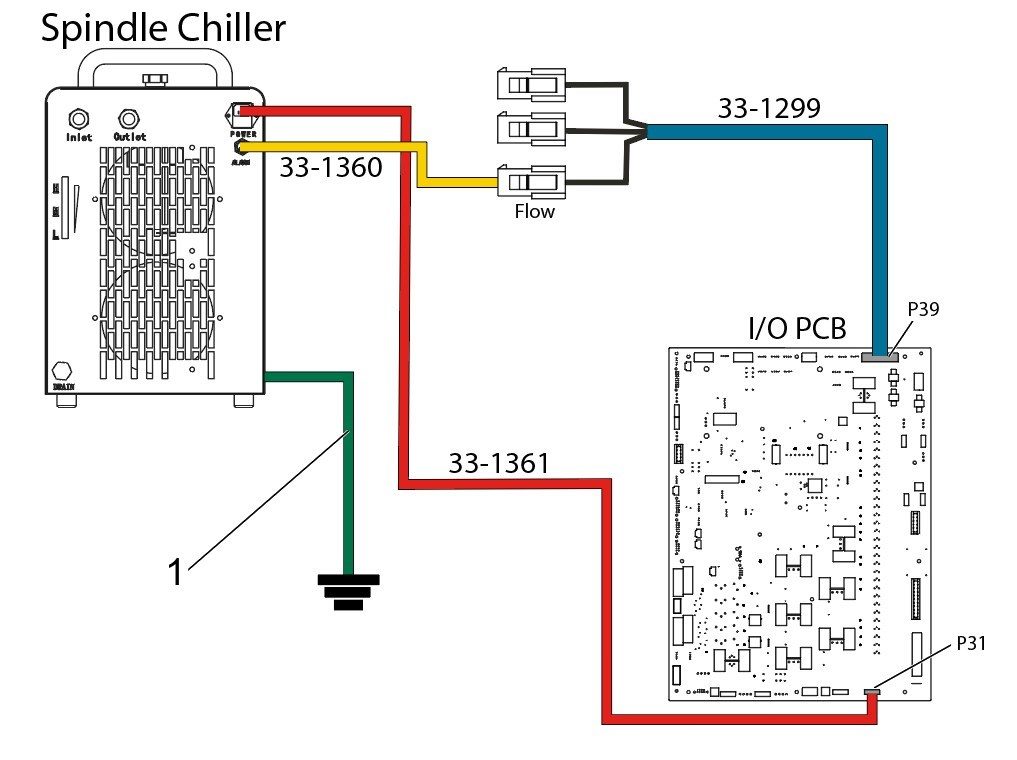

Spindle Chiller Electrical Schematic
There are 3 cables that go from the spindle chiller to the control cabinet:
  • Ground cable [1] - From spindle chiller to control cabinet chassis
  • Flow alarm cable 33-1360 - From alarm port to cable 33-1299 which is connected to P39 on the I/O PCB.
  • Power cable 33-1361 - From power socket to P31 on the I/O PCB.
Important: The alarm cable from the spindle chiller needs to be connected to the SPINDL FLOW connector of 33-1299. This cable has 3 connectors, only the connector labeled SPINDL FLOW should be used.
