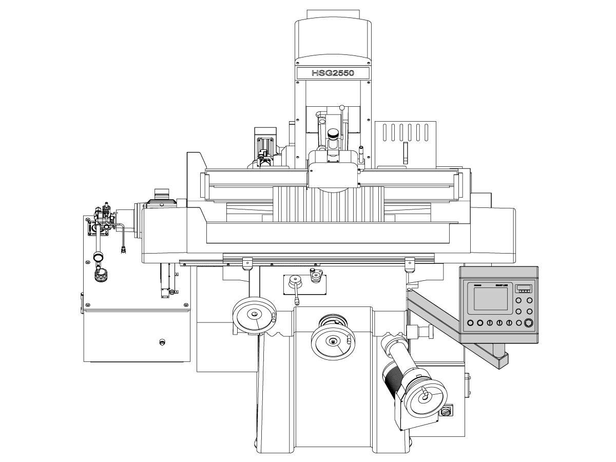

This chapter will provide details on how to operate the surface grinder. It will cover how to navigate the main control as well as other basic operation details.
Main Control
Number Type Name
1 Screen Main screen
2 Dials Electro-magnetic chuck voltage
3 Y-axis intermittent feed
4 Switches Work lamp on/off
5 Coolant pump on/off
6 Electro-magnetic chuck on/off
7 Buttons Power up
8 E-Stop
9 Z-axis rapid up
10 Z-axis rapid down
11 Y-axis rapid forward
12 Y-axis rapid backwards
13 Display Magnetic chuck display
