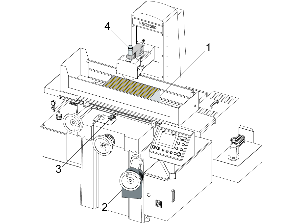

Haas Surface Grinder (HSG) - Troubleshooting Guide
Components
Haas Surface Grinder :
  1. Magnetic chuck
  2. Z-axis motor
  3. X-axis switch
  4. Dresser
Grinding Troubleshooting

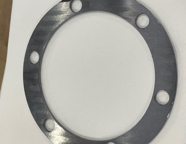

Dresser Alignment
This pattern is due to the dresser not being square with the grinding wheel. When the grinding wheel is dressed it becomes tapered which causes uneven contact to the work piece.
