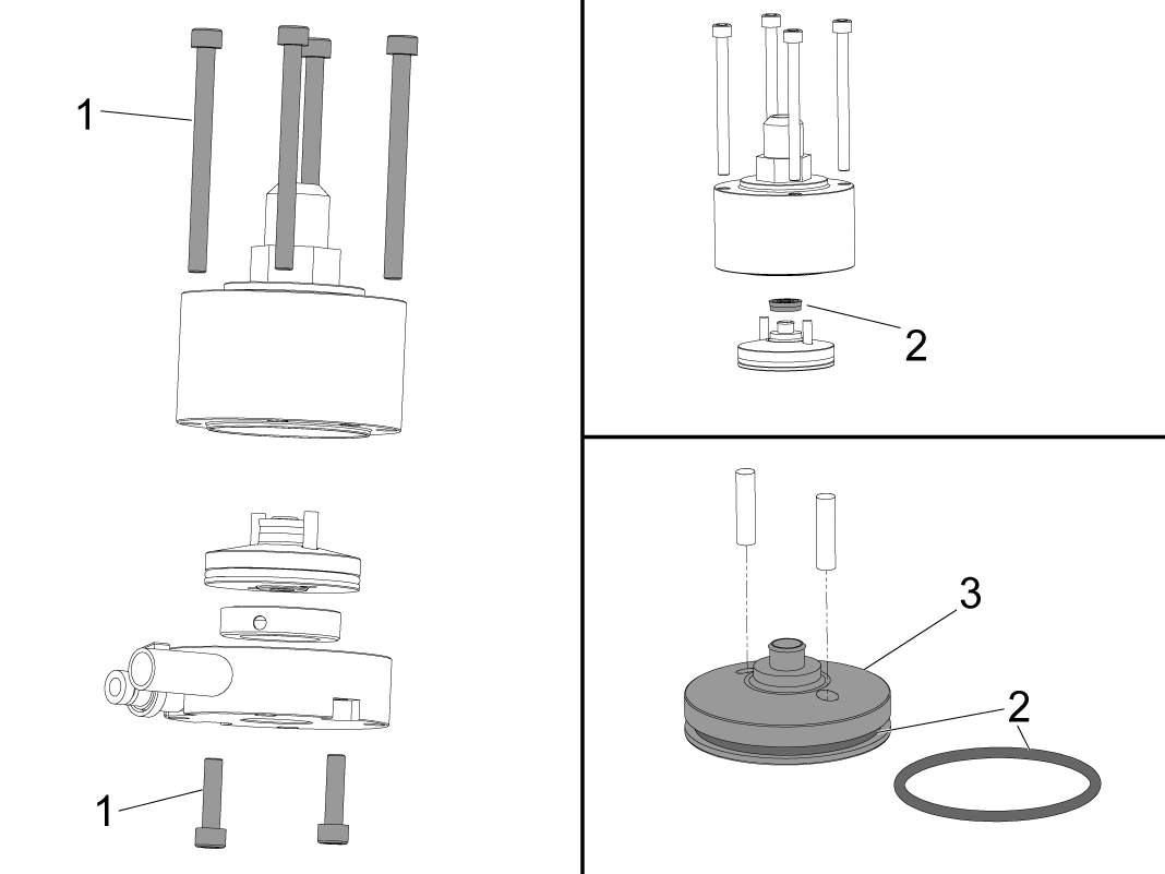

This kit can be used to replace the piston cup seal and piston o-ring on all compensating (springless) TSC union assemblies. Replace the seals if you know or suspect them to be worn, torn, or damaged.
Replacement
Remove the TSC union and remove the 8-32 socket-head cap screws that hold the union together [1]. Use a Philips screwdriver or allen wrench to gently push the piston out of the housing.
Remove the cup seal and the O-ring [2]. Clean the piston [3] to remove coolant, grease, and/or debris. Lightly grease the new O-ring and cup seal [2] with silicone grease and carefully install them onto the piston.
Before re-inserting the piston into the housing, clean the inside of the housing. Apply generous silicone grease around the large OD of the piston [3] and on the large tapered surface of the piston. Align the anti-rotation pins and reinsert the piston into the housing.

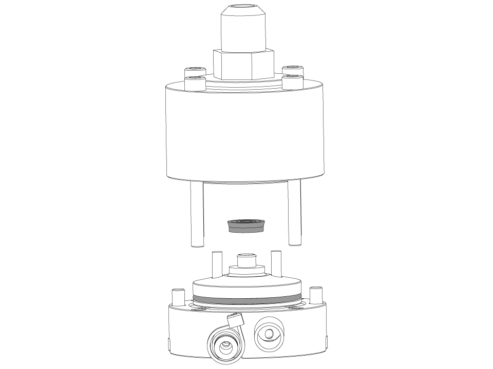

40-Taper - Inline - Compensating TSC Union - Replacement - VMC
Assemble the rest of the union and reinstall it onto the machine following the latest TSC union installation procedures.
