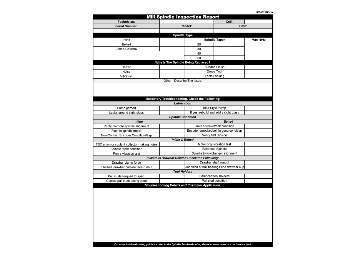

Fill out the Mill Spindle Inspection Report with the information that applies to the troubleshooting of the failed spindle and return it in the box with the failed spindle.  If the document does not come inside the box of the new spindle download it here.
