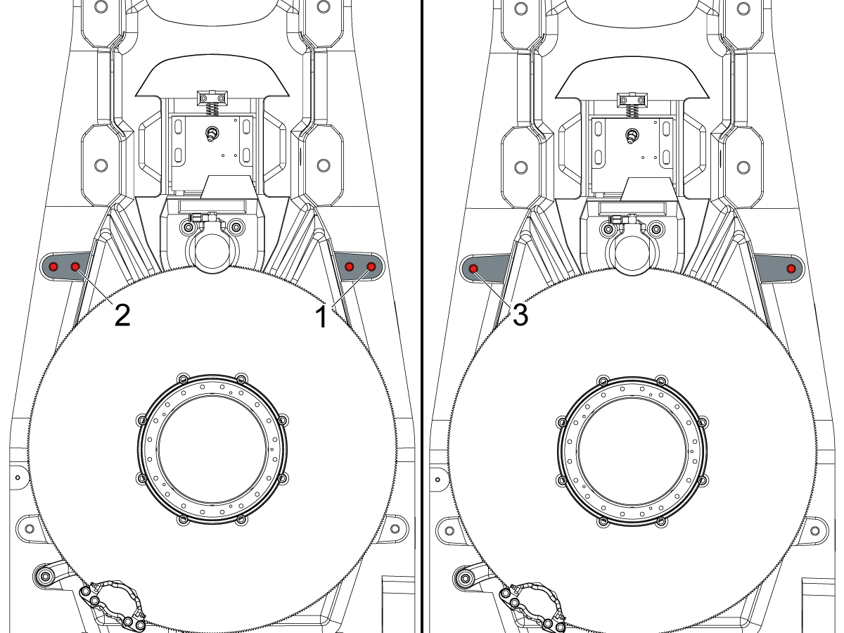

Spindle Head Casting Identification
Current production spindle head casting have provision for mounting the stiffening brace [2] as well as the secondary chuck option [1] but older machines only have the secondary chuck provision [3].

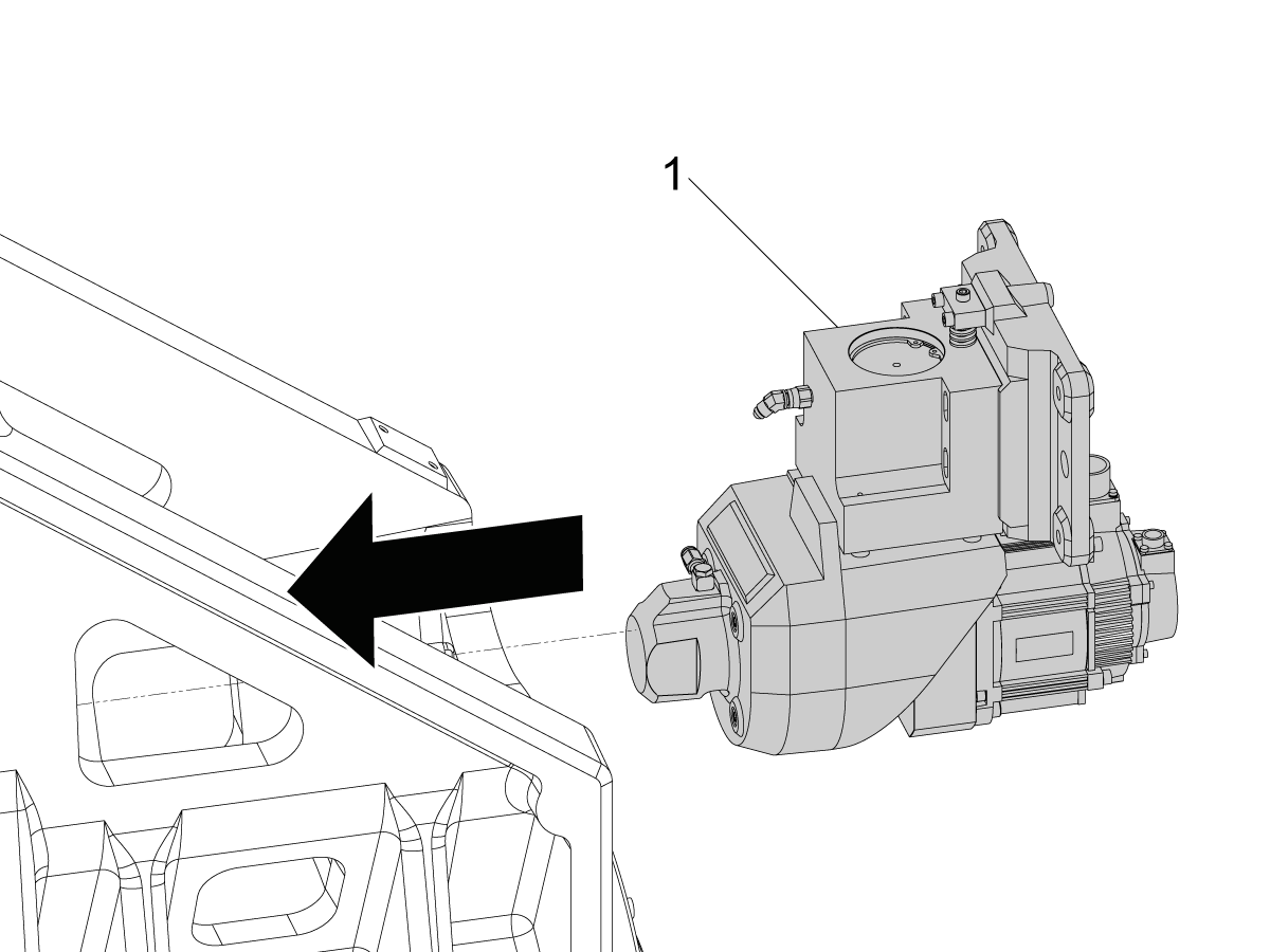

Power off the machine and ensure that the HPU gauges read 0 psi.

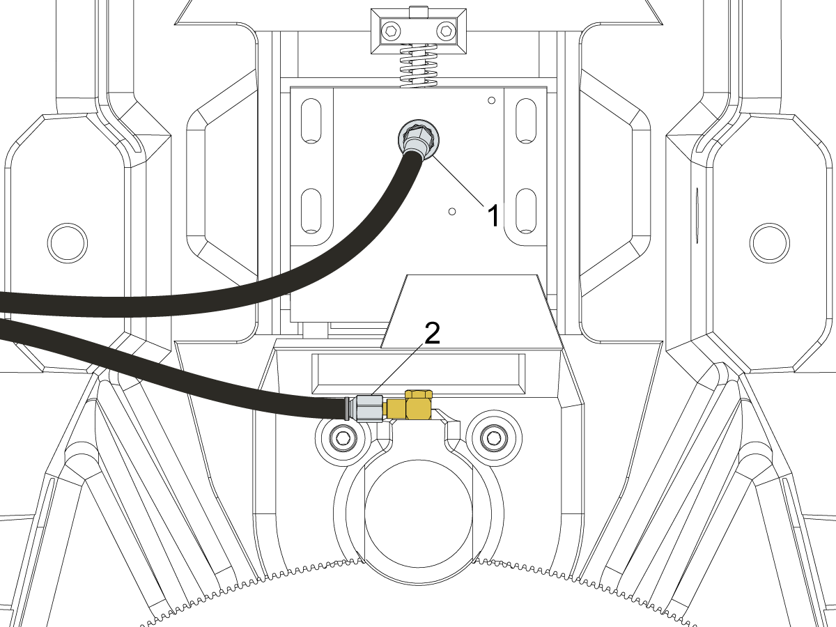

Disconnect the hydraulic line [1] and lubrication line [2] from the C-axis assembly.

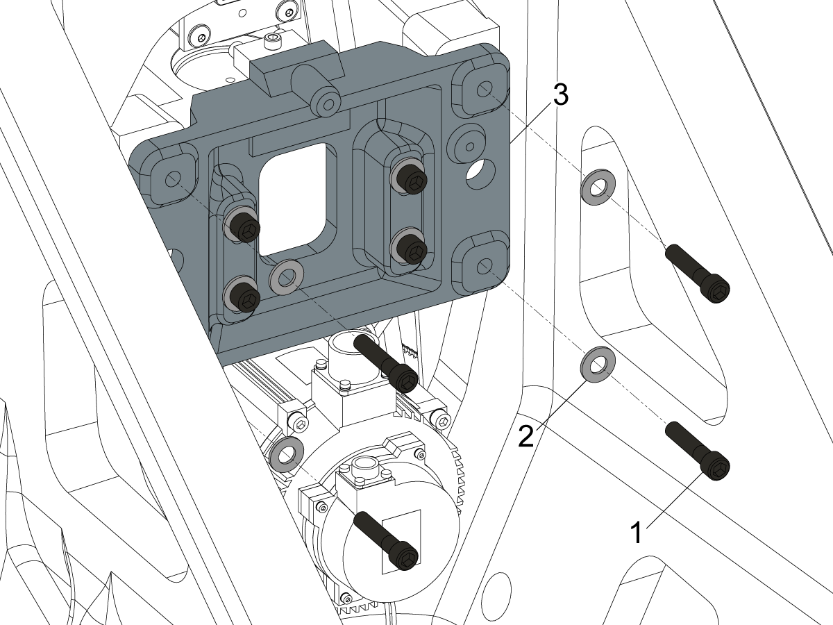

Remove hardware [1] and [2] from the C-axis mount [3].
Note : Ensure that the C-axis motor power and encoder cables are disconnected.

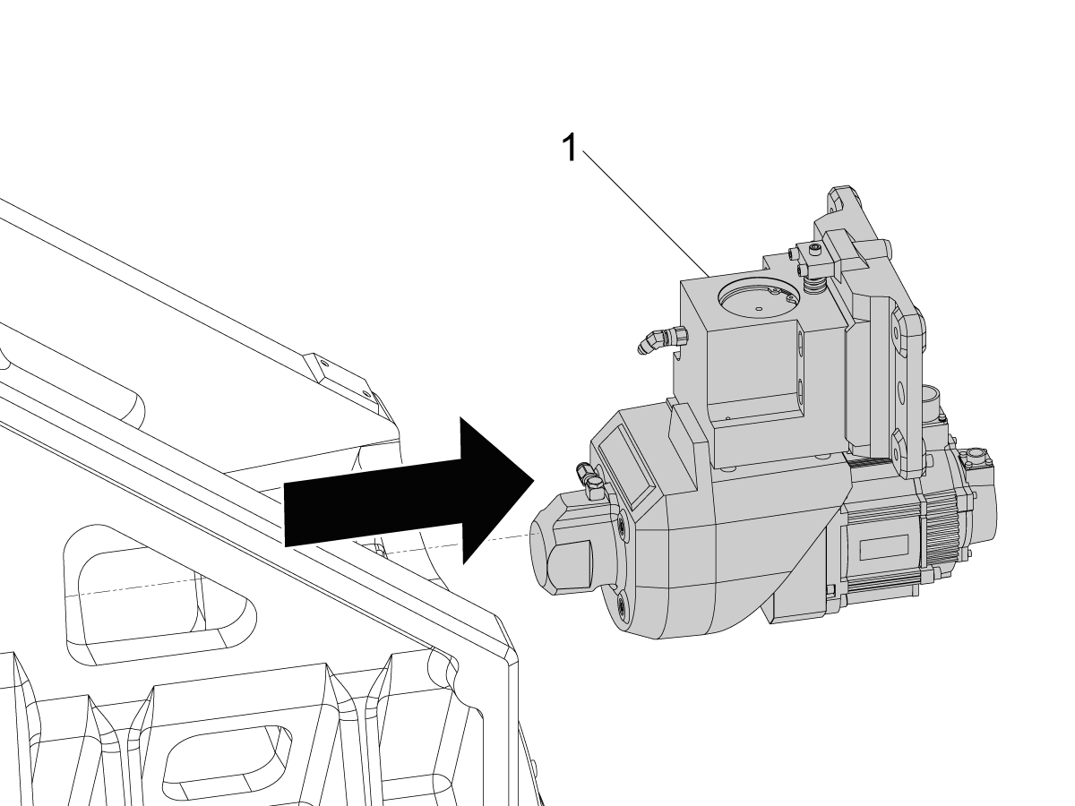

Completely remove the C-axis assembly as illustrated.
Install the C-axis assembly and torque the hardware to specification.

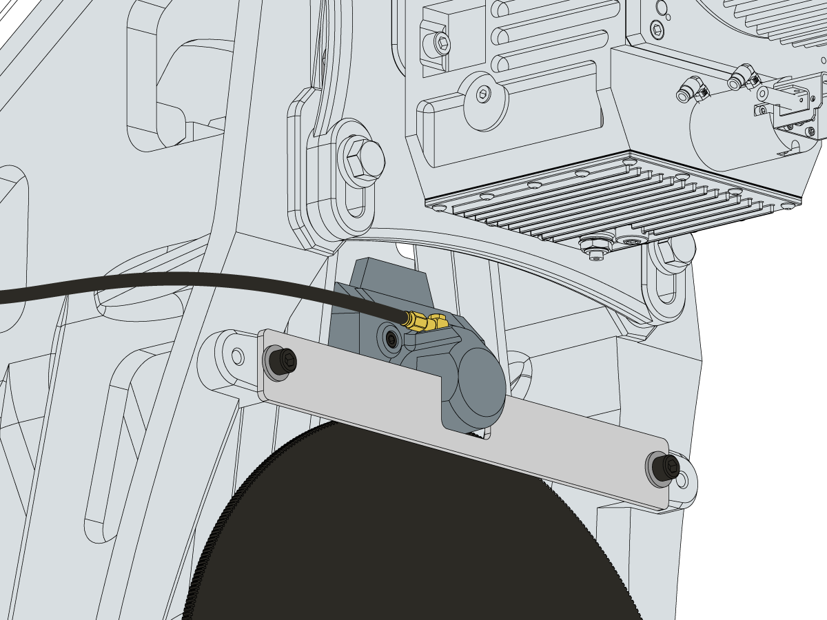

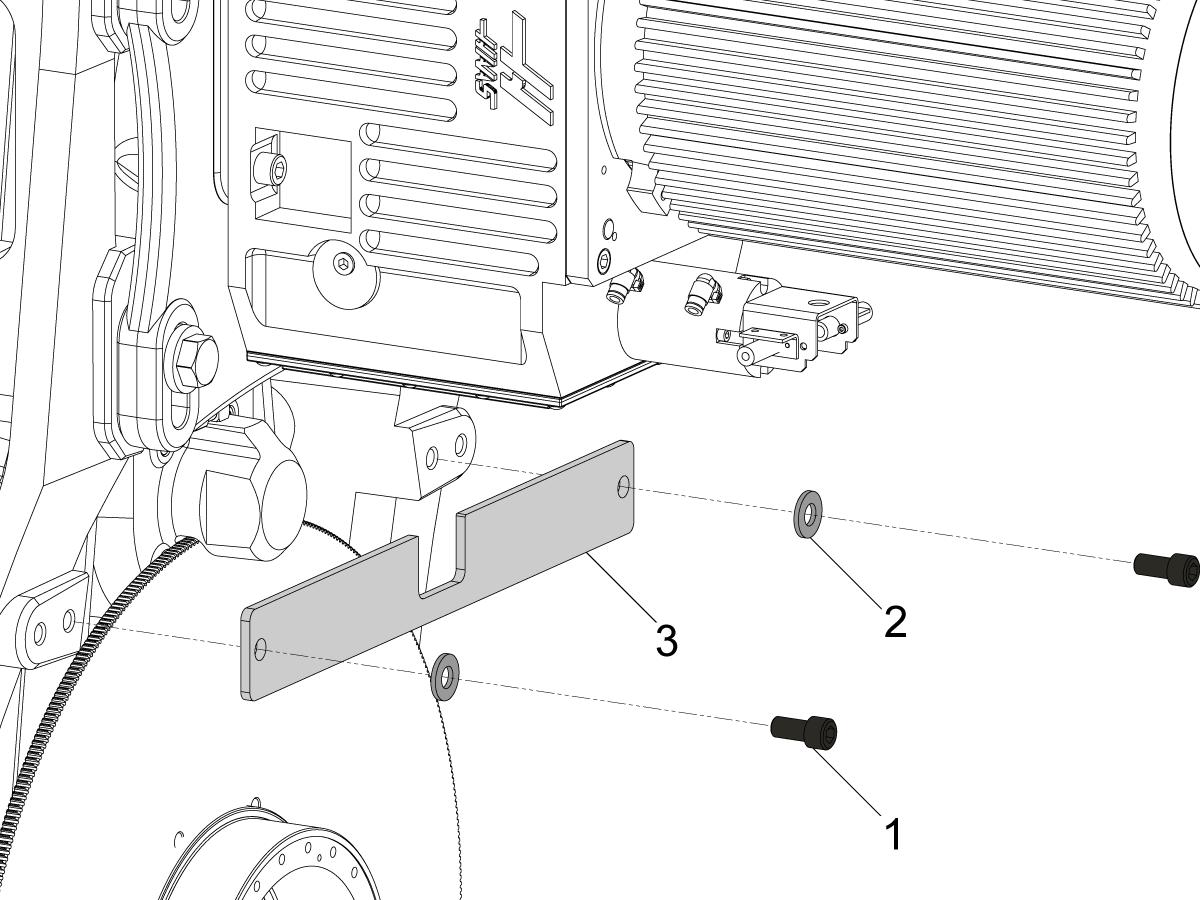

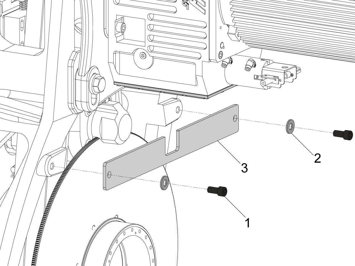

Install the C-axis stiffening brace.

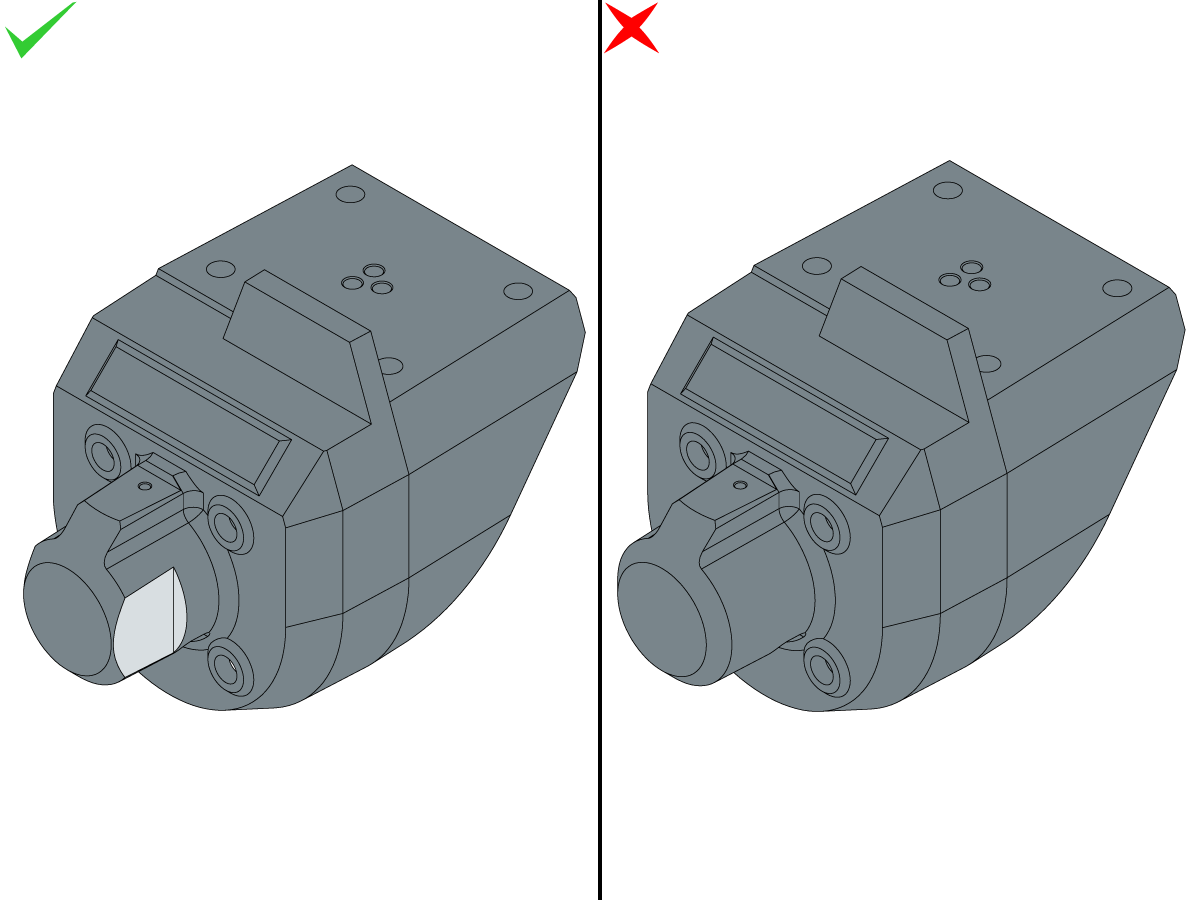

Important : The illustrated brace cannot be installed on a secondary chuck machine
6
Install the C-axis brace.
