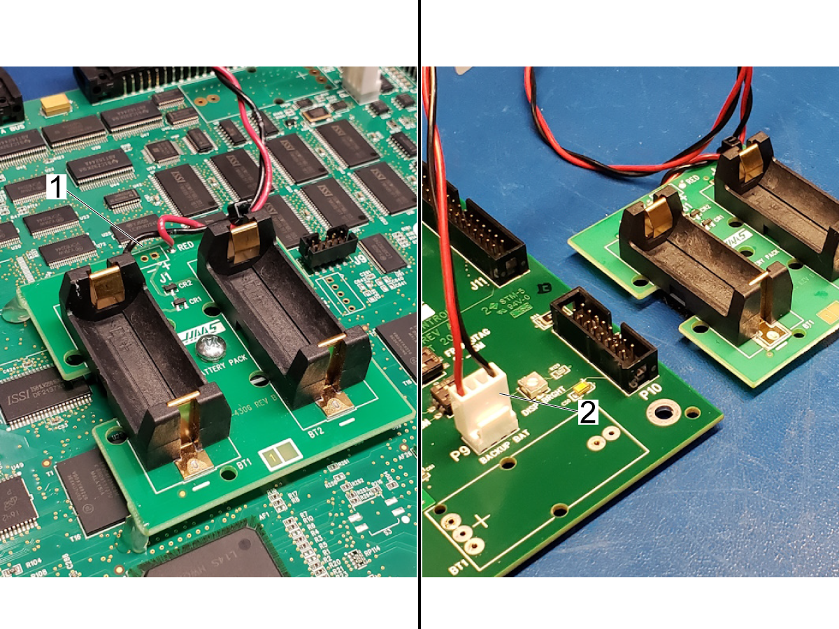

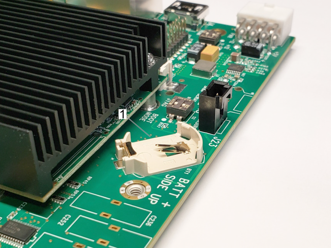

For boards that have a coin battery holder [1].
These previously came with 69-0004 Rechargeable Lithium Coin Battery installed.
Please refer to the next step for the specifications to source the battery.

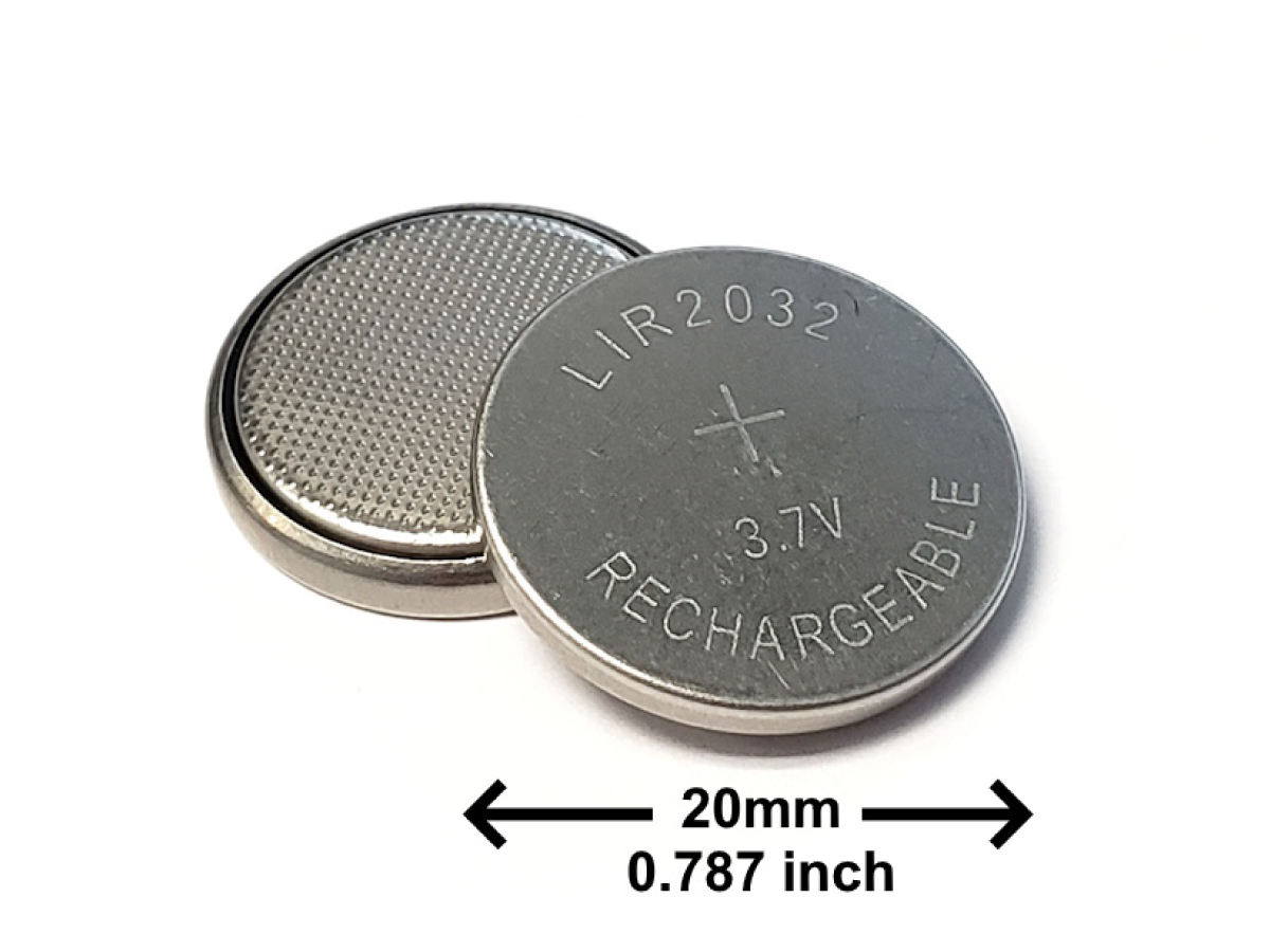

Specifications for 69-0004 Rechargeable Lithium Coin Battery:
  • 3.7V Rechargeable Lithium-Ion Coin Battery
  • Type LIR2032
  • 30mAh capacity or higher capacity
For boards that have the dual battery board installed to the board [1] or has it externally installed to the board [2].
These previously came with 69-1035 Lithium Battery BR-2/3A installed.
