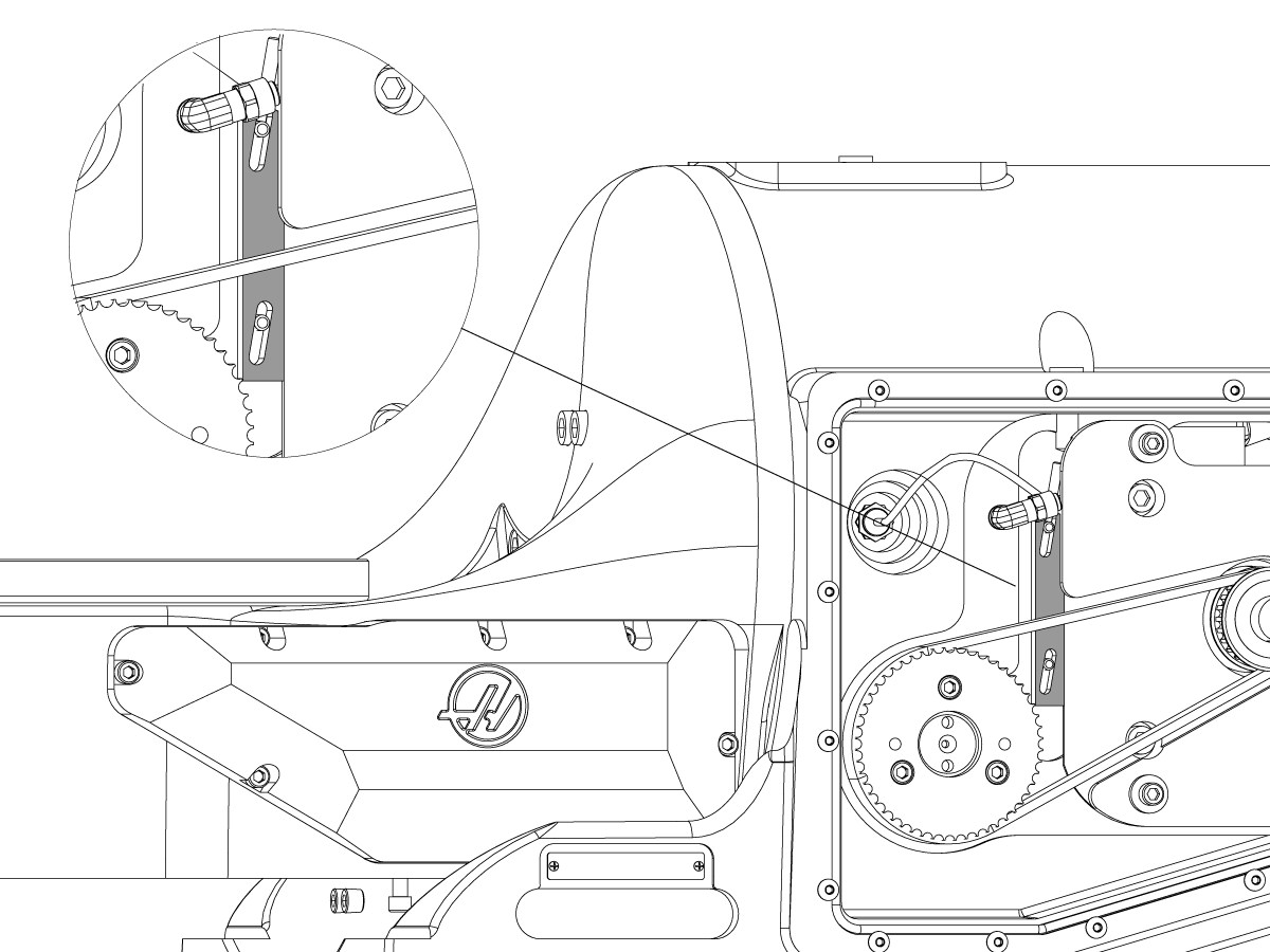

HRT / TRT Inspection
Adjustments
The face runout, face I.D. runout, worm play, backlash between worm and gear, and the popout are set at the factory and are not field serviceable. If any of these specifications are out of tolerance, contact your Haas Factory Outlet.
Maintenance Item Interval
Platter Face Runout
To check the platter runout:
1. Mount an indicator to the body of the table.
2. Position the stylus on the face of the platter.
3. Index the table 360°.
The runout should be 0.0005" or less.
As needed
Platter I.D. runout.
To check the platter I.D. runout:
1. Mount the indicator to the table body.
2. Position the stylus on the platter through-hole.
Runout should be:
  • HRT160 - 210 = 0.0005"
  • HRT110, HRT310 = 0.001"
  • HRT450 - 600 = 0.0015"
As needed
Backlash
Backlash is the movement error caused by space between
the worm wheel gear and worm shaft when the worm gear changes direction.
Backlash is factory set to .0003/.0004.
The table below lists the maximum allowed backlash.
  • HRT160 = 0.0006
  • HRT210 = 0.0006
  • HRT310 = 0.0007
  • HRT450 = 0.0007
  • HRT600 = 0.0008
As needed

TRT Retest Procedure
Detach the side panel on the tilt casting to access the necessary components.
On an TRT Unit loosen the set screw.
The spacer can be pushed up to tighten the belt or down to loosen it.
Remove the under panel of the rotary casting to expose the motor spacer.
Remove the left side panel of the rotary casting to expose the belt [3].
Loosen the set screw located on the motor spacer. Slide the spacer to the left to decrease tension. Slide the spacer to the right to increase tension.
Torque down the set screw and retest by vibrating the belt.
HRT Retest Procedure
Remove the servo cable and the surrounding housing panels.
 Loosen the set screw.
On the opposite side of the setscrew, the spacer can be pushed either to right to allow the belt to be tightened or pulled to the left to loosen the belt.
