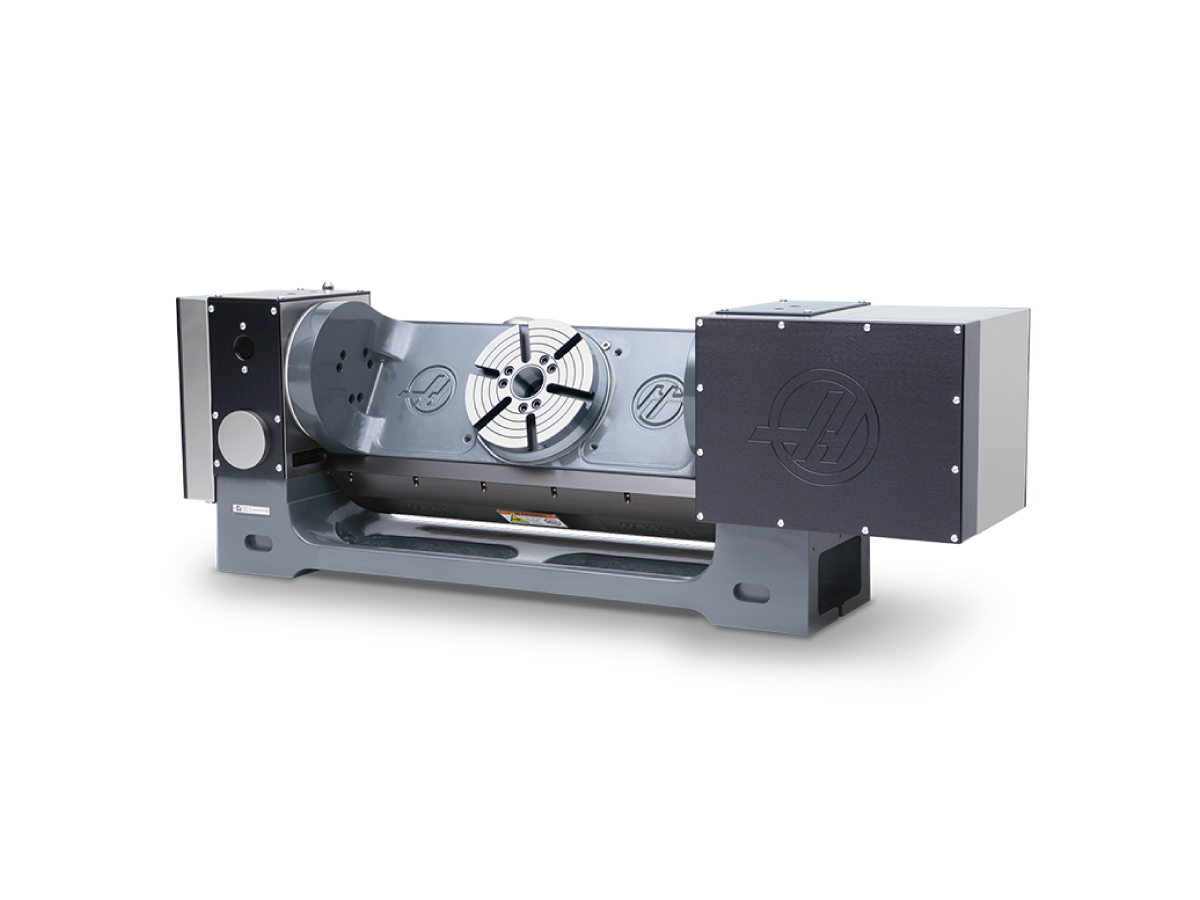

Rotary - TR/TRT/T5C - Lifting Instruction
Lift the rotary table with the lift rings as shown to prevent damage to the gear set. Attach an air supply to the rotary before you lift it. All rotary tables (HRT, TR, TRT, and T5C) use the 1/2-13 eyebolts. Haas Automation, Inc. does not supply lifting chains or straps for rotary products.
Warning: LIFTING A ROTARY WHILE NOT CONNECTED TO AIR MAY DAMAGE THE ROTARY.
If spreader bars are not available, eyebolts may be used as shown:
TR500SS
To lift the TR500SS, position your lifting mechanism above the center of gravity [1] to ensure the rotary is lifted uniformly.
Lift the machine from the eye bolts near the A frame [2] and the lifting bracket [4].
NOTE: Use straps [3] or something that won't damage the platter, as lifting it from this location will interfere with the platter.
TRT310 being lifted with two hooks.
Lifting TRT 160 and TRT 210
There are two ways to lift the TRT160 and TRT210.
1. Use the center hole on the top of the rotary. The center hole has 1/2-13 threads. Using this hole is similar to how the TRT100 is shown being lifted above. These two models will not come with the eye bolt for this hole.
2. Use the two holes beside the center hole. The two holes on the side have M8-1.25 threads. These rotaries can be lifted similarly to how the TRT310 is lifted in the image. These units will come with the eyebolts that fit in these holes. These eye bolts have an ID of 0.75 inches (19 mm).
TRT 310
Unlike the two smaller rotaries, the TRT310 has no central hole that can be used for lifting. Also, these two side holes are larger than on the smaller models being 1/2-13 threads with the eyes having an ID of 1-1/8 inch.
The TRT310 must be lifted using a sling with two hooks, as shown in the picture. A spreader bar is not needed.
The TRT310 weighs about 1000 pounds. Verify that appropriate lifting equipment is ready for installation.

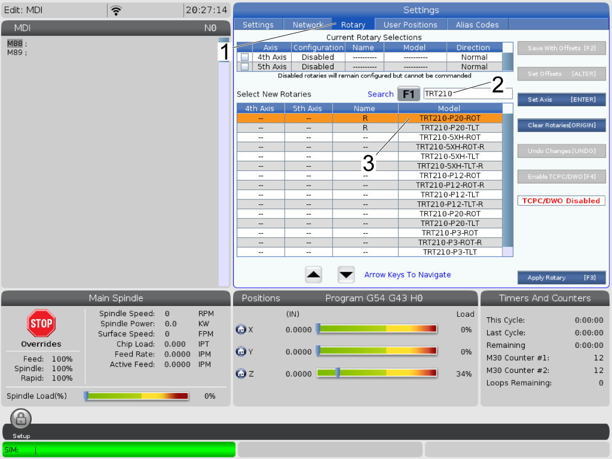

Press [SETTING].
Navigate to the Rotary tab [1].
Type the model of your rotary and press [F1] to search. This example uses TRT210-P20 [2]. Reverse rotary files have the letter “R” in the Name column. Normal rotary files will be blank in the Name column.
Your reverse rotary file [3] is in the Select New Rotaries page.
Highlight the rotary files you want to activate and press [ENTER] to pull up the Select Table Orientation screen.

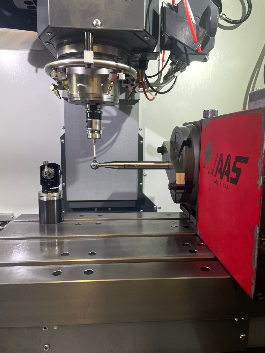

This procedure requires that the spindle probe be calibrated and that the rotary be square to the machine's movement. Verify both of these before continuing.
Warning: The face of the rotary needs to be square to the machine motion within 0.002 inch (0.05 mm). An alarm will be generated if the rotary is not square within this tolerance.
The steps to calibrate a probe can be found at Wireless Probing How-To PART 1 - Calibrating the System.
If necessary assemble the calibration tool and mount it to the rotary.
Mag base: The pervious MRZP tool used a mag base to attach to the rotary face. Place it anywhere on the rotary where it will not crash into any thing as it moves around.
T-slots: See the details tab on the product page for information on how to configure the MRZP tool. Bolt down the MRZP tool using the T bolts. The tool does not need to be centered.
IMPORTANT: Make sure the gauge ball will stay within the XYZ travel limits when attempting to run the probing cycle at different angles in rotation.
Press [Offset] then navigate to the Work tab and set G154 P80, P81 & P82 to zero in all axis. These will be used to store data collected during the test.
Also check that setting 254 and macro variable 10800 is set to zero.
Press settings then type 254 and press [F1] to search for the setting. Set it to zero.
Press [Current Commands] and open the Macro Vars tab. Navigate to the right to the (Global) 10800 - 10999 section. Highlight the Var 10800 and set its value to zero.
Place the spindle probe in the spindle.
The spindle probe must be calibrated before the probing cycle is started. If it has not been calibrated do so before continuing.

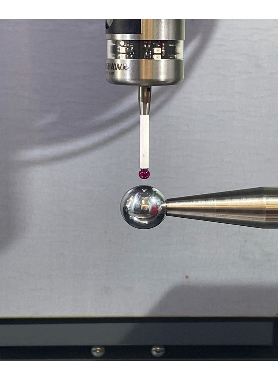

Position the spindle probe over the gauge ball. The probe stylus must be positioned near centerline of the calibration ball, and about 1/4 inch (6.35 mm) above the top surface.
Important: It is important that the be as close to 1/4 inch above the part as possible. If it is too low it may hit the stem and generate alarm 1092 (UNEXPECTED SUREFACE FOUND). If the probe is to high that will reduce the accuracy of the of the procedure.
If the probe is too far off center in the ball or is too low or too high you will get the alarm 1092 (UNEXPECTED SUREFACE FOUND). Clear the alarm and move the probe closer to the center axis of the ball and to the correct height above the ball.
Tip: Place your thumb and index finger on horizontal axis of the gauge ball. Move your fingers up together to the top of the ball. Once they get to the top and are gently pinching the ruby tip of the probe. You should be able to feel if the ruby tip is centered.
Warning: Do not pinch the probe too hard as this can damage the probe. Additionally, the probe should not move while it is being handled as this can also damage the probe.

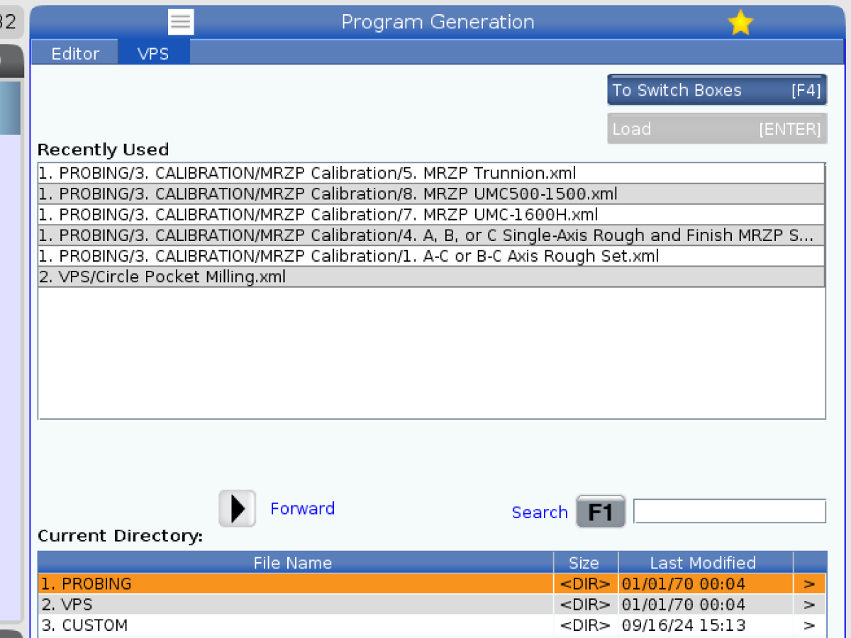

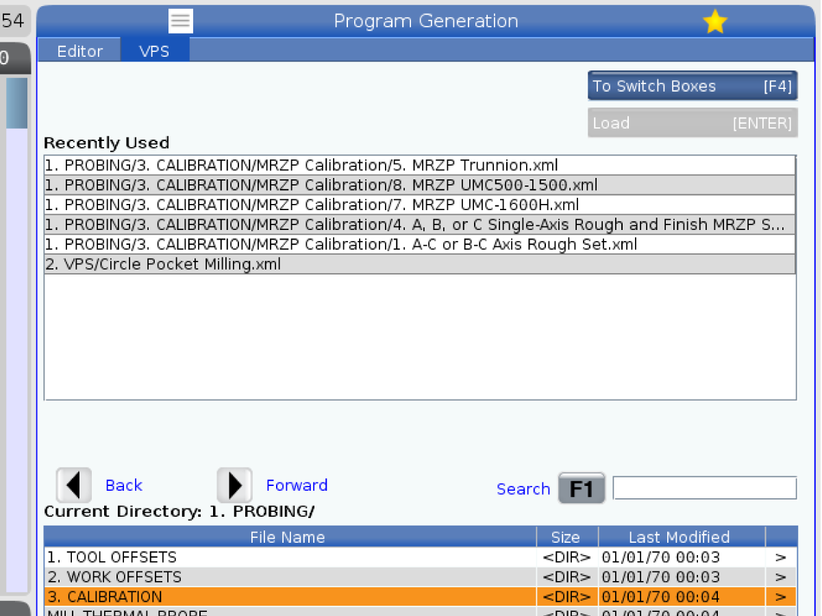

Press [EDIT] then navigate to the VPS tab.
Then highlight PROBING directory and press right arrow.
7

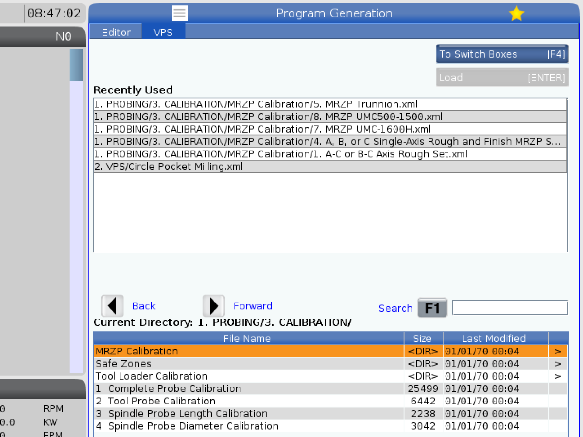

Highlight the CALIBRATION directory and press the right arrow button.
8
Highlight the MRZP Calibration directory and then press the right arrow button.
9
Highlight A, B, or C Single Axis Rough and Finish MRZP Set directory and press [ENTER].

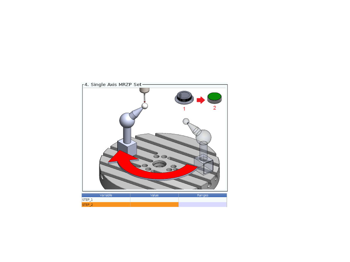

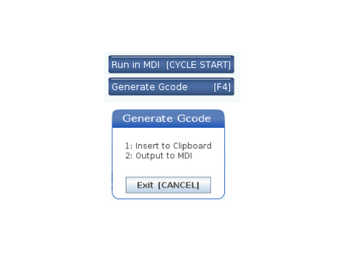

Highlight the operation Step_1.
On the top right hand corner of the screen you will see your next options.

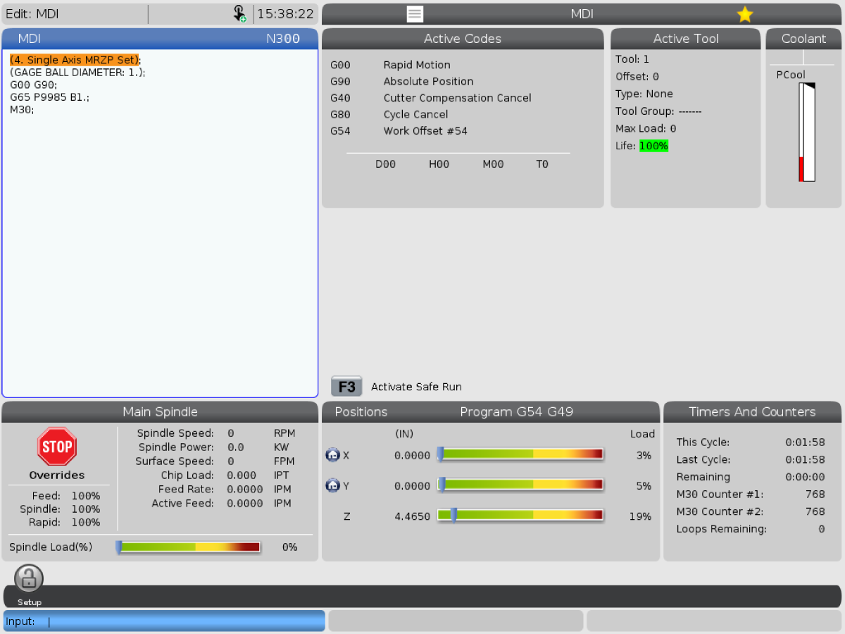

If you press [CYCLE START] the program will automatically be output into MDI and the program will begin its first cycle. If you choose [F4] the following choices will pop up. Once you have made your output decision run the program.
12
When the first cycle is complete the screen will revert back to what was output into MDI and repeatedly beep. Press [ENTER] to stop the beeping.
13
Use handle jog to move the probe out of the way then rotate the axis. It does not matter how much the axis is move, however it is recommended to turn the rotary at about a third the max travel range or a third of a rotation. Once the rotary is in its new orientation jog probe over the gauge ball.

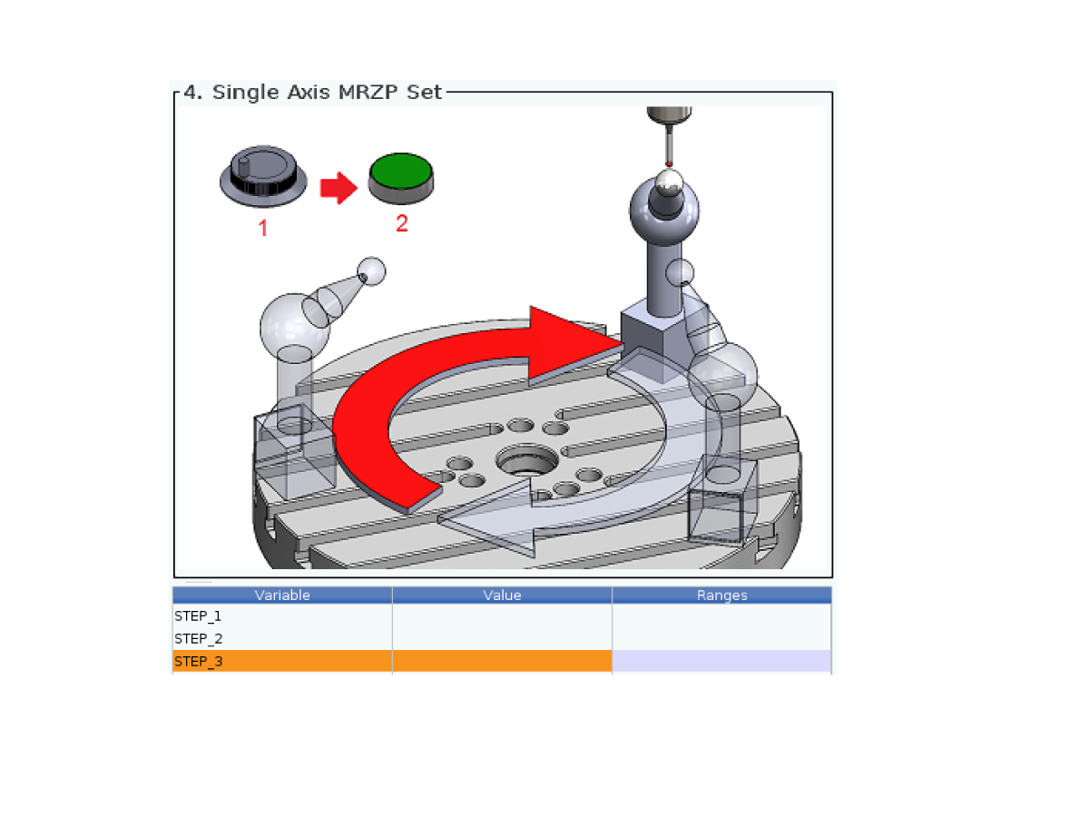

14
Once the probe is in place press [EDIT]. This should direct to the VPS menu you were previously in. If so then run Step_3. If not then follow steps 5 through 8 to get back to the MRZP calibration menu and run Step_3.
Once the final cycle is complete the screen will revert back to what was output into MDI and repeatedly beep. Press [ENTER] to stop the beeping.
