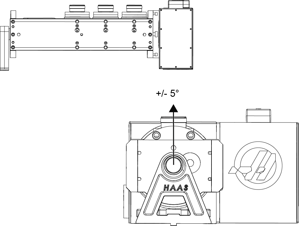

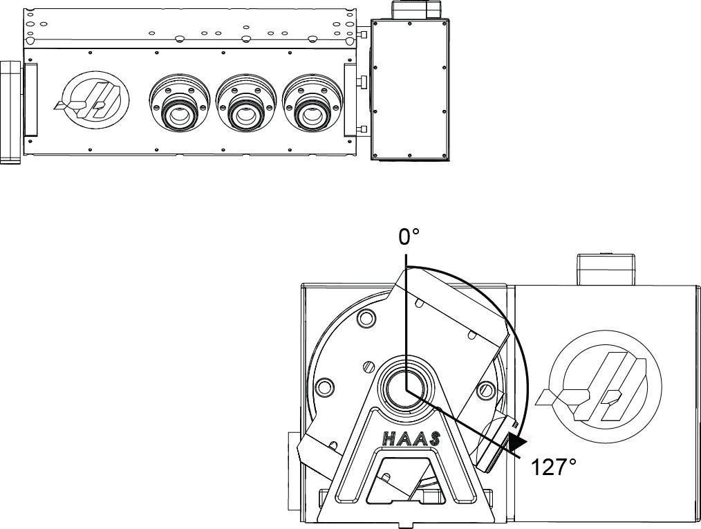

Strip Magnet on Tilting Axis
All tilting tables built after November 2002 or with serial number 900628AB or higher have the strip magnet installed on the tilting axis.
A tilting table with a strip magnet finds the home position approximately +/- 5 degrees from the platter horizontal position.
A tilting table with the button magnet finds the home position approximately 127 degrees from the platter horizontal position.
