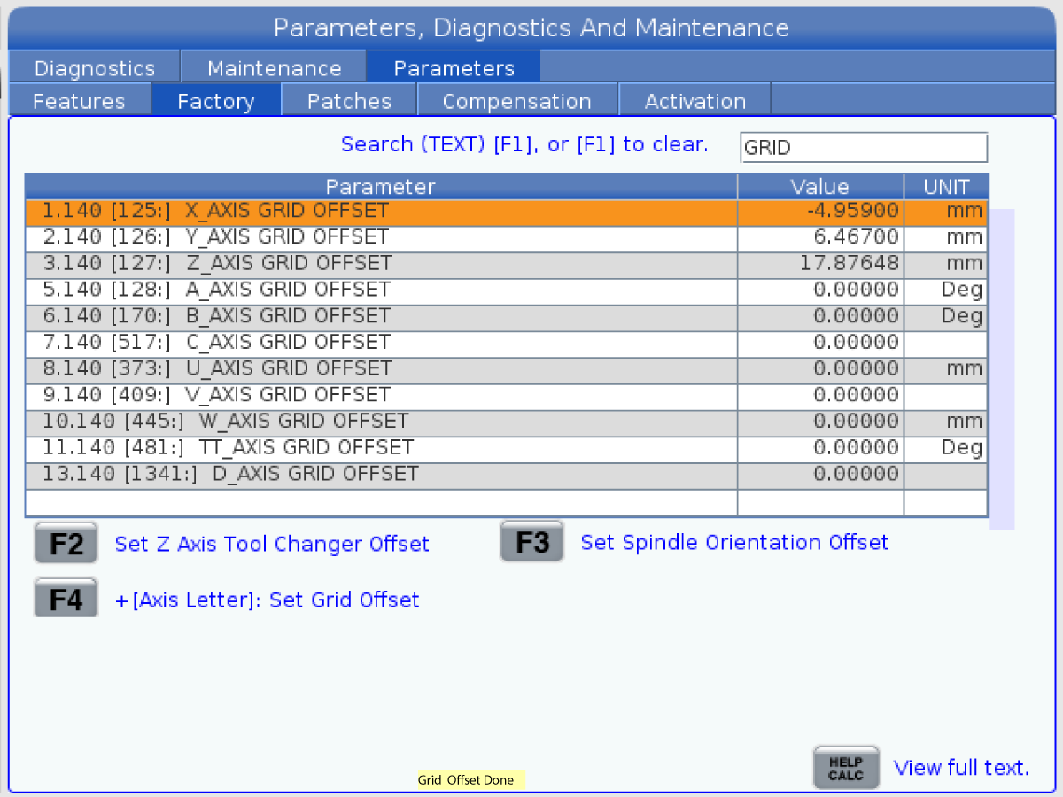

Axis Grid Offset With Service Key
Put the machine in Service mode.
Push [ZERO RETURN].
Push [ALL].
Push [DIAGNOSTIC].
Navigate to the Parameters tab.
Navigate to the Factory tab.
Type GRID and then press F1.
  • This shows all parameters that have the word "GRID" in the parameter name.
Type the axis letter you are setting (for example, 'X'), and then press F4 to set the grid offset for X.
If you need to set other grid offsets, repeat Step 1 but enter the corresponding axis letter.
This changes the Grid Offset parameters. For example, the letters X, Y, and Z set these Parameters:
  • 1.140 X_AXIS GRID OFFSET
  • 2.140 Y_AXIS GRID OFFSET
  • 3.140 Z_AXIS GRID OFFSET
  • 5.140 A_AXIS GRID OFFSET
  • 6.140 B_AXIS GRID OFFSET
  • 7.140 C_AXIS GRID OFFSET
