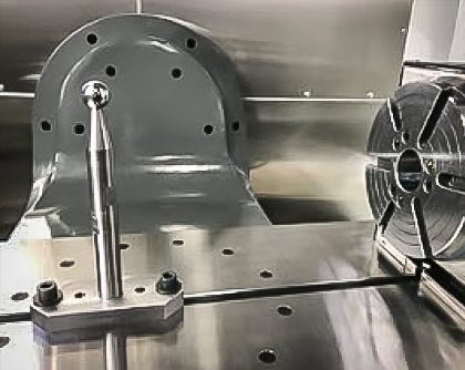

This rotary-axis calibration tool simplifies the process of setting your machine’s rotary zero point (MRZP) offsets, which are used by the Dynamic Work Offsets/Tool Center Point Control (DWO/TCPC) option to make 4- and 5-axis setup and calibration easier. MRZP is a set of control parameters that define the centers of rotation for the rotary axes relative to the home positions of the linear axes. Note: The taper of the master gauge-length tool will match the taper of the machine for which the option is ordered.
  • Includes a precision calibration ball, master gauge-length tool, all necessary hardware, and a heavy-duty case
  • Allows recalibration of the rotary zero point offsets to compensate for environmental factors, or a machine crash
  • Improves the overall positioning accuracy of the rotary axes
  • Included with DWO/TCPC

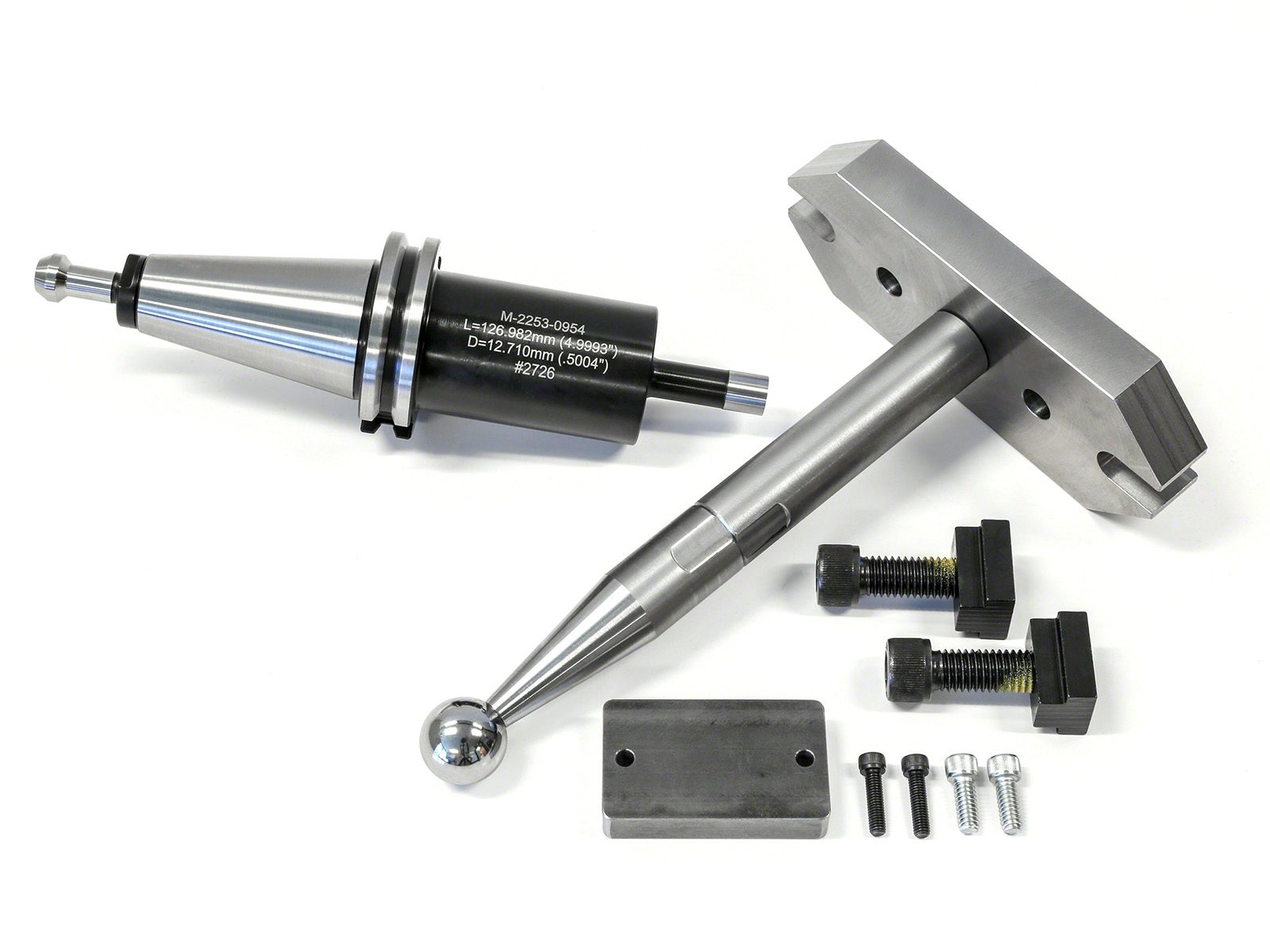

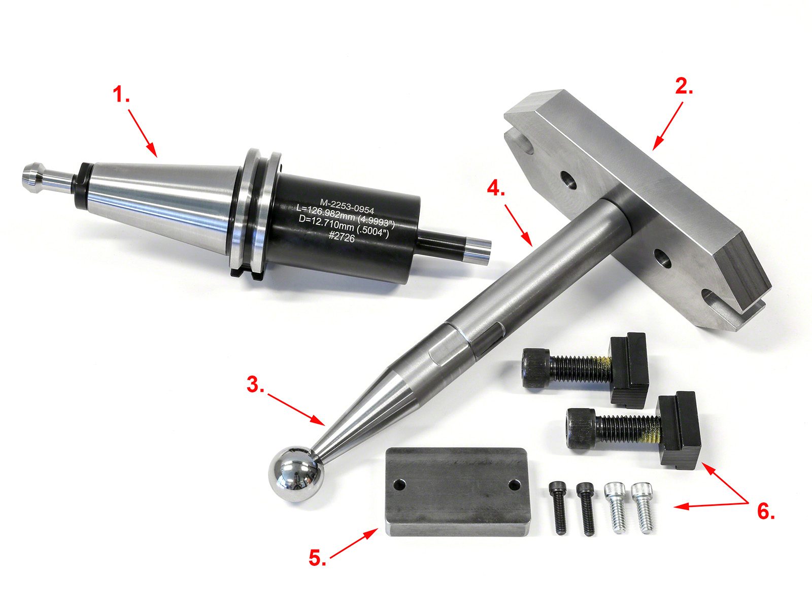

What’s Included

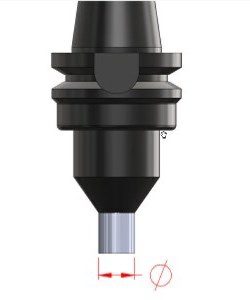

The probe system must be accurately calibrated to achieve the best results. This kit includes a precision-ground and -measured gauge-length calibration tool for use when calibrating the probe system.

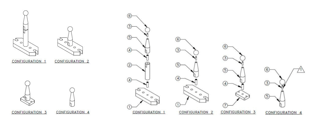

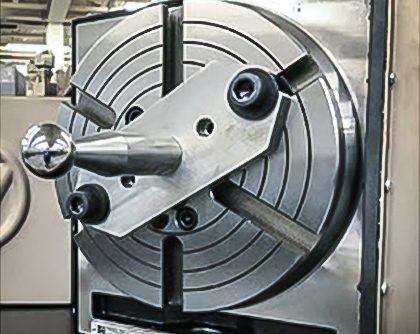

The kit also includes a precision-ground calibration sphere (tooling ball), and all the mounting hardware needed to attach the tooling ball to any Haas rotary product, with the exception of the HRTA5 and HRTA6. For these models, the tooling ball must be held in the workholding attached to the HRTA5 of HRTA6.
  1. Gauge-Length Calibration Tool
  2. Base
  3. Gauge Ball and Stem
  4. Stem Extension
  5. Base for TRT70
  6. Mounting Hardware
Item Number
Part Number Part Description
Quantity
20-6991A
MRZP PROBE MOUNTING PLATE
2 20-7178
MRZP BTM BALL MOUNT SHAFT 1
44-0063
SSS M6 X 20 CUP PT
4 44-0062
SSS 3/8-16 1 1/4 CUP PT 2
6
59-1582A
PROBE BALL MRZP
7
20-7273
PROBE MOUNTING PLATE SMALL

  • Use the gauge-length calibration tool every time you calibrate the probe system.
  • Always use the length and diameter printed on the tool when calibrating the probe system in VPS.
  • Be sure to reset all tool and work offsets after calibrating the probe system. This includes finding and resetting the machine rotary zero point (MRZP) offsets.

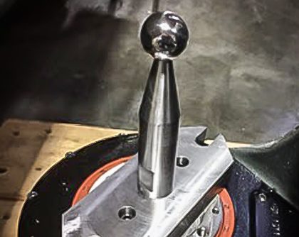

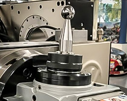

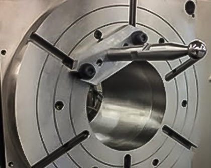

Configurations
* Exploded views for reference only.
Rotary Fit
Configuration 1
  • HRT450
  • HRT600
Configuration 1 or 2
  • HRT310
  • HRT310SP
  • TR310
  • EC-1600ZT-5AX (A-Axis)
  • VF-6TR
Configuration 2
  • HRT160
  • HRT160SP
  • HRT160SS
  • HRT160-2
  • HRT160
  • TR160
  • TR160-2
  • TR160Y
  • VF-2TR
Configuration 2
  • HRT210
  • HRT210SP
  • HRT210M
  • HRT210-2
  • HRC210
  • HRTA6
  • TRT210
  • TR210
  • TR200Y
  • UMC-750P (A-Axis)
  • VF-5TR
Configuration1
  • UMC-750P (B-Axis)
Configuration 2
  • TRT100
Configuration 2
  • UMC-750/SS
  • UMC-1000/SS
Configuration 3
  • TRT70
Configuration 4
  • T5C
  • T5C-2
  • T5C-3
  • T5C-4
  • HA5C
  • HA5C-2
  • HA5C-3
  • HA5C-4
  • HA2TS
  • HA5CS
  • HA5C-T
  • HRTA5

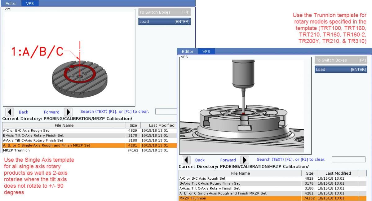

Recommended VPS Templates
  1. Use the Rough Set template to find the center of the C axis on UMCs when no values exist in Settings 255, 256, and 257.
  2. Use the Finish Set template to find the center of the C axis on UMCs when values do exist in Settings 255, 256, and 257.
  1. Use the Single Axis template for all single-axis rotary products, as well as 2-axis rotaries where the tilt axis does not rotate to ±90 degrees.
  2. Use the Trunnion template for rotary models specified in the template (TRT70, TRT100, TRT160, TRT210, TR160, TR160-2, TR200Y, TR210, and TR310.
