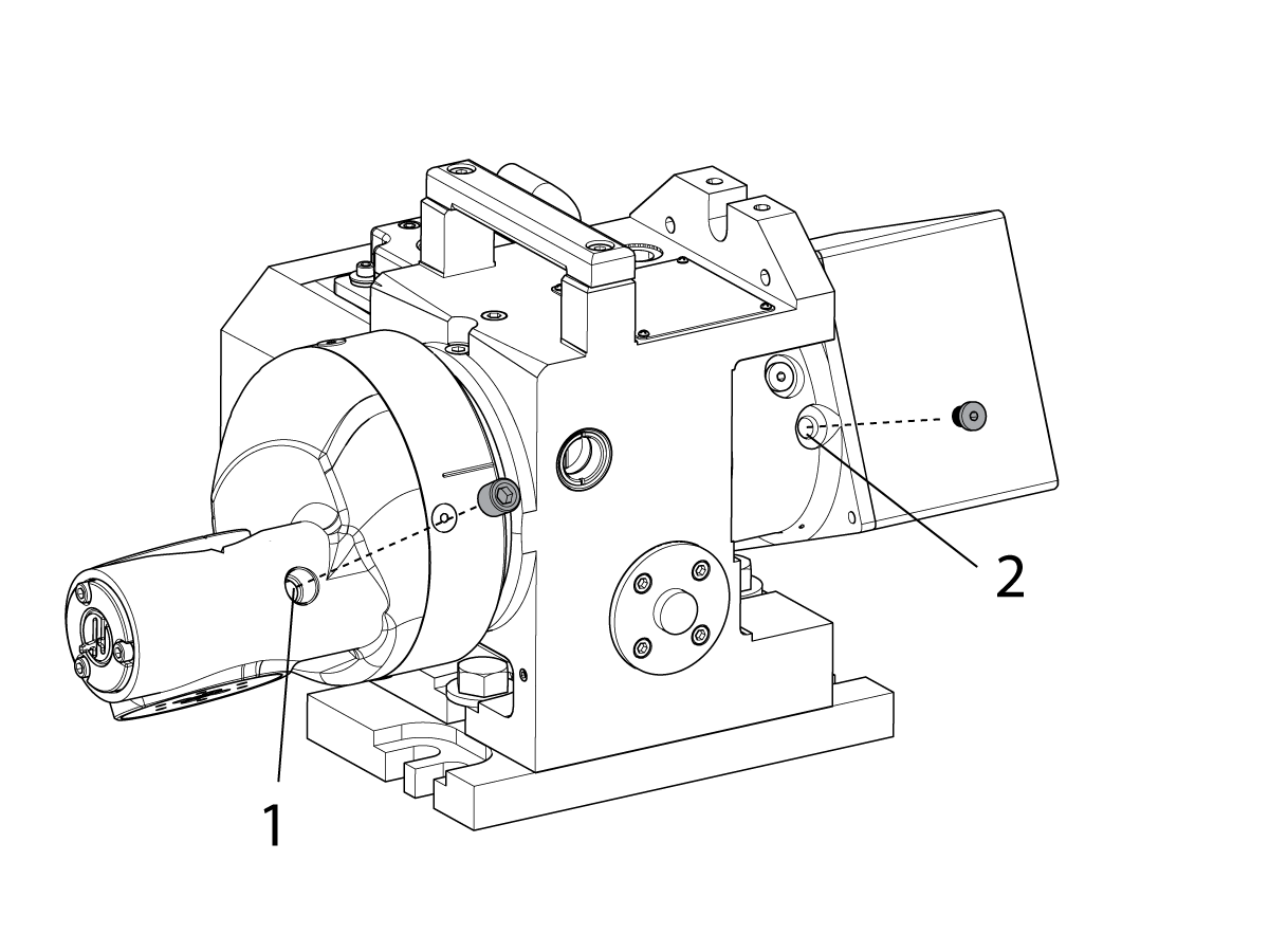

Remove the fill plug [1] and the drain plug [2] to drain the oil from the unit.

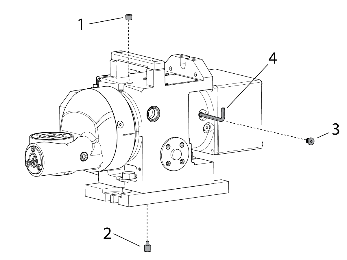

Remove the coupling access port [3] and use a 1.5mm hex [4] to loosen the motor coupler. You may need to handle jog the rotary to get the coupler screw into alignment with the hole.

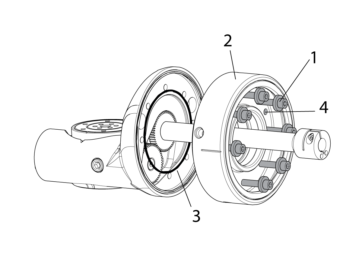

Remove the (7) 1/4-20 bolts [1].
Separate the adapter [2] from the 5th axis and remove the inner O-ring [3].
Note: The 5th axis is a tight fit to the adapter. If stuck you can use the 1/4-20 jack bolt hole [4] if equipped or thread the adapter back onto the HA5C and lightly tap the 5th axis with a mallet to separate the two pieces. Do not let the transmission shaft fall or come out.

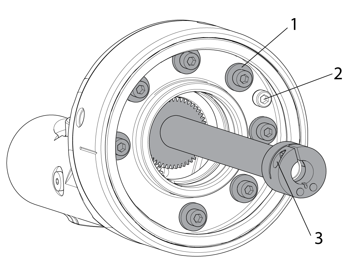

Install the adapter and torque the bolts [1] to 12 ft-lbs.
If equipped with the jack screw hole install the 1/4-20 plug bolt [2] and copper sealing washer, 40-1631 & 49-4101.
Make sure the transmission shaft did not rotate so the coupler [3] is still aligned with the access port.

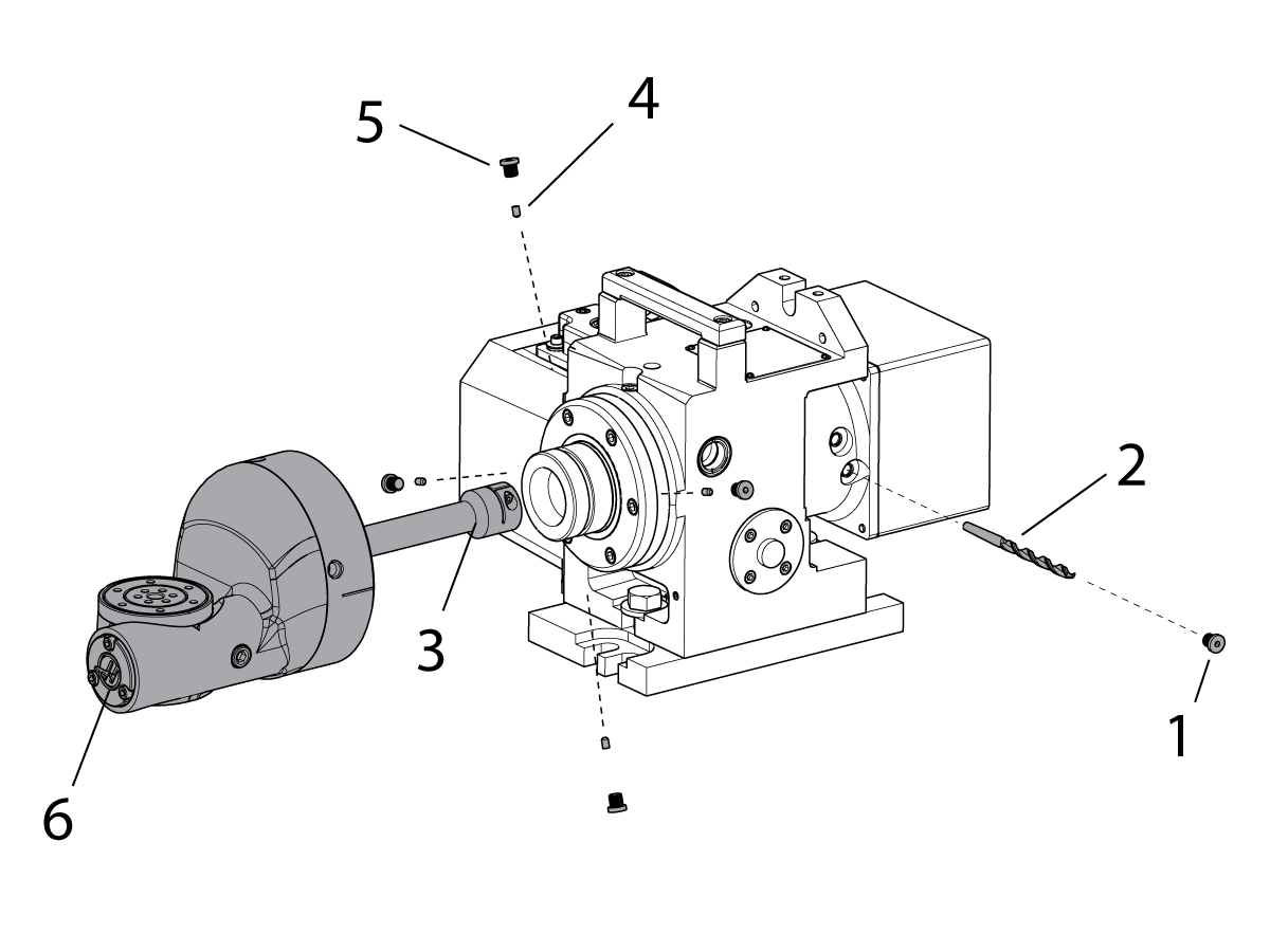

Remove the cross pin access cover [1]. Insert a 3/16 cross pin, or 3/16 drill bit [2], into the hole. It will sit just under the motor shaft and will push against the coupler to set the preload of the transmission shaft.
Thread the 5th axis assembly onto the HA5C nose. Use care to get the transmission shaft [3] piloted back onto the motor shaft.
Tighten the (4) set screws [4] on the adapter. Install the (4) access cover plugs [5].
Tighten the motor coupling bolt and install the access cover.
Note: If the motor coupler is no longer aligned you can remove the front cap [6] and rotate the worm gear to correct the alignment.
Remove the cross pin, or drill bit. Leave the access plug out to refill with oil.
