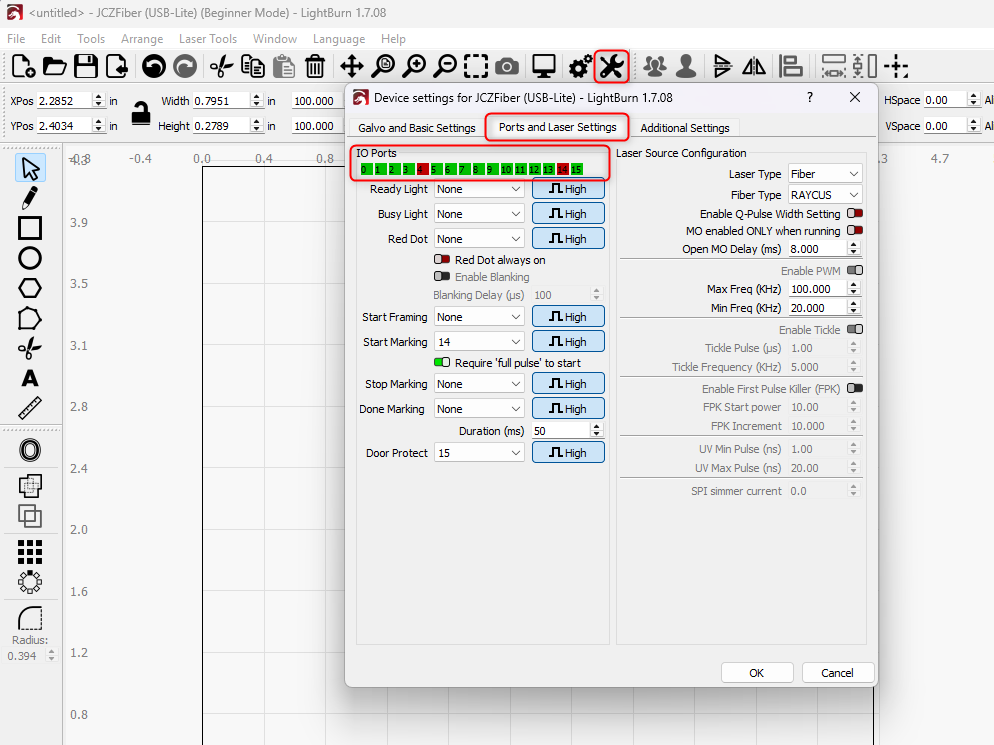

Door Safety Sensor Switch - Laser Not Marking
Updated
In LightBurn, access the Device Settings panel by selecting the Wrench icon. Navigate to the Ports and Laser Settings section, then locate the I/O Ports list.
Ensure the laser system is powered on but not actively marking. Open and close the machine door while observing Port 15 in the I/O display. Verify whether the port state changes when the door is actuated.
If Port 15 does not change state during this test, proceed to the next troubleshooting step.
