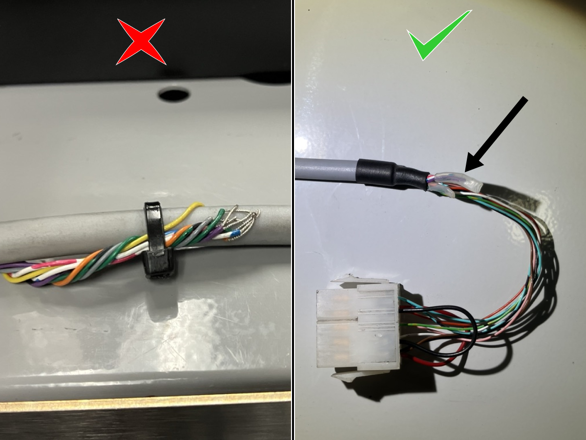

Probe getting stuck in the activation program. Unused wires are shorting to one another. See Unused Wire Section below.
Loose pins in the molex connector. Verify pins are fully seated in the molex connector.
EC-400 Automatic Probe Arm Cable
An example of a mis-pinned connector is shown on the left, the cable that connects to cable 32-0763 had a pin in the wrong location.
Re-pin the wire to the correct location indicated in the image.
If the probe up input flickers between 1 and 0 add ferrite filters to reduce noise.

Unused Wire
All unused wires from the RMI-QE need to be separated and insulated from each other.
Any exposed wires need to be cut back flush to the insultation. Use heat shrink or electrical tape to secure and insulate them from each other.
